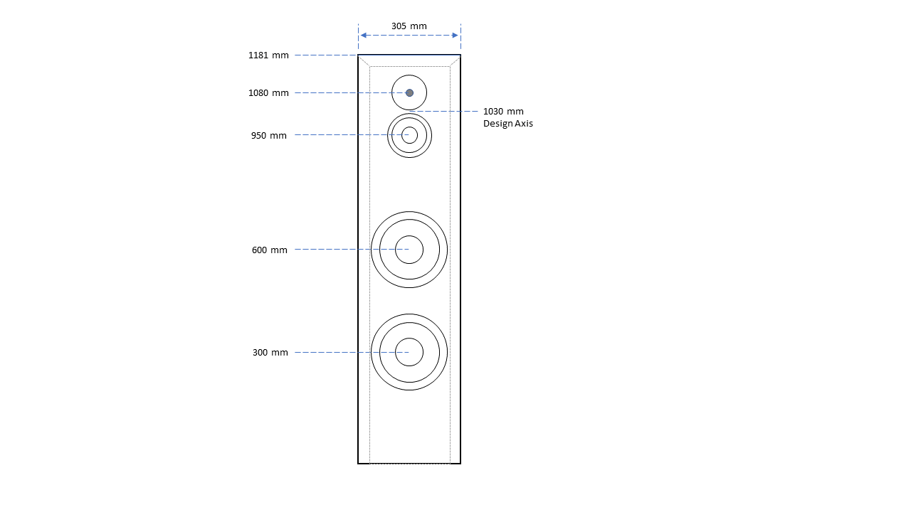

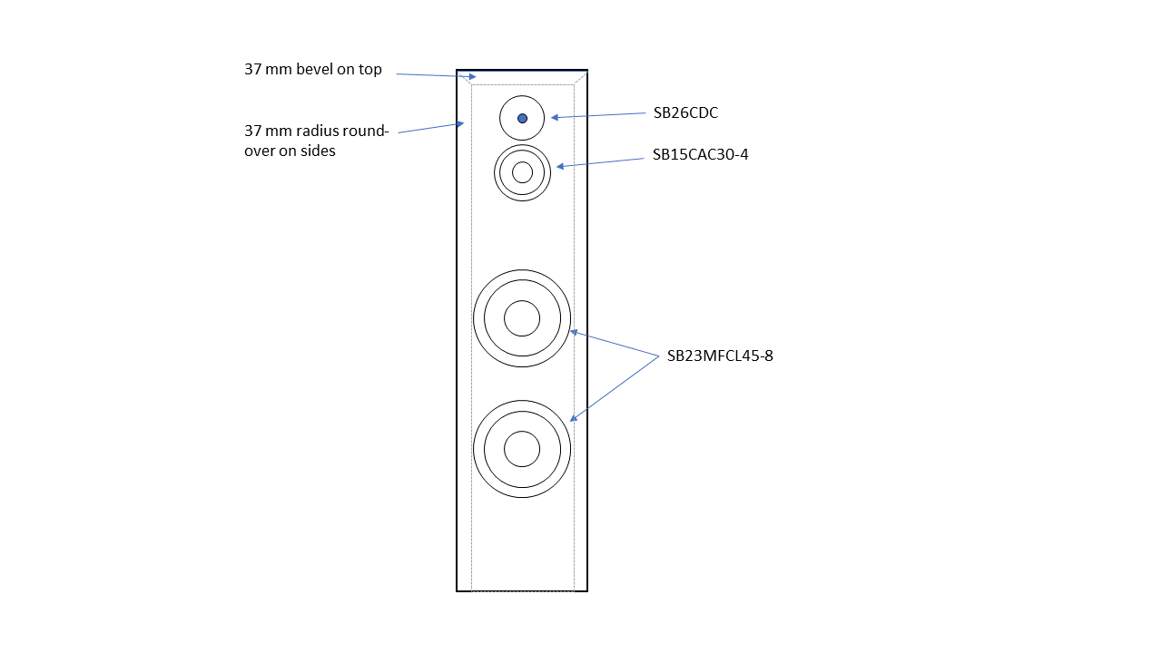

New Project - tower 3-way with twin 8s
Here is the conceptual layout for this project. This layout corresponds to the simulations in post #11. I tried a lot of baffle simulations over the past couple of weeks, but I did not like any of them as much as that early one in post 11.
j.

Build plan is pretty similar to mine in progress. 3 Way w/SB Acoustics Ceramics (woofer choice?)
I could share my waveguide STL's with you if you are interested. Would end up being an extra $55 each speaker with MJF nylon printing and hardware.
Yes I have been following your thread, also vineethkumar01's thread. How do you like working with the shredded denim insulation? Augerpro is a fan of that stuff, and I may use it on this project.
Thanks for the offer on the waveguide. I am doing this project with a flat baffle. I was able to get a good sound power response and good listening window response (by simulation) without the need for a waveguide.
j.
With the world moving to 4” “subwoofers”; twin 8” per speaker are great!
yep...
Funny thing is that even as capable as these 8" drivers are, with their low distortion and 11mm Xmax, two of them are not as capable as a single SB34RNX 12" driver. Volume displacement capability of the two 8's is about 20% less than the single 12.
j.
