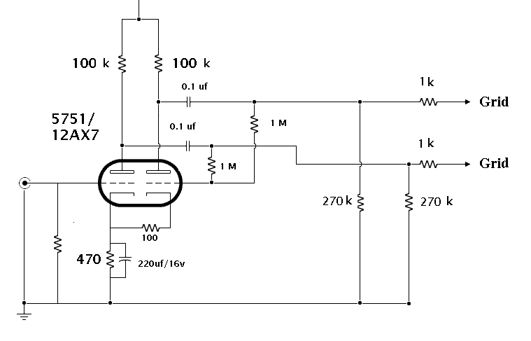

Poinz,
Fairly recently, SY posted in a thread about his experiments using (sic) dissimilar triodes in a CCSed LTP. Even then, symmetry was forced.
Think of the CCS as the fulcrum of a seesaw. If the current in 1 leg goes up, the current in the other leg must go down.
Miles, I have seen it said here that with a CCS in the tail, the stage will be balanced no matter the chars of the devices. This seems contraintuitive to me. What if the intrinsic gains of the tubes are a little different? What if the native operating points of the tubes are a little different? The CCS is common; it doesn't force OP balance. Am I being obtuse? It seems to me that when I first used the IXYS part, I looked at the gain of the two sides of the diff-amp, and they were just a little different, and I switched tubes to get the grid-driven side a little more A, which gives my circuit the correct overall output second partial distortion that is psychoacoustically correct. Am I disremembering? Was I kidding myself
It may seem counter intuitive, but the fact is that all tubes (and transistors) are "a little different". Even when using dual triodes (or transistor arrays where they're all on the same die) there will be some deviations from perfection.
However, I have found that the major difference is in DC offset. This becomes a major PITA when it comes to solid state designs that are DC coupled from input to output. Since my hollow state designs include one capacitor coupling, DC offset is NBD and not worth worrying about. Measured DC voltages have always come in under less than a 5% deviation from design nominal, and AC performance likewise. With the 6SL7 LTP, I calculated a gain of 25 / phase, and that is exactly what I measured: Av= 25 / phase.
When it comes to AC characteristics, every LTP splitter I did (one using Sovtek 6SL7s, the other cascoded 6BQ7As) showed no measurable difference in gain between phases, a CMRR of 60db(v) or better (can't measure it to any more accuracy) and immeasurably low distortion. Unless one half of the LTP is completely borked, I haven't found this to be a problem, either with hollow state or solid state.
Even if you start out with perfectly matched tubes, they are highly unlikely to stay that way due to aging.
Thank you, Miles. The element that I found odd is the symmetry with unlike devices, but Eli has explained it very elegantly; if the fulcrum is immovable, a decrease in current in the directly driven side must be be exactly balanced by an increase in current in the indirectly driven side. Q E D.
The penny drops in me tiny brain. Thank you, gentlemen.

I started it with the Musical Machine, but nowadays I'm using a floating paraphase splitter stolen from a Leben integrated PP amp.
I agree with Poindexter, the 5965 triodes are rarely matched, but it is a good sounding tube. The LTP splitter needs another tube I guess, Poinz changed the tube, I kept the tube and changed the phase splitter.🙂
Power supply and the output stage remain the same.
Do you have a circuit for Leben amp ? I heard audio note kit 4 (6V6) with paraphase splitter and it was really nice sounding little critter🙂
No I don't, I just copied the phase splitter. The Leben has an ultralinear output stage with a Gnfb loop, mine is triode wired and no Gnfb. Anyway, nothing special about the Leben schematic except the phase splitter.
Who knows why I don't like the LTP. It sounded too much hifi I guess, some music sounded impressive but most of the time it bored me. If an amp doesn't get me high it's no good, no matter how accurate it is.
Audio Note says something about the euphonic nature of their amp too. Whatever, the floating paraphase splitter is rarely used, Morgan Jones says it has too much distortion but the amp sounds pretty clean to me. It is definitively cleaner sounding than my 2A3/45 amp. To me it sounds very much like a good SET but with better bandwidth, better bass and, as i said before, cleaner sounding. It's not as human as the SET, though.
This is my phase splitter, it's like the Leben but with no feedback loop:
