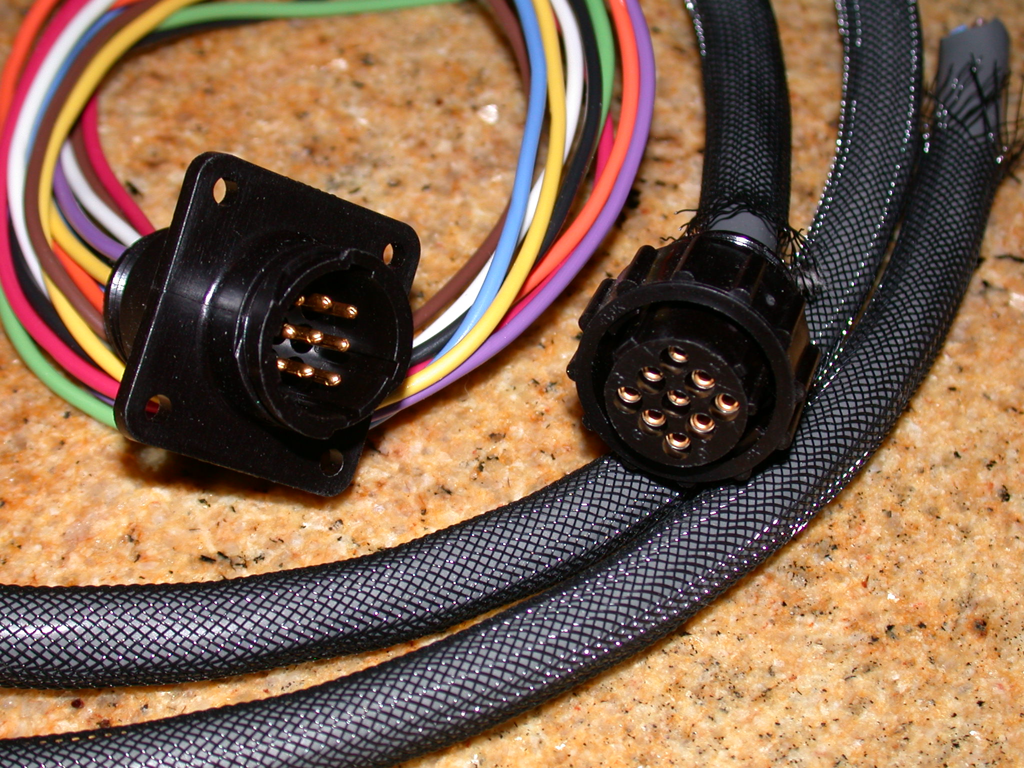

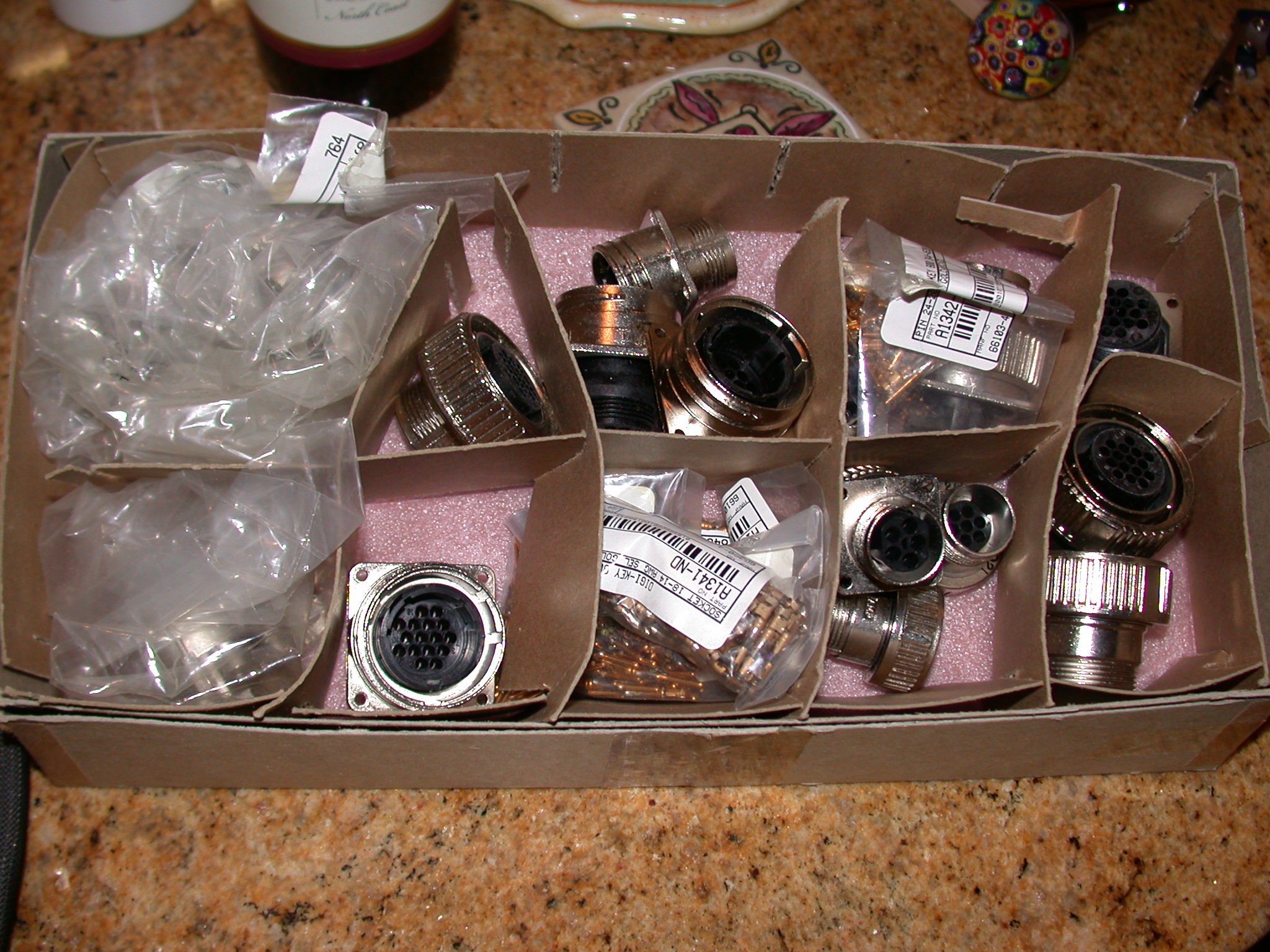

As far as umbilicals go, I've built a 9 pin AMP circular plastic (CPC) connector cable with some 9 conductor Belden cable that looks pretty good. The back shell is missing on the plastic connector in the pic. The CPC series is available from Digikey, etc in many pin and shell arragements. The metal Amphenols are very "industrial" looking and a lot pricier. If you end up going this route, I can crimp the contacts for you if you don't have a crimper.

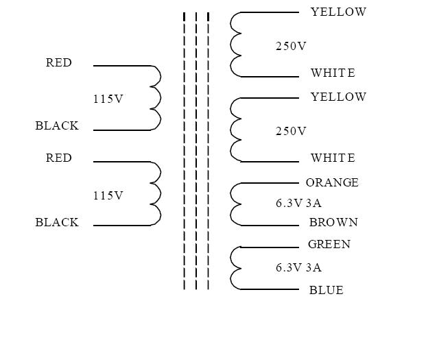

Im real new at this stuff... but I was trying to understand how you get 12.6Vac and 6.3Vac out of this tansformer as shown in your power supply drawing? can you put the two 6.3 outs in series (orgn-brwn+green-blu) and still pull 6.3 off of one set (grn-blu)?

You need a crimper to crimp the pins on the circular connectors. they are crimp instead of solder. We have several at work for different series/brands of connectors. Crimpers for these connectors can get very expensive ($300-$400+ each)

Flap, the Antek transformer has four secondaries:
Two 250V that can be connected in series (for fullwave rectification) or parallel (for bridge etc.)
One 6.3v
One 12.6V
It's a very usefully designed transformer.

Be carefull about some AnTek Models, as they have been revised. A model I was interested in switched from a 12.6 and a 6.3 VAC winding to 2X 6.3 VAC windings. Double check the latest spec's for a model of interest by linking from AnTek's grid.

I guess that why i was confused because currently that is what antek shows for the AN-1T250, no 12.3

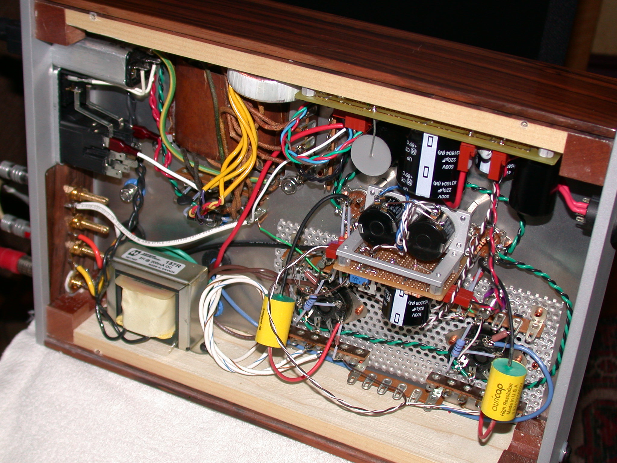

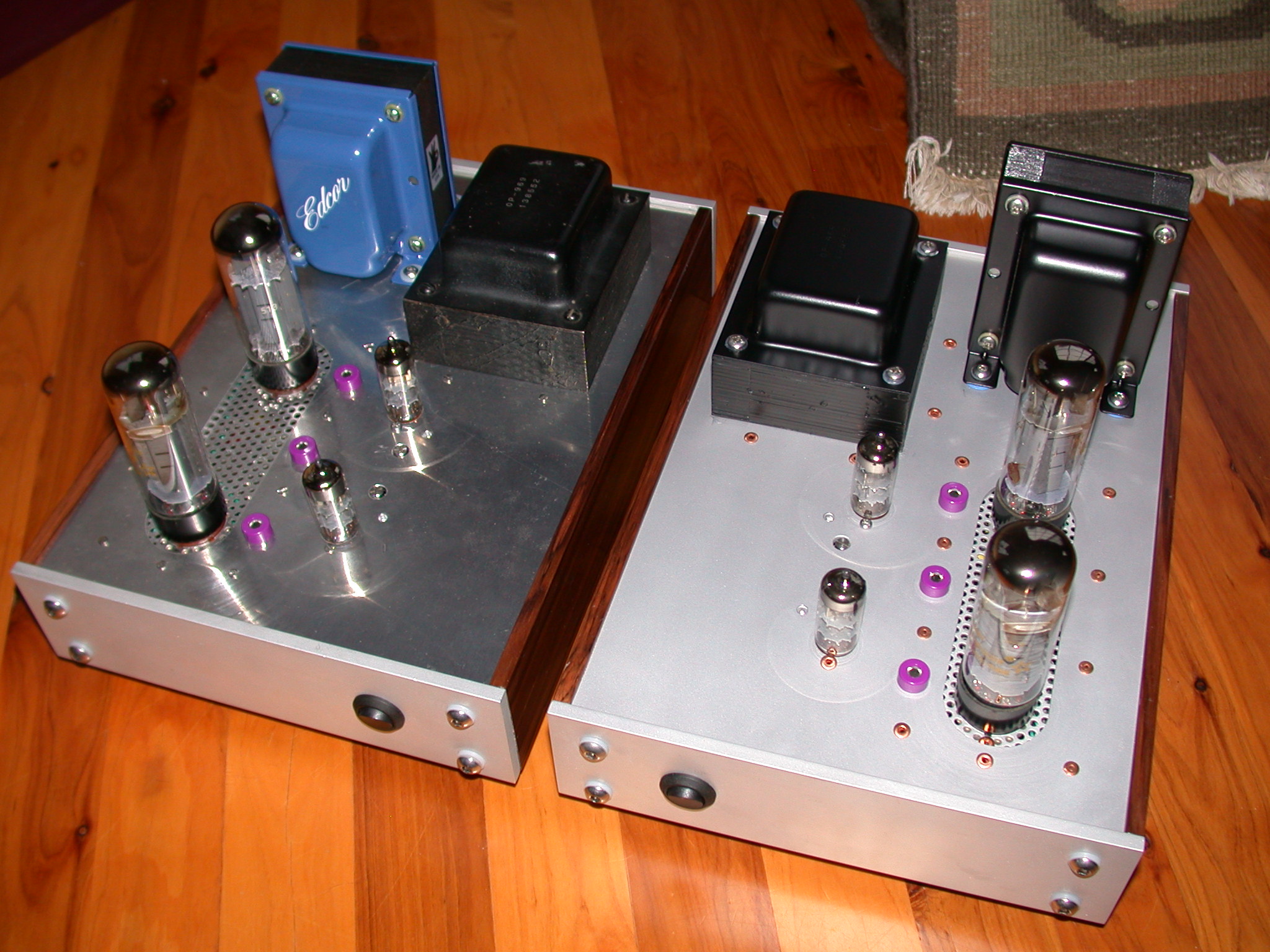

Here are some pics. They are not completed yet, but close. The one on the left needs it's Edcor blacked out and the top deck needs bead blasting, not to mention some housekeeping underneath. As of late last nite I'm running the EL34's at 400V/60 ma and they sound great.
Those monos look great!

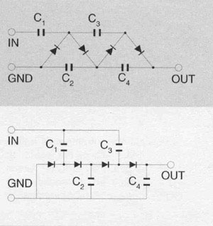

I was already rectifying the 12. 6V winding with a doubler, for the bias supply. I may try a quadrupler, to see if it works okay; I had not wanted to do this, because the doubler is full-wave, and only will take half the value of filter components to get the ripple down to the same value as the half-wave quadrupler. We'll see.

I think you will do fine using the 2nd schematic in the graphic, "ripped" from Voltage Multiplier Inc., I've uploaded. A bias rail has to provide only a few clean mA. The half-wave parallel topology puts equal strain on the diodes, but the voltage rating of the caps. has to increase with each successive stage.

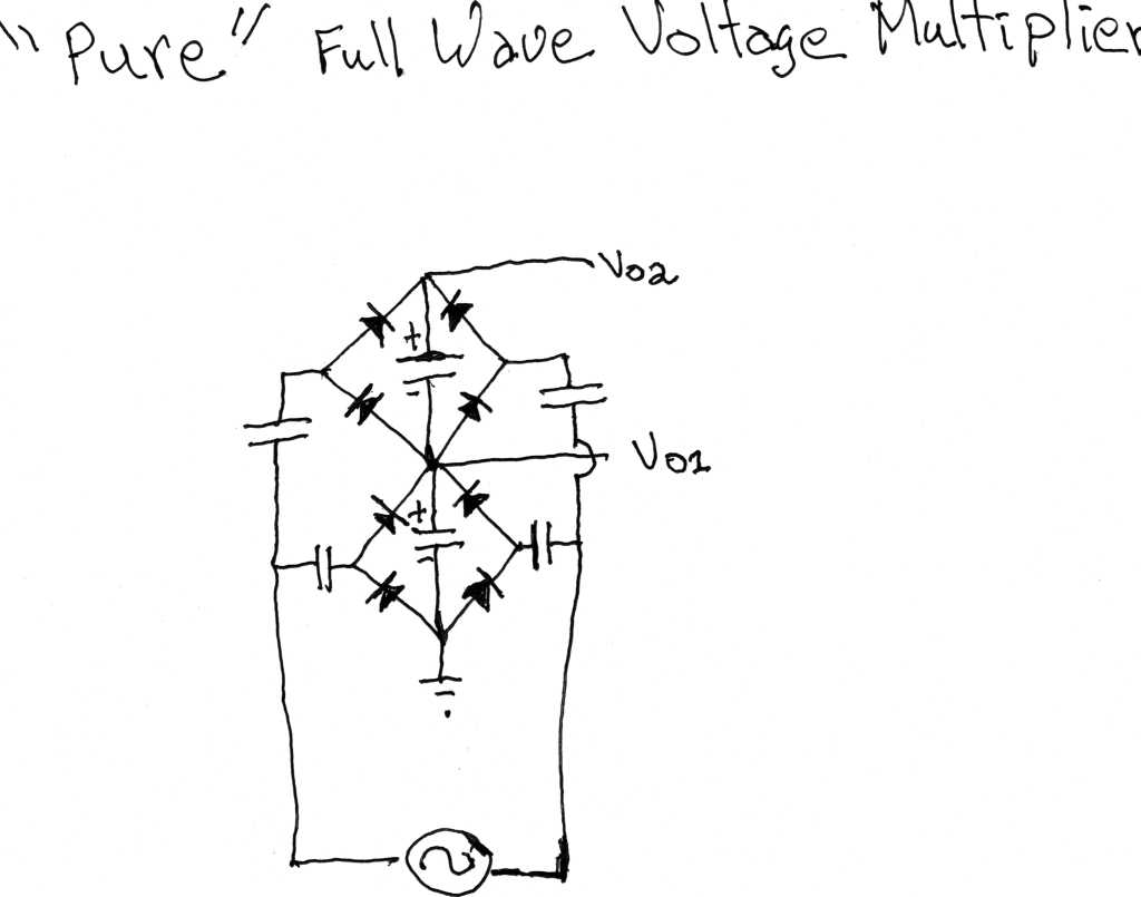

Eli, those are the same schematic electrically, just rearranged graphically. Yes, that's what I'm looking at, but smoothing 60Hz ripple is twice the PITA as 120Hz ripple. I hate it, but what's to be done?

I don't think a new solution is necessary. Since I don't know a fullwave quadrupler circuit, I think I'll just pull off the existing -66v supply for the tail. The current draw (about 2mA max) won't affect that supply at all, and the net power supply will be simplified.
BTW, you're right, Eli; those quadrupler circuits are not the same. Mea culpa.
