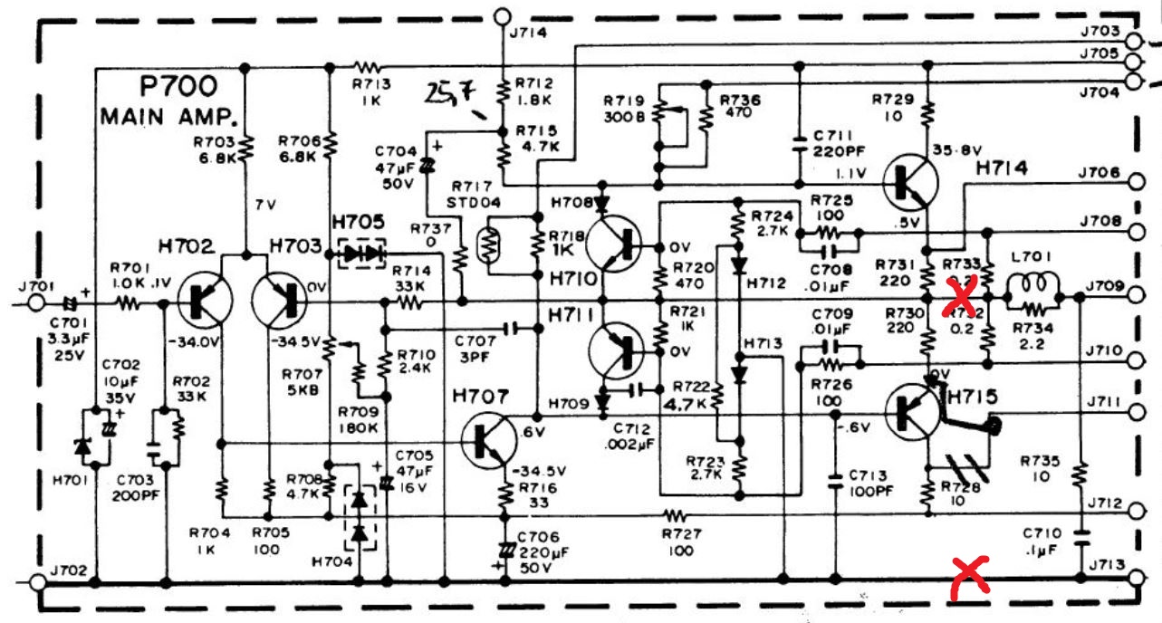

I am sorry Mooly I am a little confused so ground one end to the chassis and the other end to one end of the R732 then the R733??
H701 on the good channel (right)Is 18.4v the H701 on the left channel bounces from. O1 to .07 and the light on the dbt got a little bright
I am thinking to change out that Zener Diode, should be getting 18V not even close, would you agree
That definitely sounds suspect.
Before you replace it though you need to check other possibilities.
1/ You should have the supply voltage on R713. You also need to check this resistor is OK and not high in value or open circuit.
2/ Check C702 isn't leaky or short.
If those are OK and you have voltage on one end of R713 then change the zener. It will be an 18 volt 0.5 watt part.

The R713 was one of the blown resistors when we started this project and i had replaced it, will get back to you
R713 should be 1k in value. Where are you measuring this 11.9 volts ?
Do you mean the supply voltage is only 11.9 volts going into the resistor ?
We need to know three things.
1/ That the resistor is OK and measures 1k out of circuit.
2/ That the full rail voltage is applied to the right hand side (as drawn on the diagram) of the resistor.
3/ The voltage across the zener. This is the same as reading the voltage on the other side of the resistor. It should be 18 volts.
If you have supply voltage going into the resistor and the zener voltage is low then you must change the zener.
Based on what you have said so far the zener is suspect.

I think so too i measured the voltage on the good channel of the Zener and the bad channel there is a difference much more than the 10% you had suggested
Hi Mooly I changed out the zener diode the old one was bad now I am to adjust the trim resistor but that resistor is extremely sensitive I get the voltage to 10mv but then it starts to drop slowly
One step at a time.
Replacing the zener should have brought the 18 volts back. Yes ?
You now need to recheck the DC offset at the output and make sure it is less than 100mv. If it is then the amp should hopefully work.

Hi Mooly, This is what we got the left channel came to life you can hear the station but their is a hum on it, the right channel is ok. I checked the DC offset (from the speaker terminals correct??) if so i have 2.1v on the right side( cannot get it lower on the right) 0v on the left I got 35v on the P800 board
There seems to be a lot of random things going on 🙂
I thought the right channel was OK and had no offset (going back a few days).
Lets concentrate on the left channel.
Did replacing the zener bring the 18 volts back to the correct value ? You haven't answered that 🙂
And still on the left channel only, you are sure the offset is close to zero ?
Also, does the bias adjust pot work OK on the left channel and allow the bias current to be varied ? This is the one we check by measuring the voltage across the 0.2 ohm resistors.
All those three things have to be OK before going further.
Assuming they are OK, Do you hear the hum as the volume control is turned down ?
If the hum reduces with volume, do you get the hum if you use a line level input such as a CD player ?
Remember, this is all for the left channel. Forget the right channel for now.

I am sorry for jumping ahead just got a little excited LOL Tomorrow i will check the voltage of the Zener diode, check the offset on the left side only, the adjustment pot is extremely and i mean extremely sensitive i got the voltage down to 10.0mv but it started to go down after some time( with in 1-2 minutes) can i use Deoxit on that trimmer ?? Still on the DBT when i go to adjust that pot the slightest movement makes the bulb go from dim to bright, that does not seam right does it?? Back to you tomorrow

If the bulb is jumping from dim to bright then that is a possible sign of instability and oscillation.
That is one of the biggest issues when replacing older and slower original transistors with more modern one. You really need an oscilloscope to confirm that is the case.
