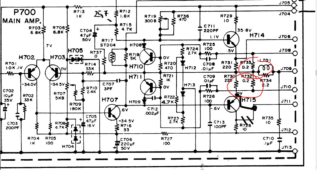

Well I received my parts yesterday, I replaced the R731 which was burnt out and located another burnt resistor R736 and replaced that while i was in there, i changed out capacitors while i was in there, I did fine one not up to spec. I checked the transistors the H702-H703-H710- and H711 checked out fine I did replace the H714 and H715. Put it all back together ran it through my DBT and the relay clicked on, One thing i noticed the light went dim and then came up a little not bright but a little more than dim, do not know if that means anything, so i preceded to check the P800 power supply board and could not get the voltage up to 35v, could that be because i was still on the DBT?? I have not checked the DC offsets yet wanted to take care of the power supply board first. Any feed back would be greatly appreciated

OK here are the readings I got;
Main Amp DC Offset LC= 0v RC=1.87 v
Idle Adjustment;
LC=90.5mv RC=3.1mv
Voltage adjustment at between pin 804/805 =29.9v
I checked the voltage at pin810 to chassis and 809 chassis and got
809=0.3v 810 1.819v

One other thing i noticed i plugged in my headphones just to see what comes out of the unit and to my surprise no sound from the left channel
Left channel.

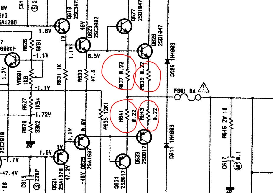

Does the 90mv alter as you turn the bias preset ?
Is the 90mv present across ALL four of the 0.22 ohm emitter resistors or are there massive differences in the voltage between them.
(90mv would equate to a current of 4 amps flowing which can't happen with a bulb tester and so something is amiss somewhere)

So we need to do a decisive couple of measurements now. I can not see on the diagram where these two test points are in relation to the circuit and so I am assuming they are indeed across one of the 0.22 ohm emitter resistors.
Can you check all four voltages across all four emitter resistors and post the result here.
Hi Mooly, please forgive me but I do not have any listing for R641 R637 R643 R639 on my schematic what board or these on??
OK so i need to check the voltage across R732 and then R733 and they should read 90mv on both correct??
No, that would be much to high. You say you have 90mv across the bias test points and the manual says you should have 10mv.
The method in the manual measures across both resistors in series and so that means you should see 5mv across each 0.2 ohm. Yes 🙂
Now, if you measured 90mv then that implies you have a current of 0.090/0.4 which would be 0.225A. Far to much.
So first check the voltage across each of those resistors and see what you get.
