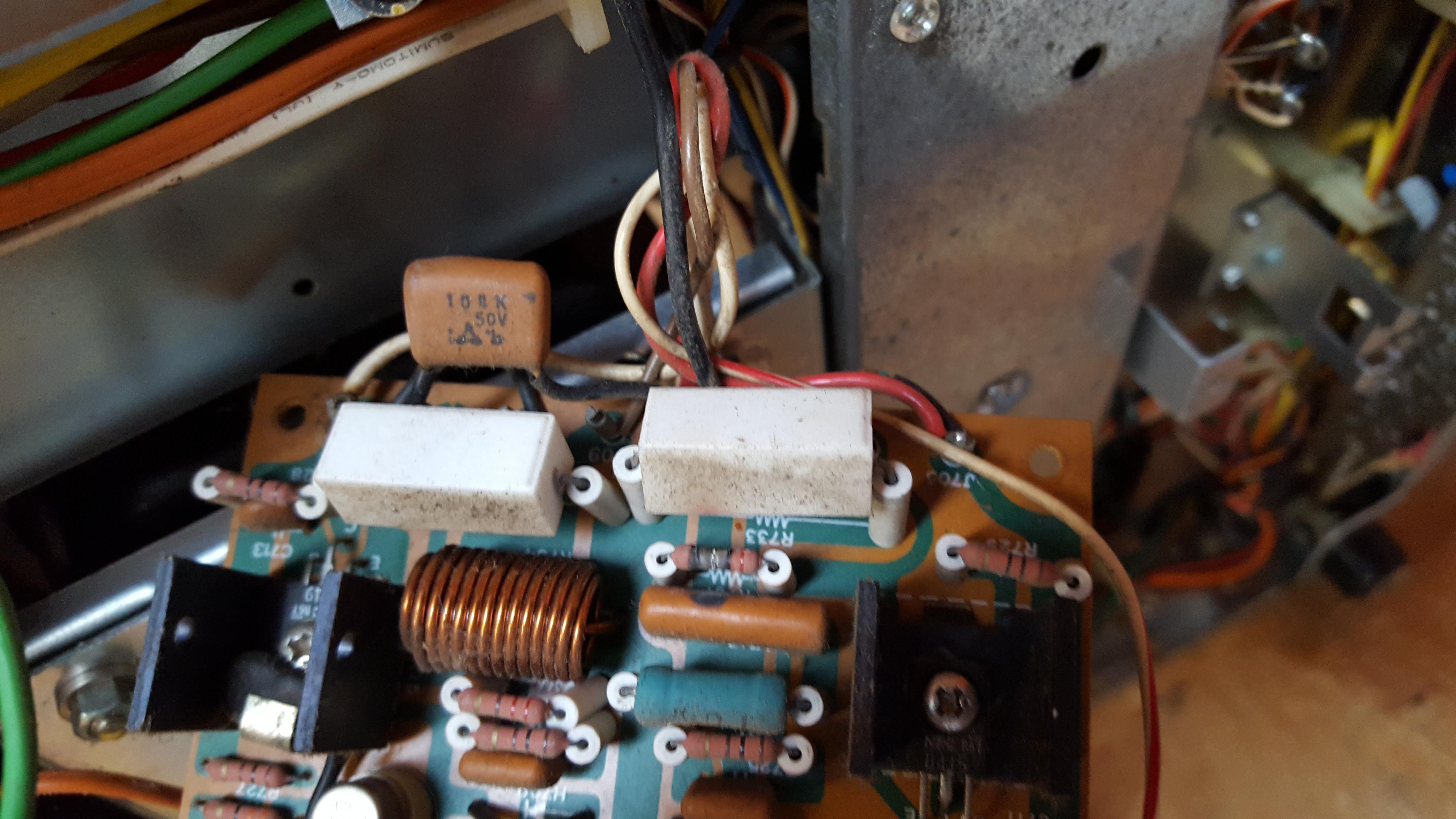

OK I started to go over this unit i knew there was a problem when i got the unit!! The first thing after checking some of the voltages was to test the output transistors (I took them off and tested them) the right channel was ok the left had both transistor showing there were shorted, I changed them out with new transistors and when i put the unit back on the DBT VERY BRIGHT light, I am trying to determine were to start troubleshooting, were do i begin???
I think i was able to isolate the problem to the left channel, I pulled out the 2 new transistors and turn on the unit and the relay clicked on, some people on the site said that the H701 and R713 have given them problems I do not want to guess but knowing that the problem is in that channel what would be my next step???
Think i found the culprit,Burnt out resistor, i need to order some parts so i will get back to all when i get them
R731 is one of the emitter resistors on the driver stage.
The most likely scenario is that the failed output transistor caused the 0.22 ohm emitter resistor to fail open circuit leaving the driver transistor and the 220 ohm to try and deliver all the fault current.
You need to be very very sure these are all OK. If I was repairing this I would look to replacing the drivers and H707 as well using modern parts. The original failure of the output transistor could well be caused by a problem earlier in the amp.
Modern semiconductor replacements mean that the circuit may need tweaking to remain stable against oscillation and instability and also thermally stable.
