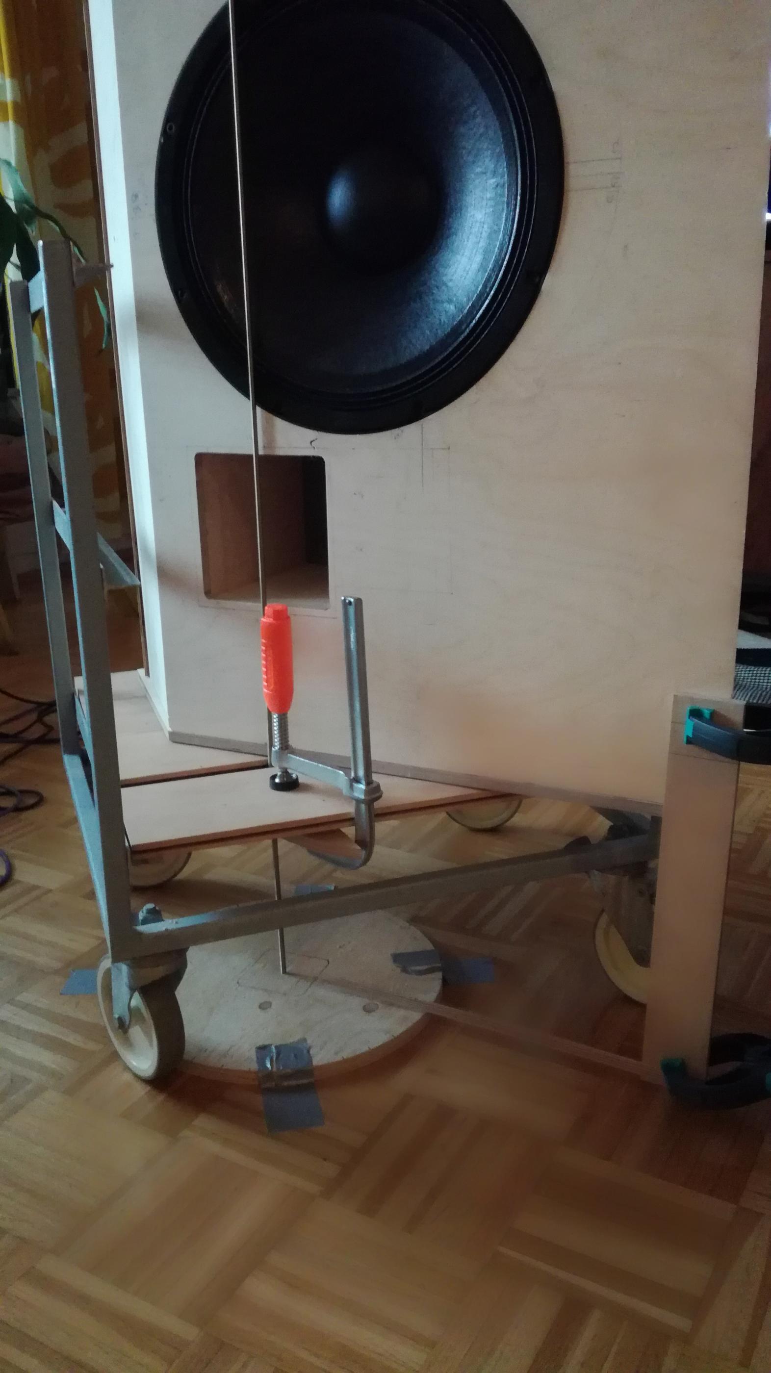

Big speakers are pain in the butt 🙂 i managed to do it like so: found a trolley from hospital dumpster (food serving trolley). Cut it to proper height and made a table top out of it. Then, make somekind of pivot pin and attach it to the trolly. I used a long threaded rod as a pivot pin. Tape driver cut out to the floor and draw the angles to it, put the trolly over and attach the pivot pin to center. make a pointer out of chopsticks or what ever to point the 0 degrees 😀 strap the speaker on with ratchetstraps and start the process. takes ages, but full 360 verticals no problem 🙂
one doesn have to move the speaker on the trolley when doing like this. just move the location of the pivot pin for each driver. wheels under the trolly allow the system to turn around any pivot point. It is not millimeter tolerance setup, but got the work done well enough.
Reactions: IamJF

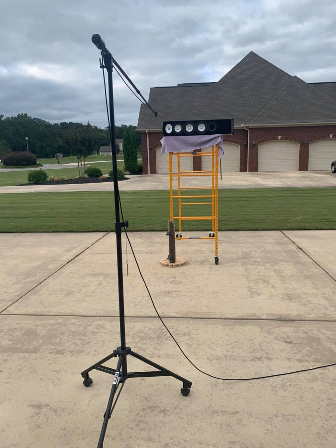

I found this image from Erin Hardison that seems like a safe and not wildly expensive option
attachment.php
Reactions: IamJF
pretty much exactly what i did and tried to explain, thanks for the photo fluid! except on the photo the pivot pin is tied to the leg of the trolly so the speaker needs to be moved on the trolly to the rotation axis for each driver. instead moving the speaker one can move the pivot pin to the driver that is being measured. Maybe he did it like that as well.
edit. found a photo of my jig demonstrating that the pivot pin can be positioned anywhere on the trolly with a bit of thinking and ductape 😀 also, degree pointer thingy visible on the photo for inspiration 😀
