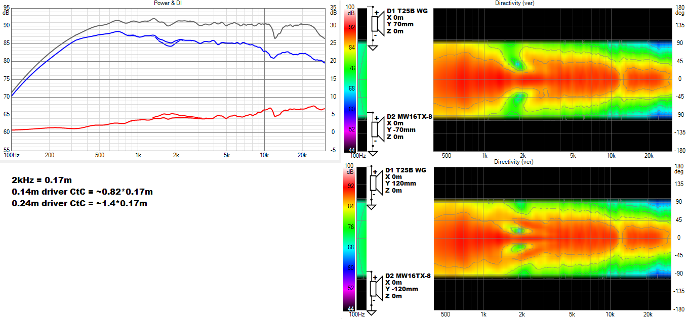

I assume you refer to the power response dip. It is caused by vertical behaviour. When I remove verticals from the calculation the dip dissappers. There is vertical polar map showing off-axis dips at Fc.
Try to move centers in Vituix closer and further apart at vertical axis and monitor what happens.
What is the cause of the "waistband" @2kHz?
Pretty unavoidable, being the vertical response of two drivers spaced separately on the vertical plane. Horizontal map would be perfect probably. A trait of almost every speaker in existence that isn't using coaxial drivers.

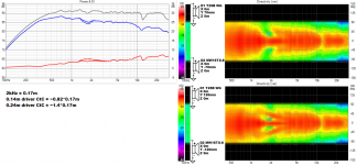

Zvu, good idea for the study. Shamal baffle is 5deg tilted, but for this case of study I made it straight baffle and tuned the crossover so drivers sum 6dB at Fc.
Study shows:
1. 140m drivers CtC, this is current state
2. 240mm drivers CtC, this provides improvement to power response and flatenning of DI. I think this confirms what Kimmo siad in other thread about CtC and ~1.5x wavelength at Fc.
CtC <140mm only worsened both power and DI so not mentioned in the graphs.
Unfortunatelly larger CtC are not visually acceptable for me. ~170mm would still look ok.
Study shows:
A large CtC taken to the extreme:

Zvu, good idea for the study.....
In what increments did you test to get the best result that yielded 240mm CtC distance, a cm at a time ?
That's about 1,4xWL@Xo
I tried 20mm increments. Going down with CtC from current 140mm made situation worse. Going up with CtC showed improvements of power and DI, and I chose to show situation for CtC 240mm because it brought noticeable improvement ~1dB. I did not go further, I was not looking for optimum, just wanted to see what direction things go, and CtC 240mm is already too much for me to accept for any design with similarly large drivers.

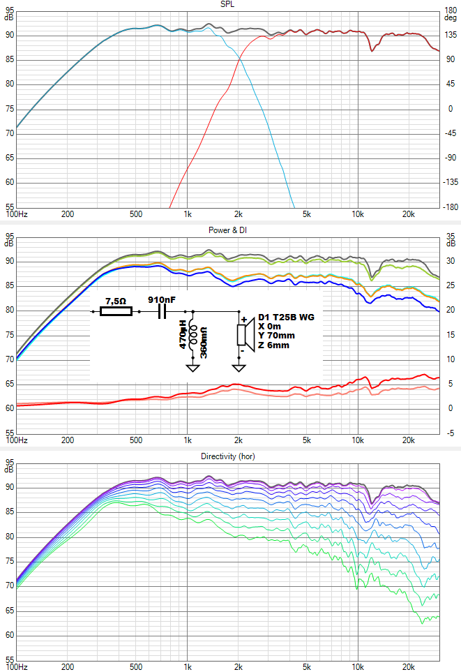

So today I took measurements for crossover design, and modelled the first version. I am very happy with the results so far. And the dip at 13kHz does not look good, but it is only -3dB and very narrow, I will try some experiment to improve that, later, but I assume the dip will not have significant impact on sound quality.
Modelling done in Vituix v2, graphs contain vertical measurements.
I took horizontal measurements 0-90deg, in 10deg steps. Vertical measurements are not needed with Vituix v2.

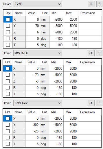

Hello Petr,
Could you develop why, in VituixCAD 2, vertical measurements are not needed to fully characterize a design ?
Vituix mirrors horizontal measurements of each driver to vertical measurements (circular drivers). This is why v2 method requires horizontal set of measurements to be taken at the elevation of each individual driver.
To enable vertical polar pattern calculation, XYZRT coordinates of each driver have to be filled in.
When these prerequisities are done, Vituix "manipulates" individual drivers responses to calculate the result in virtual mic position. This is powerful feature, as it allows to design quite complex loudspeaker, with multiple woofers etc. Common mic position has its limitations and the results are not accurate.
Important note: all my measurements are done dual channel to get measured drivers phases right. Coordinates here represent positions of drivers on the front baffle and related to ref position. Coordinates here are not about acoustic centers.
That was fully understood, but in real situation (ie a loudspeaker like yours) in no way the vertical set of each driver will be the same as the horizontal one due to fact that edges seen from each driver will not be the same in the +/- vertical plane.
To my understanding, XYZ drivers coordinates are used to compute the result for mic location in VituixCAD. Maybe I am wrong ?
