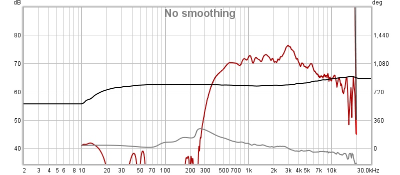

Below is the response of my HF108+horn, it runs strongly until about 500Hz.

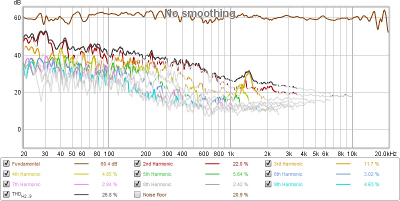

At low frequencies reaching Xmax resulting in too much distortion will limit the maximum level.
At this moment I have the soft limiter of the tweeter amp at 10W.
I cannot make calibrated measurements, but to my ears the speakers go plenty loud without any stress.
Below is a distortion graph from REW, this was taken at relatively low level.
I don't think this is a very reliable measurement because of the high noise floor outside, but it does show nothing terribly wrong is happening.
kind regards, Peter

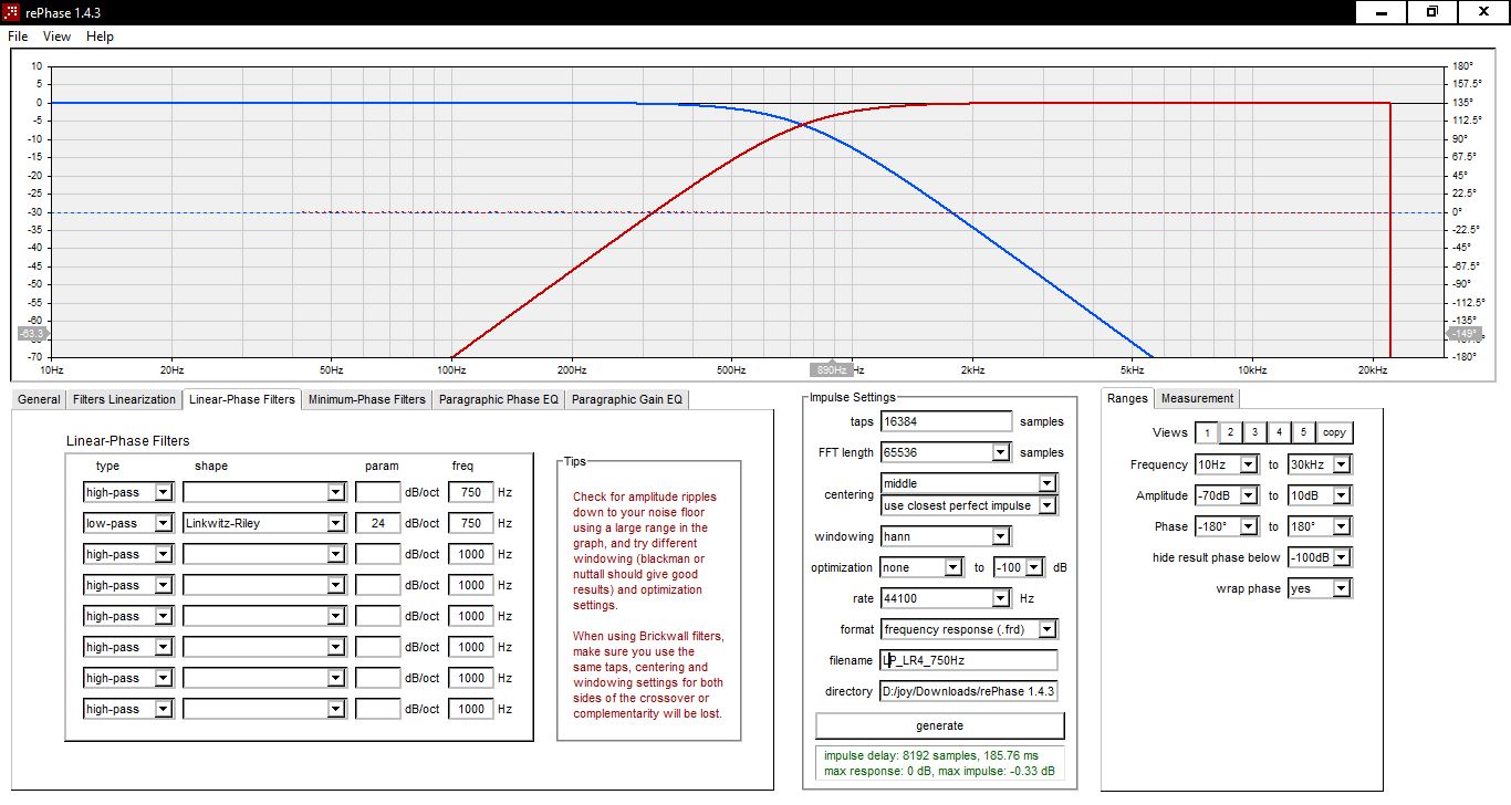

Please download the software rePhase - Official Site - Free FIR filtering tool first. You can create .frd files that can be imported to REW and with rephase, you can create plain text book LR4 filters. Together with REW, this means you can have an ideal LR4 high pass and low pass curve in REW as targets while you are measuring individual driver response. This is why it does not matter if Mr. Putzey decided for a certain slope Q with HPX software. You can simply track what your inputs in HPX do and what an ideal LR4 filter should do at a certain XO frequency, and you can manually adjust your filters in HPX until they match. Remember that this is sufficient, because the only filter that matters is the actual acoustic.
For example, my speaker's compression drivers run on a digital LR2 filter, but because the compression driver is already on its performance edge at my chosen XO frequency, this is sufficient to achieve acoustic LR4 filter.
As a starter, I generated LR4 HP and LP for a 750 crossover frequency. You can import the files to REW and see if your driver's measurements track these curves. If not, you have to work over the filters. If you need other frequencies, help yourself with rephase. Also, do not forget to adjust the SPL of the target curves, as already suggested above. They will often be invisible because they reside at 0 dB SPL. For this, in REW click on "Controls" in the right top corner and add a common SPL offset for both target curves that match the level at which you are doing your measurements, i.e. 70 dB SPL. You can also hit "Add to the data", then, they will stay at this level the next time.

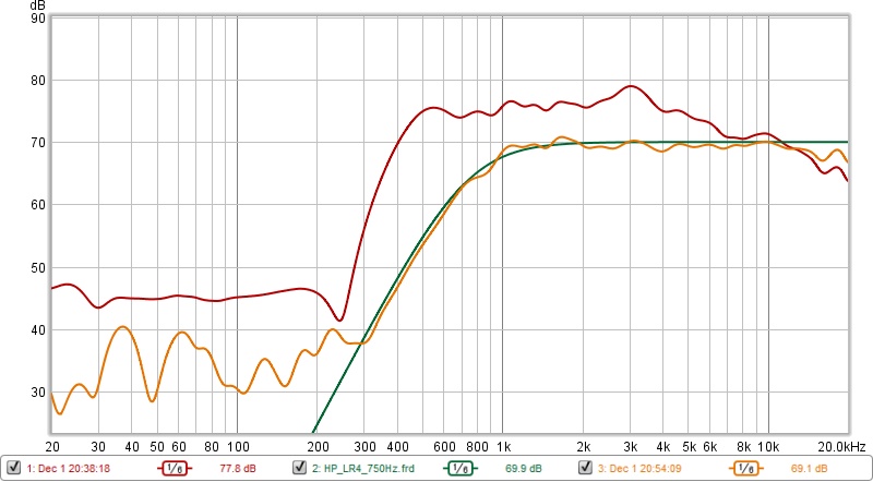

hi Sheeple,
Thanks for your explanation.
I tested you proposal today, using your 750Hz LR4 file, see picture below.
All measurements are in room with a 5ms window, measured about 1m from the horn.
First measured the tweeter without filter, then started entering the filters en eq in the Hypex software and loading each iteration into the plate amp and measure again.
Turned out that if I put a 750Hz LR4 in, I needed almost no extra eq around the crossover area to get a nice fit to the target curve.
After that i did some eq to get the 3kHz down, and some shelving to lift the response above 10kHz.
(The curves below 300Hz are not reliable, this is mostly background noise)
After this I put the mic around 3m from the speaker to find the optimal delay, inverted the woofer and started varying the delay in HFD, deepest notch was quickly found.
I am now listening to this filter and it definitely sounds better than my previous efforts with a lot of eq, it sounds less stressed.
I can't hear where the crossover frequency is, and there's more space in the music.
I probably will tweak the HF a bit, it a bit laid back now.
