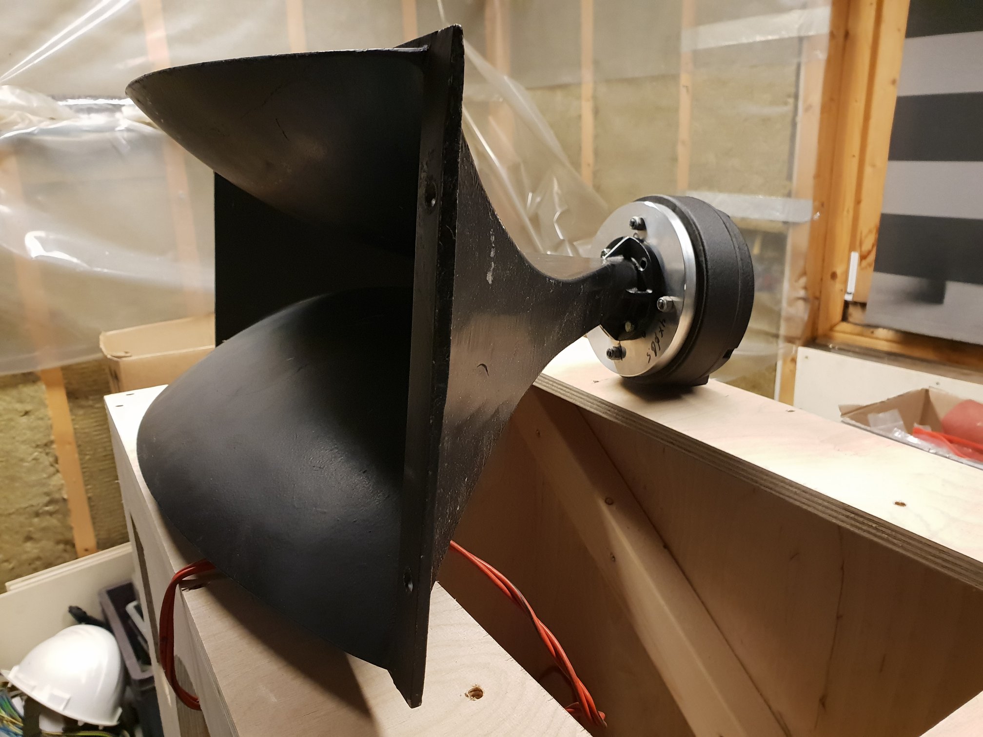

- I found some big old cast bi-radial horns on our local 2nd hand website, brand is unclear, could be Vitavox. The throat size is a very strange 41mm or 1 3/4", I'm having an adapter 3D printed after getting advice from this forum (https://www.diyaudio.com/forums/mul...ng-throat-adapter-hf108-vitavox-biradial.html)

- Dimensions were chosen starting from the horn which is 62cm wide, height is 80cm because it looked nice, depth is just 31.5cm. This results in the HF108 sticking out of the enclosure which enables experiments with a bigger rear chamber

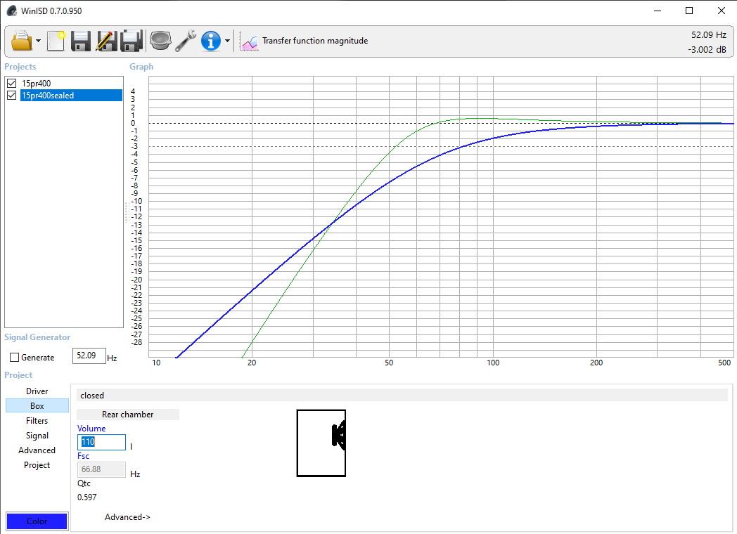

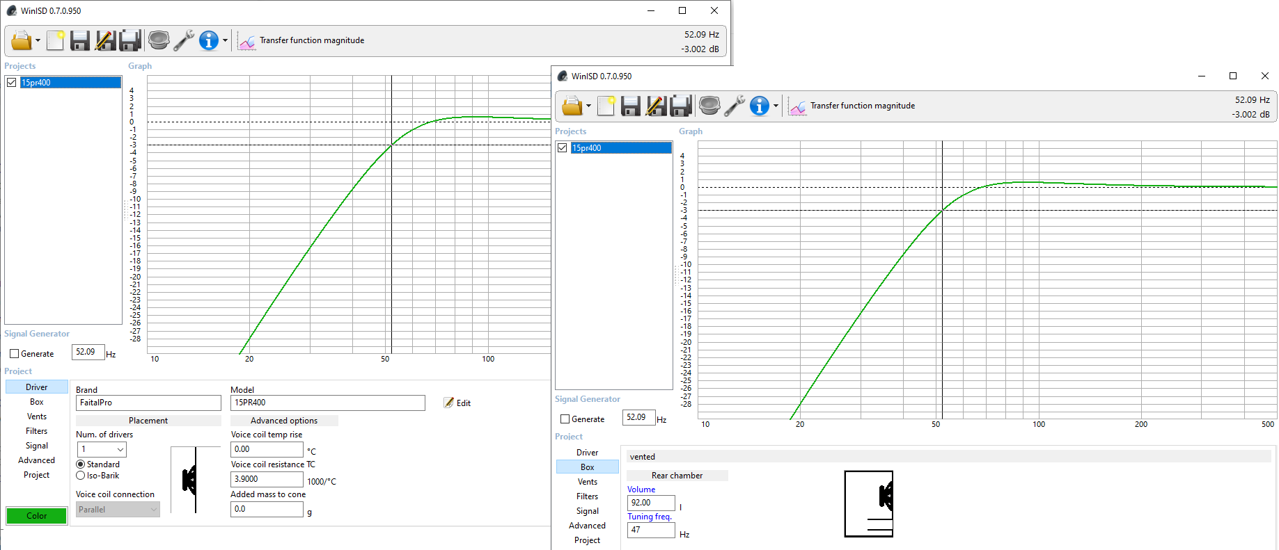

The volume of the box is about 110 liter, according Winisd this will give me a Fsc of 64Hz with a Q=0.58.
With a Linkwitz transform is simple to bring this to 30Hz with a Q=0.707 and still go plenty loud with 250W (and stay within Xmax)

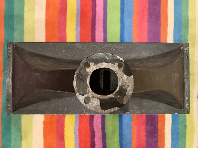

Can you show a couple more pics of the backside of that quasi Vitavox horn ( I'm still really curious about its origins ).
Nice project Peter!
I've always loved the classic look of a large radial horn sitting over a 15" woofer.

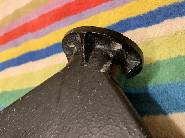

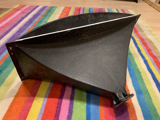

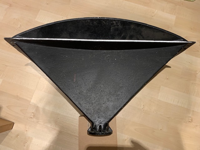

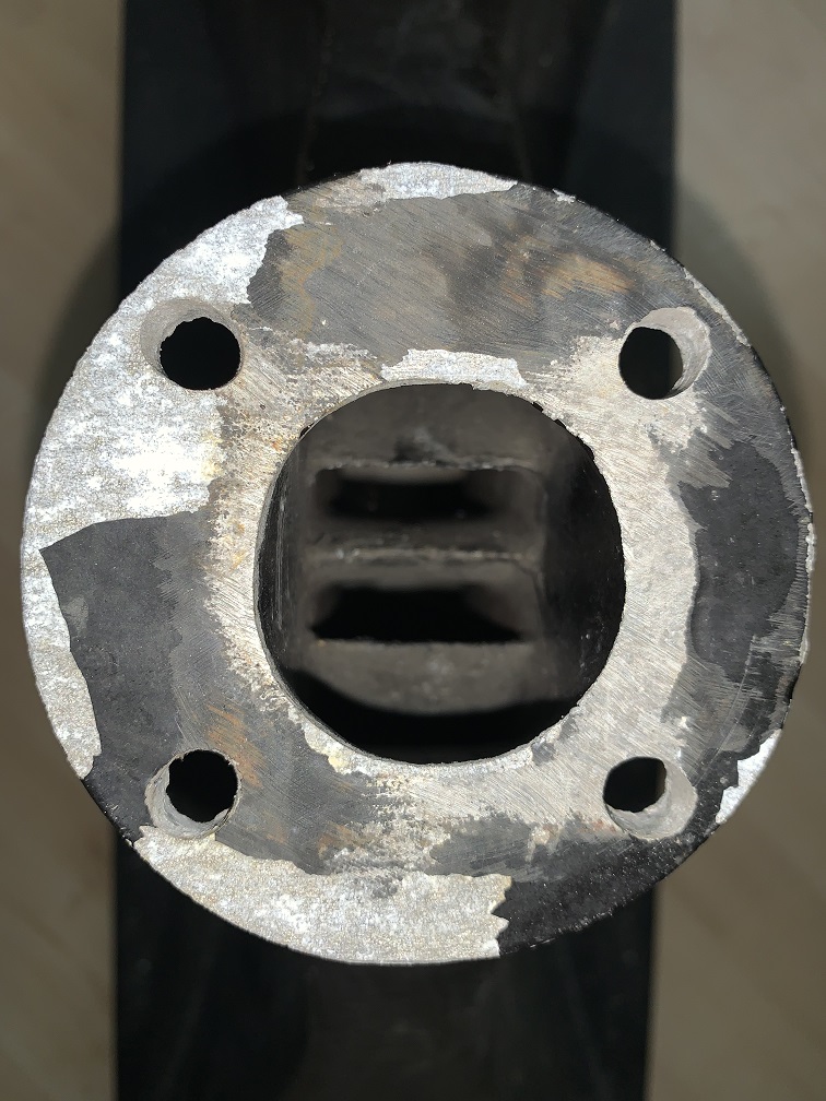

hi EarlK,
I've attached some photos of the horn, I can add other views if you like.
One thing is clear, they need damping, they ring like a bell.
I spend quite some time with google to find out what brand they are, only found one reference on faceook, I will post these in the next message to keep the images separated.
regards, Peter

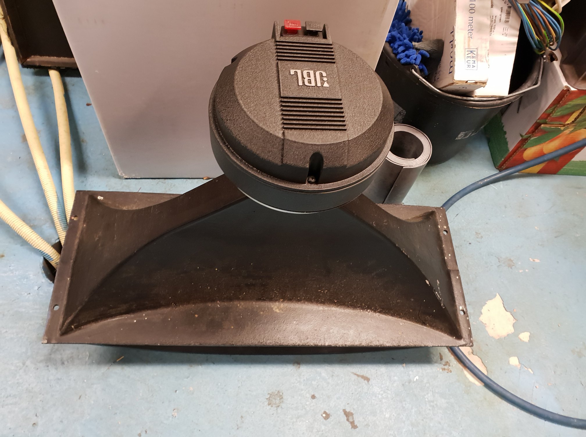

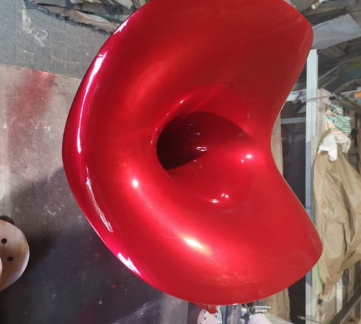

Google found this on facebook, I don't have a facebook account so I cannot contact the guy. Therefore I don't know why he thinks it's a Vitavox horn...
I think they look very similar to my horns.
I'm modelling the same'ish box in WinISD and while I'm getting the same results, Xmax is reached at about 8 watts input signal, resulting in a max SPL of around 104dB. I'll probably never reach that in my living room, but I'm still curious about your simulation and you mentioning 250W
hi Cooljazz,
Thanks for you interest en remarks.
I'm clearly not an expert in WinISD, the cone excursion I saw was at 1W, and indeed Xmax is reached at about 8W.
I hope to measure response and create a first filter this weekend weekend, I'll report my findings.
kind regards, Peter

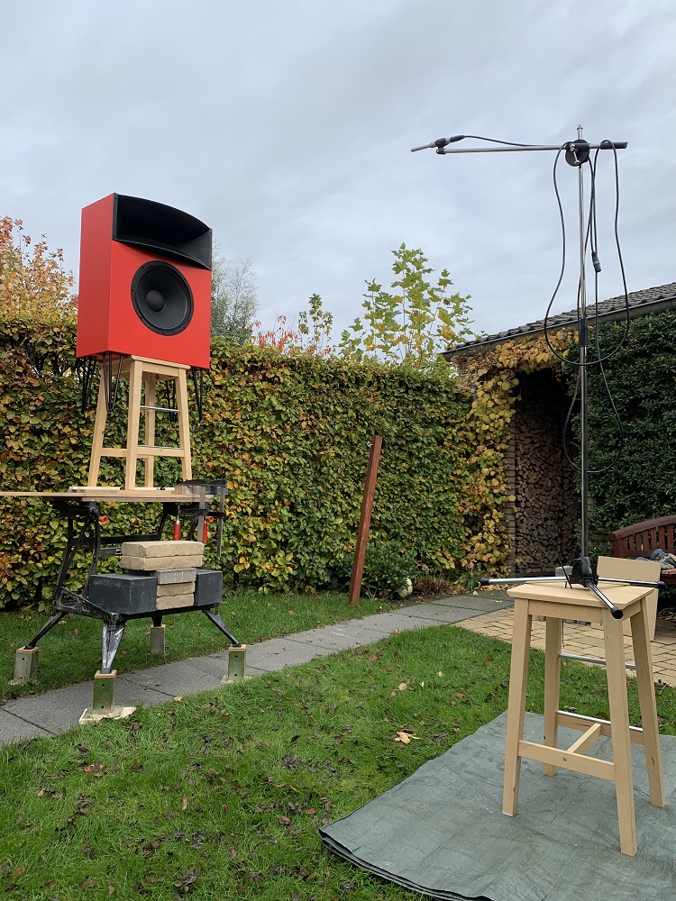

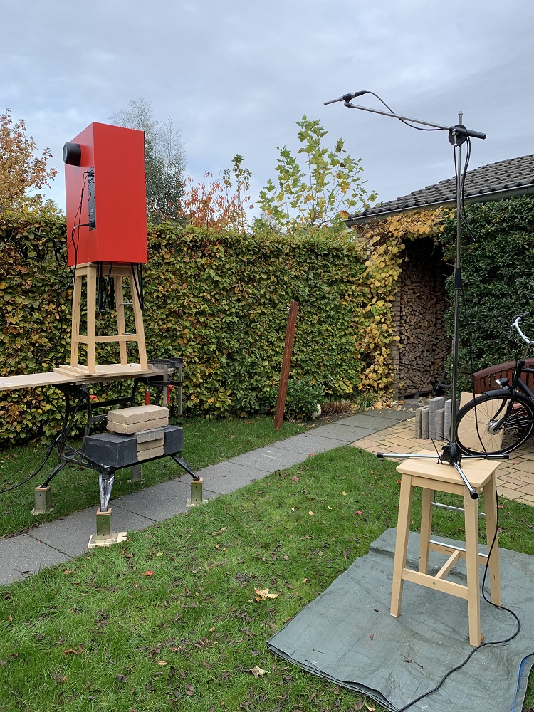

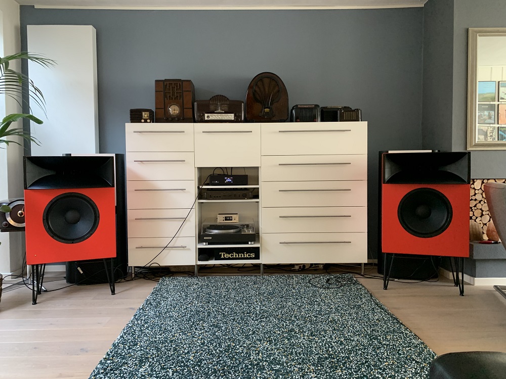

Update!
The speaker building project is finished, measurements have been performed outside, first filters have been made in Hypex Filter Designer.
First listening tests are very positive, the sound is very 'big' and effortless without a trace of harshness. Overall sound in warm, I can listen for ours and only want to hear more (and louder).
Bass is massive with the cone moving just a few mm.
Crossovers were made following the Grimm Audio LS1 white paper, in short, equalizing the raw drivers to a flat response to 1 or 2 octaves outside their pass band and then apply a 4th order LR filter

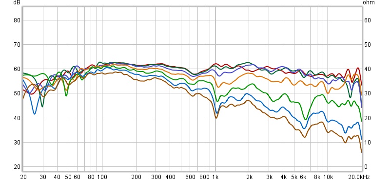

Crossover is at 750Hz at this moment, and as seen from the measurements, crossover is not perfect, I think I have the delay of the woofer not correct, I don't completely understand HFD regarding this. I measured the individual drivers with HFD as adviced, this should make sure the measured timing is correct. To be continued.
Response seems reasonable constant up to 30 degrees, beyond that response begins to drop, to me the takeover from woofer to tweeter looks quite good with this crossover frequency. I will have to work on the delay issue
For a next project I think I would try the XT1464 horn, it will measure better, but this old thing does look cool 🙂
I really love the Hypex Fusion amps, they have great possibilities and great sound, but as all DAC's and active speakers with a digital input, they are extremely sensitive to the quality of the digital input signal.
thanks for looking, kind regards, Peter

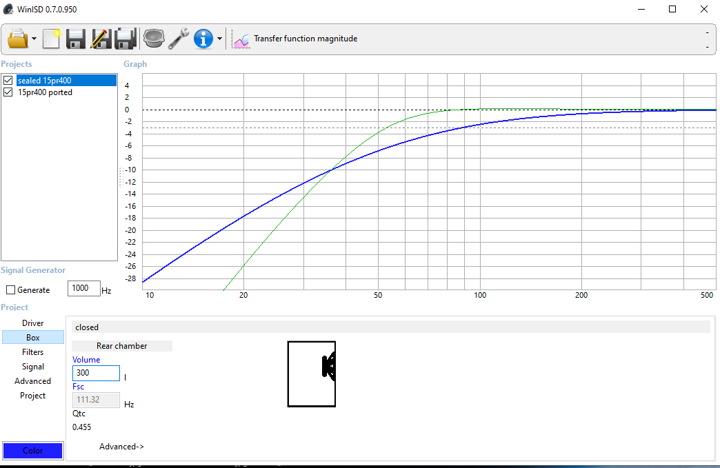

Is yours sealed or ported?
If you flattened the driver responses past 1 octaves from the xo point and applied the LR slopes, then reverse one driver's polarity and adjust the timing to the point where the reverse null is the deepest on your desired axis. Reverse back the polarity to normal of the previously flipped driver, done.
Of course, this is just one method, but it works.
Reactions: el156se
For science.
I took the liberty to compare my 92L ported (tuned to 47Hz), and your sealed at 110L. I will try it and stuff the holes and see if the midbass is clearer.
hi Deni,
Thanks for your response, that's what I did, resulting in a delay of about 1500us (about 500mm) which is way more than expected, in HFD the sum is perfect.
The response of the total system was measured with REW and that's not perfect.
I also measured the individual drivers without filters with REW and when I subtract the 'Start time (seconds)' of both i get a calculated delay of 666us which seems much more logical (about 200mm).
Something goes wrong in HFD.
I have to put the 666us in the speakers and then measure the overall response again, hope I can measure this inside as I won't bring the speakers down the stairs again.
regards, Peter
