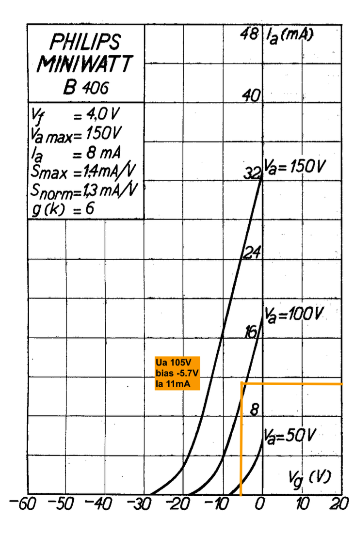

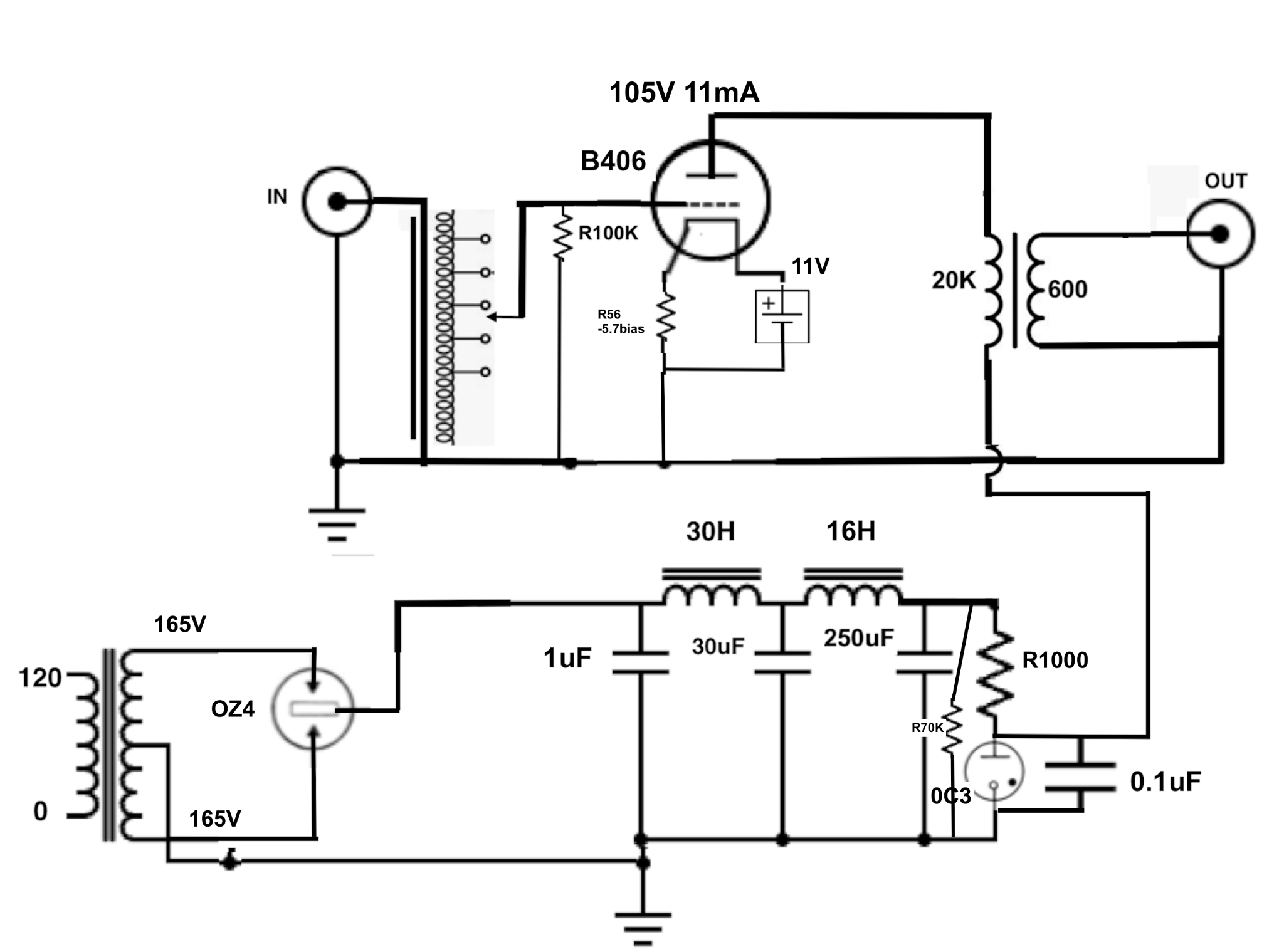

Hi everyone, the pre-amp is up and running. I do have a couple of follow-up question.
1. My primary input sources is a 2Vrms streamer. So, what is the ideal bias voltage for the B406? Note, the max current for the B406 is 15mA due to the limits of the L1 and L2 chokes. On the attached tube load lines, I have identified (in orange) the existing operating point. Not sure if -5.7V bias is to hot or cold. Thoughts?
2. How is C3 bleeder resistor value calculated? Is there a formulae.

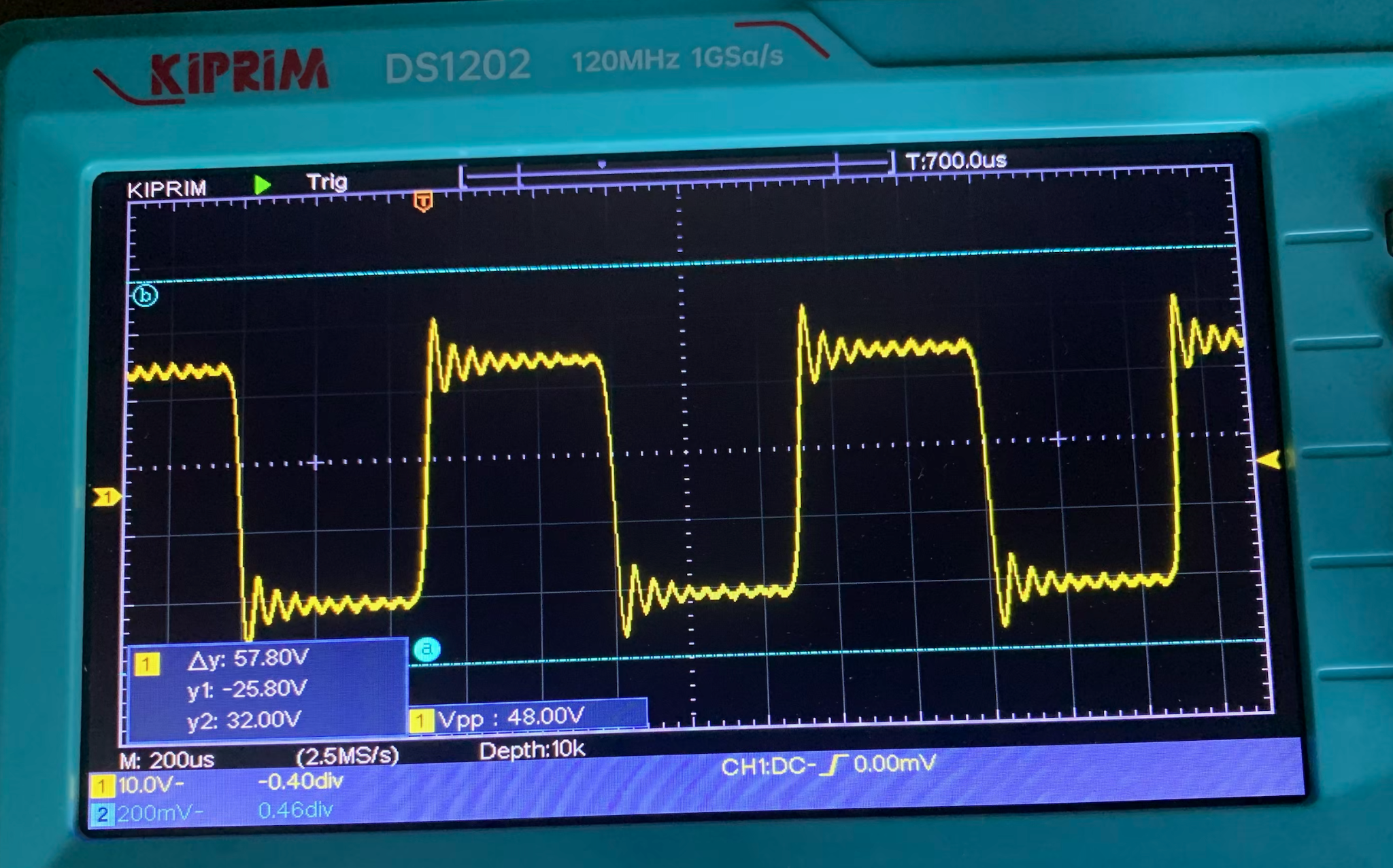

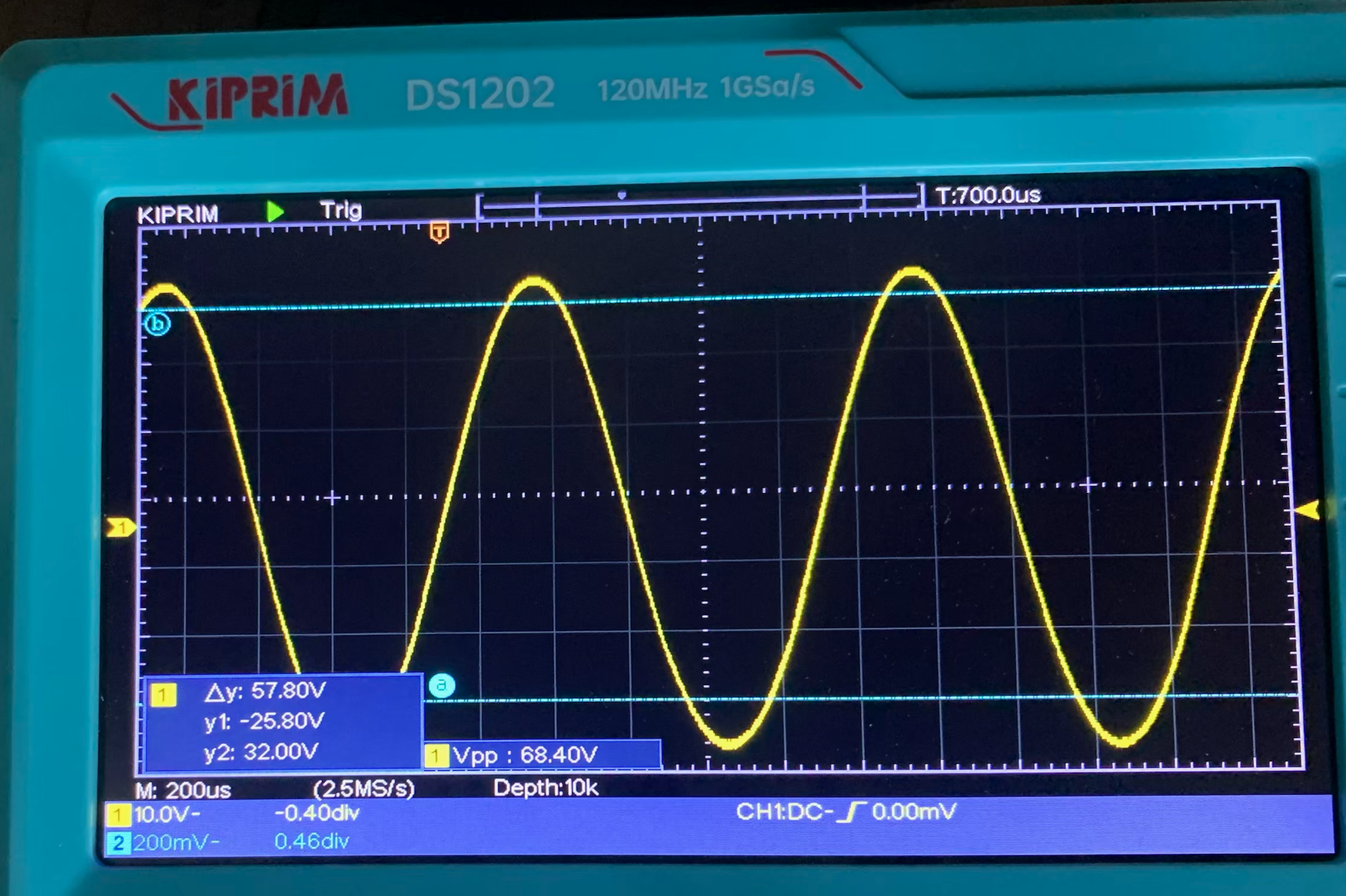

Just took a couple of scope measurements at the pre-amp RCA output jacks. The Vpp is 6.8V output. Output is maximum on the pre-amp. Input is 1K, 0db sine wave from my streamer (2Vrms). The sine wave on the scope looks clean. However, the square wave looks like overshoot or ringing. Is this typical? Thoughts on how to remediate if this is of concern? I am relatively new to scope measurements, so any input would be greatly appreciated.

So, I put a 0.1uF cap from grid to ground. This cured the issue. I can "tune" the overshoot/ringing by changing the cap value. Not sure why this does the trick, but it works nicely. See attached schematic.

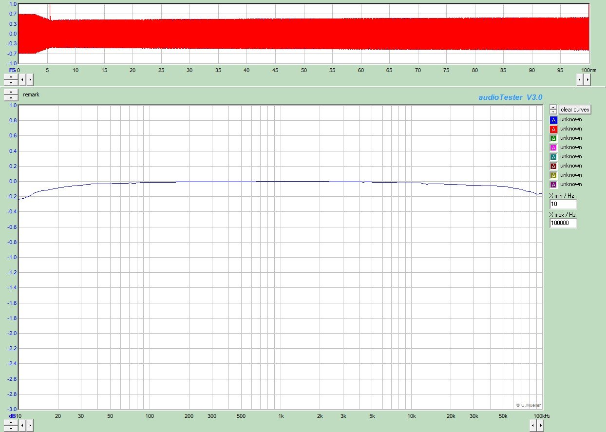

The pre-amp is running and sounds very good. I would like to add a bit of "weight" to the sound. The tonality is rich, but overall the sound is slightly lean. So, any thoughts on changing my output transformer to an RC coupled output? What kind of audible changes would be expected? Might this help with adding some "weight" to the sound with an appropriate output coupling cap?
Sample: 801 (graphite anode, Ri about 4k) preamp with 24k:600 Noguchi transformer.
For me Finemet always looks "thin".
Are you measured FR?
If you want more "body" use another -core- transformer... or other type load.

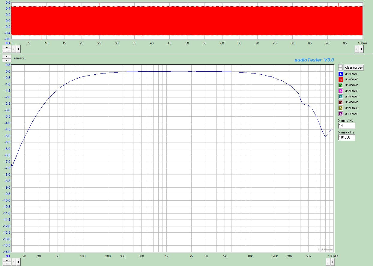

Sample (my 801 preamp): 801 (graphite anode), SS "gyrator" loaded:
