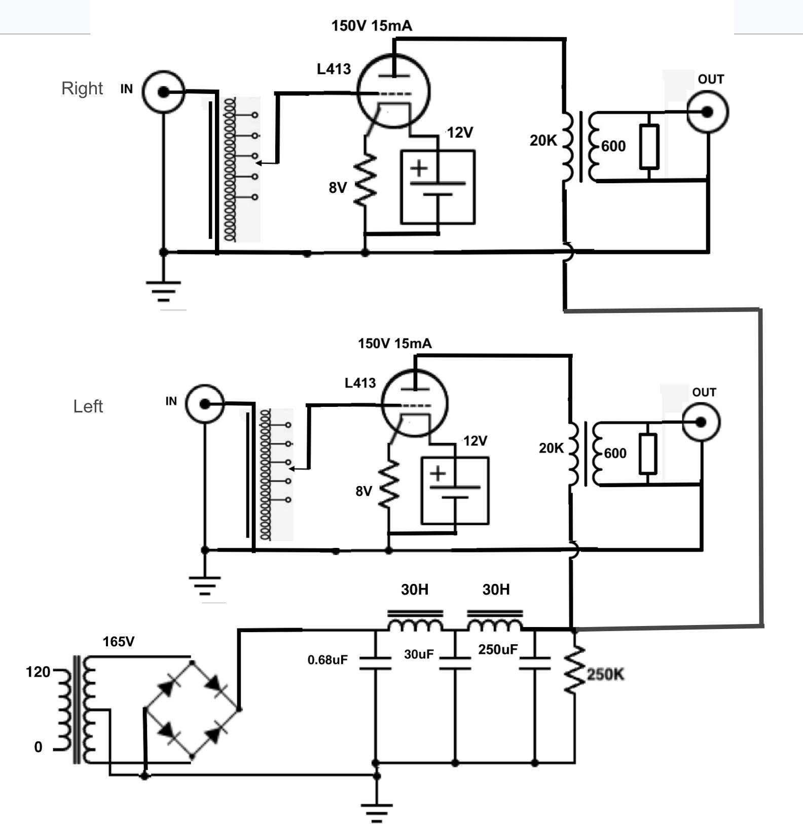

I have used a BH for the last 3 years with no unpleasantness. It's the rectifier in the power supply for a wee SE DHT Class A2 power amp (0.5W) using 1L5Gs and type 52s. Cold-cathode (or gas discharge) rectifiers are closely related to gas discharge voltage regulators (like the 0D2 etc). The 0Z4A was made and used well into the 1960s.I can't find much user experience on the BH rectifier, other than the spec sheet (attached).
Looking at that data sheet for the L413, my German is lousy but is that some advice at the bottom to use some sort of current limiter for the 150mA for the DC filament? (Gleichstrom-serienröhre)... Also, I am using an L413 tube which is very similar to the B405. ...
What voltage are you using with the BH? The specs say 350V minimum starting voltage. What are you using? My design calls for only 165Vac and dc rectified, therefore I believe the BH won't be suitable.I have used a BH for the last 3 years with no unpleasantness. It's the rectifier in the power supply for a wee SE DHT Class A2 power amp (0.5W) using 1L5Gs and type 52s. Cold-cathode (or gas discharge) rectifiers are closely related to gas discharge voltage regulators (like the 0D2 etc). The 0Z4A was made and used well into the 1960s.
I use a 350-0-350 VAC power transformer to supply the BH. I followed the manufacturer's recommendations and placed 0.1uF capacitors across each secondary and a 4.7uF capacitor as the first filter, followed by a choke (the data sheets are from John Atkinson's very helpful One Electron archive at: https://www.one-electron.com/Archives.html). Thereafter I used C-R-C filtering to further reduce ripple and set the required voltages (in my case 210V and 165V).
While 165V is achievable, your proposed circuit draws about 30mA, which may be on the low side for good operation of the BH. Though Raytheon didn't suggest a minimum operating current for the BH, it recommended at least 200mA for the BH's bigger sibling, the 350mA rated BA. So I guesstimated that a BH might need to pass at least 75mA to operate well (I don't know for sure - I didn't try lower current operation).
In the circumstances, your choice of silicon diode rectifiers seems sensible. Load current aside, the BH is not an efficient device, especially when compared to silicon diodes - there is a considerable drop in voltage across the BH rectifier which increases somewhat as the load current increases.

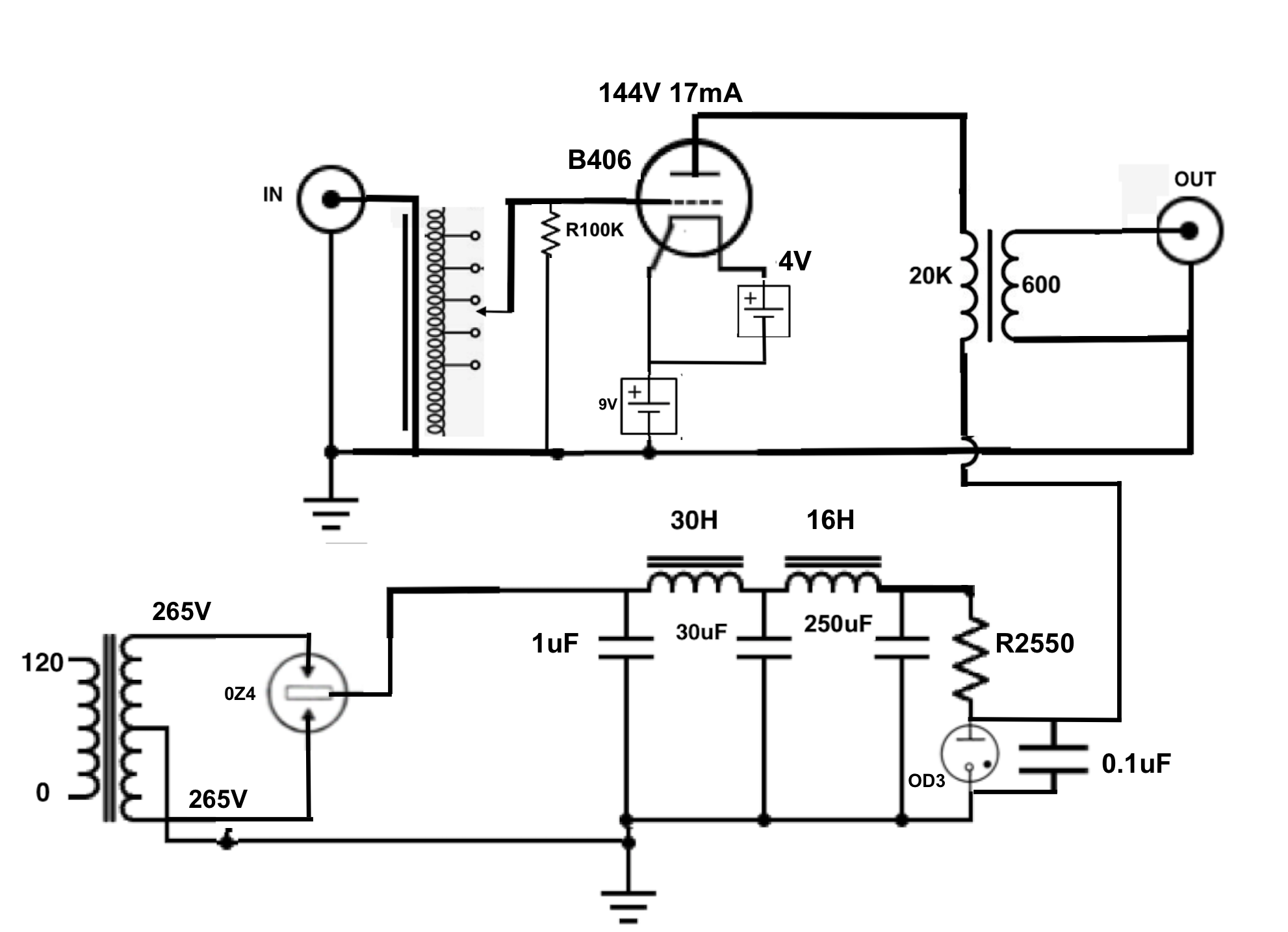

Hi everyone, hope all is well. Some time has passed and I finally have the pre-amp up and running. The current schematic is attached. I need some help on 2 questions.
1. When the pre-amp is turned on, there is a loud "pop" which is originating from the OZ4 cold cathode rectifier. Wondering if you see anything wrong with the schematic or ideas to remediate this?
2. The Line Out transformer secondary is 600ohms. I have not put a resistor across the secondary, as the 600ohm load is OK with the 10K input load on the solid state power amplifier. Do you believe I should add a resistor across the secondary?

The schematic definitely wrong.
The 4V filament battery must to connect to filament pins and 9V battery working as bias supply (from one filament point to ground).
Is filament always heated?
If not, try to turn on filament heating (when tube conducts current) and power supply turn on at different times.

If input voltage controller switch isn't "make before break" type, must to use -for example 100k- grid leak resistor (from grid to ground).

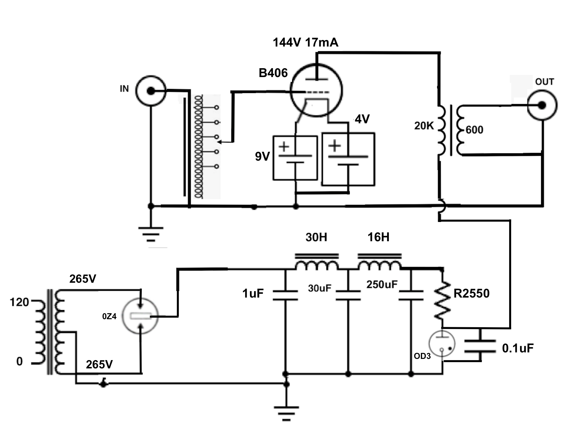

Bela, thanks for the response. Good catch on the filaments. Here is the updated schematic and I also inserted the grid leak resistor.
Meanwhile, any thoughts on the loud "pop" when the amp is turned-on?

Try to separate the PSU for the amp.
If both channel use the same PSU, try to detach its, and load PSU with 4k7 15-25W resistor (the dissipation will be about 5W).
Try to measure voltage on C2 (30uF), C3 (250uF) and on the output.
If "pop" can be heard even so, probably the cold rectifier "jerking" the PT with too much current at startup.

So, I put in a varistor and that did not help the "pop". Also, the grid leak resistor helped with the occassional "make before break" issue, which is nice.
I am going to look into alternative rectifiers. Trying to avoid another darn transformer for a rectifier filament.

Try to put 22R...220R resistor (value depends on the C3 voltage and Od3 voltage difference) amongst rectifier and C1.
