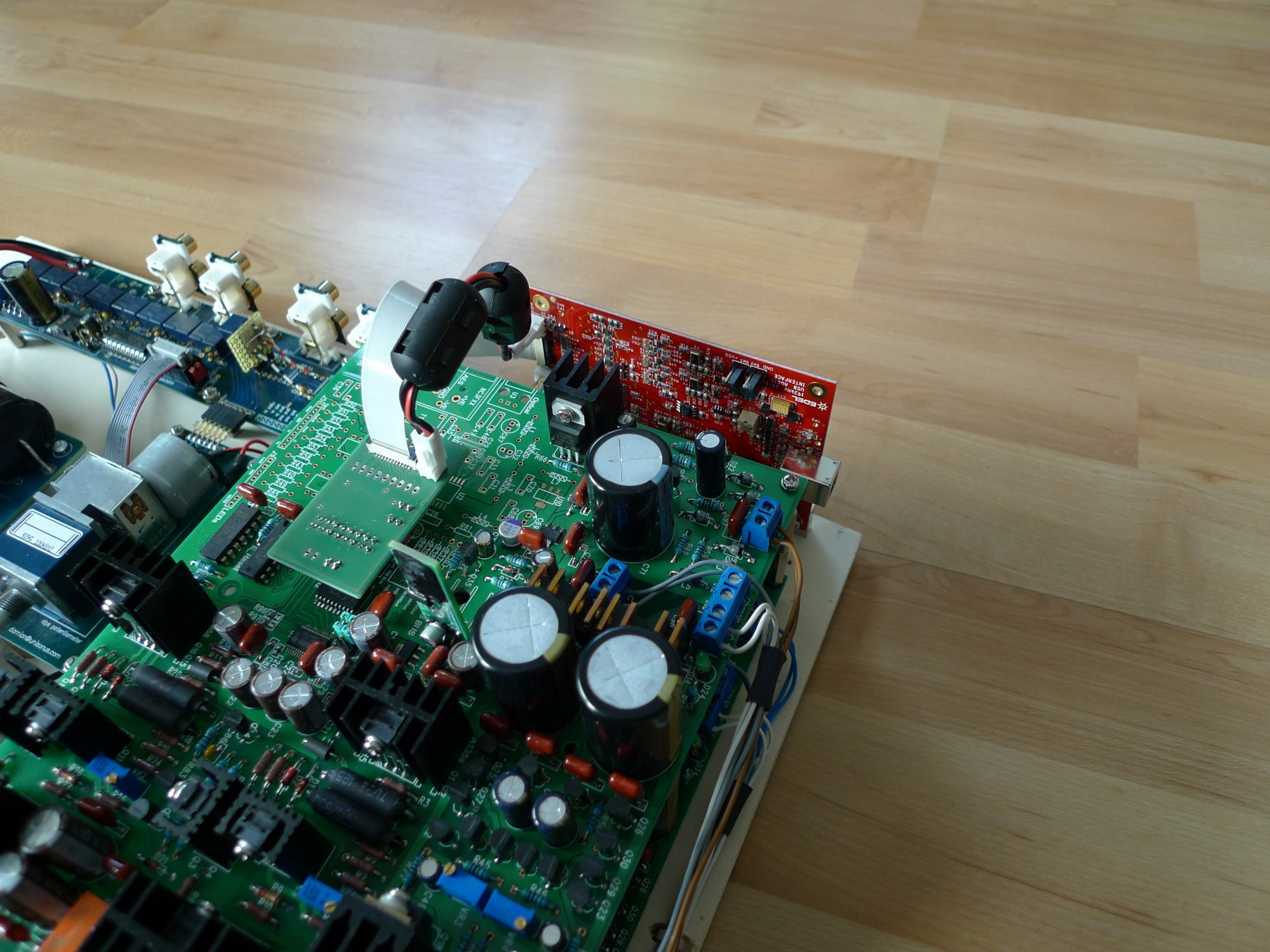

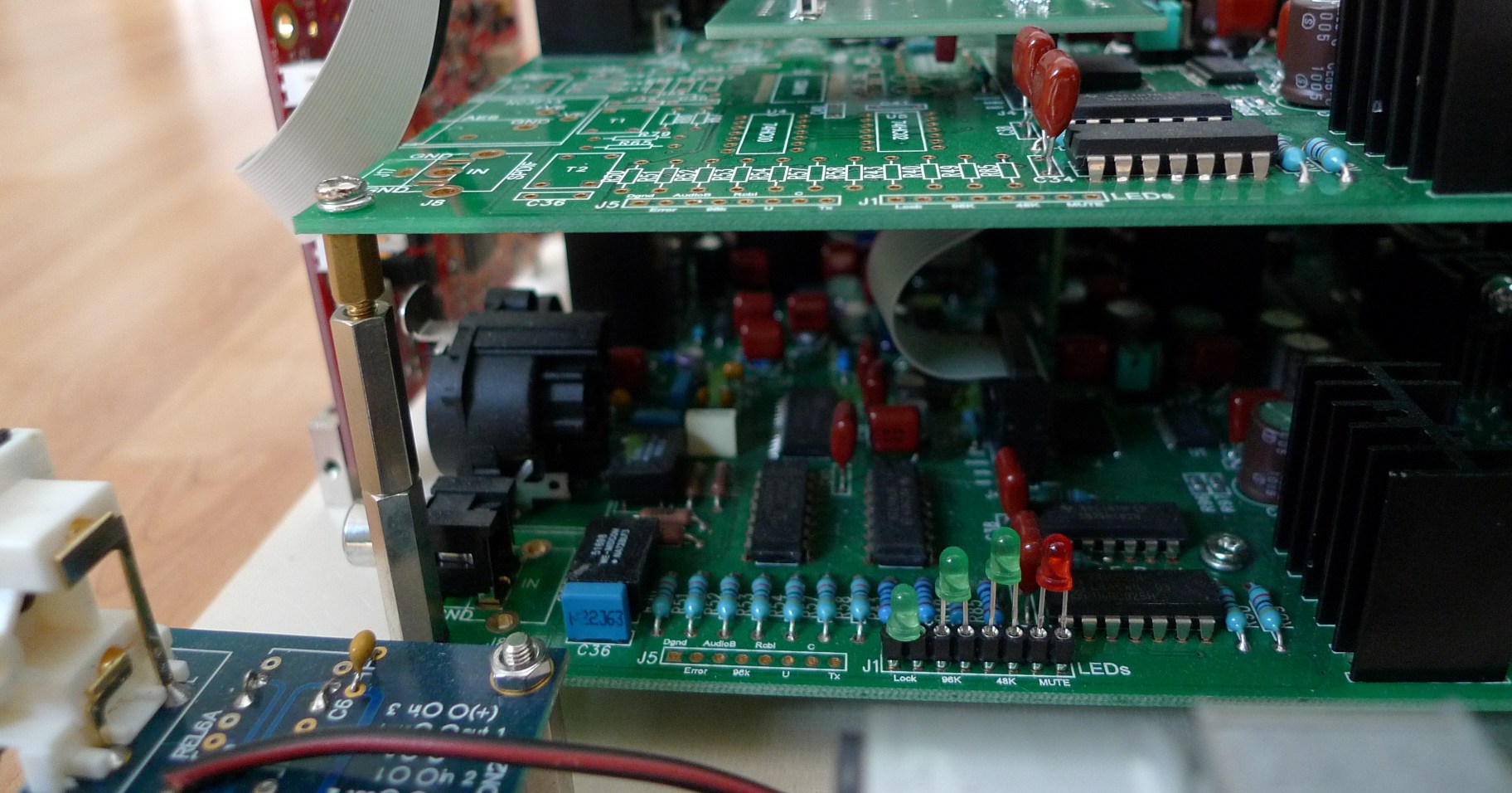

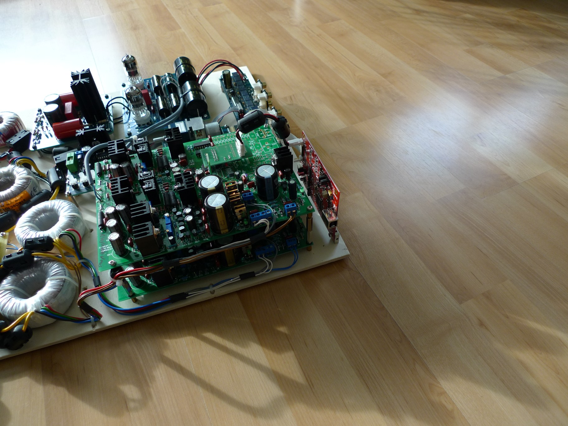

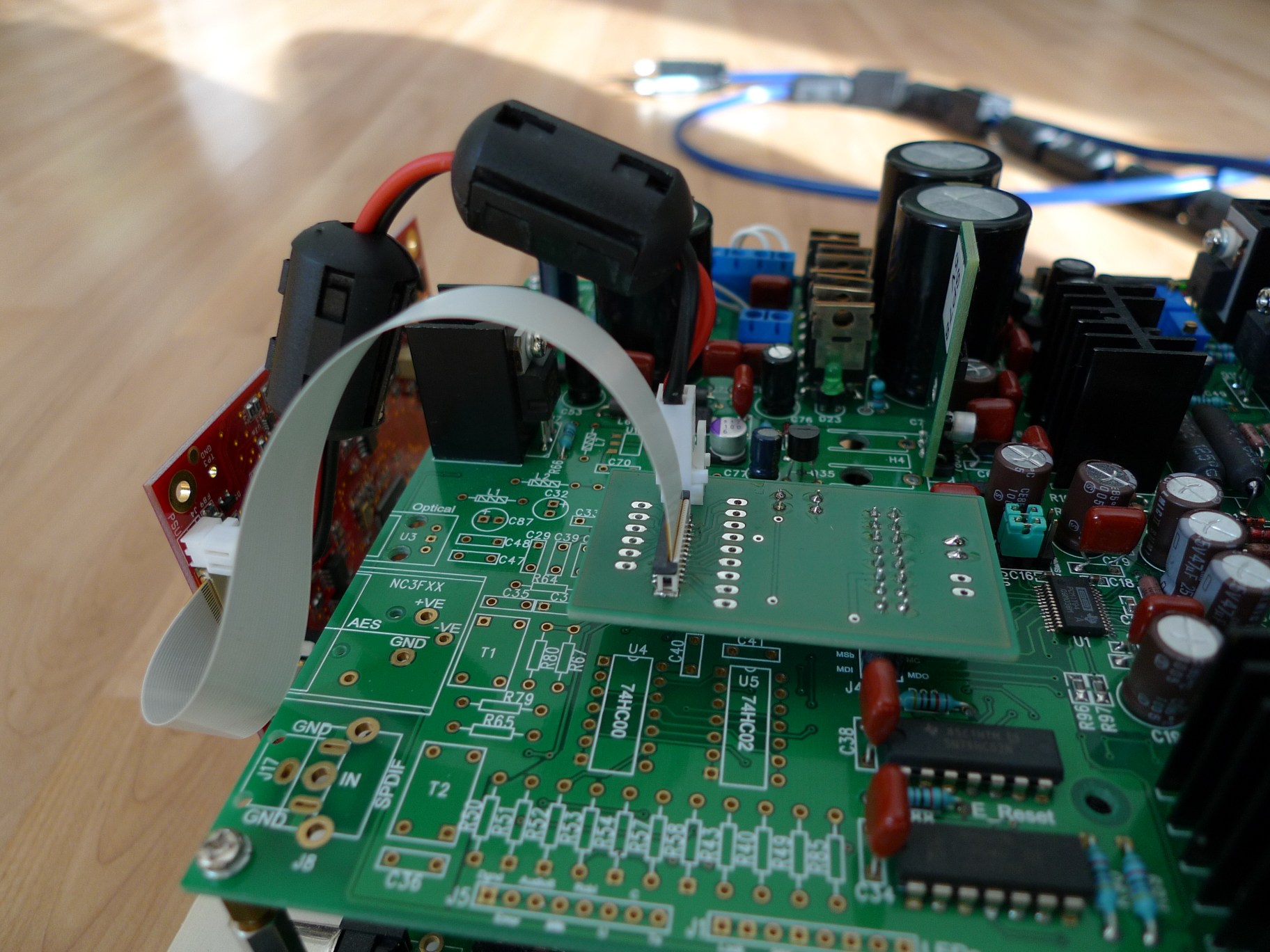

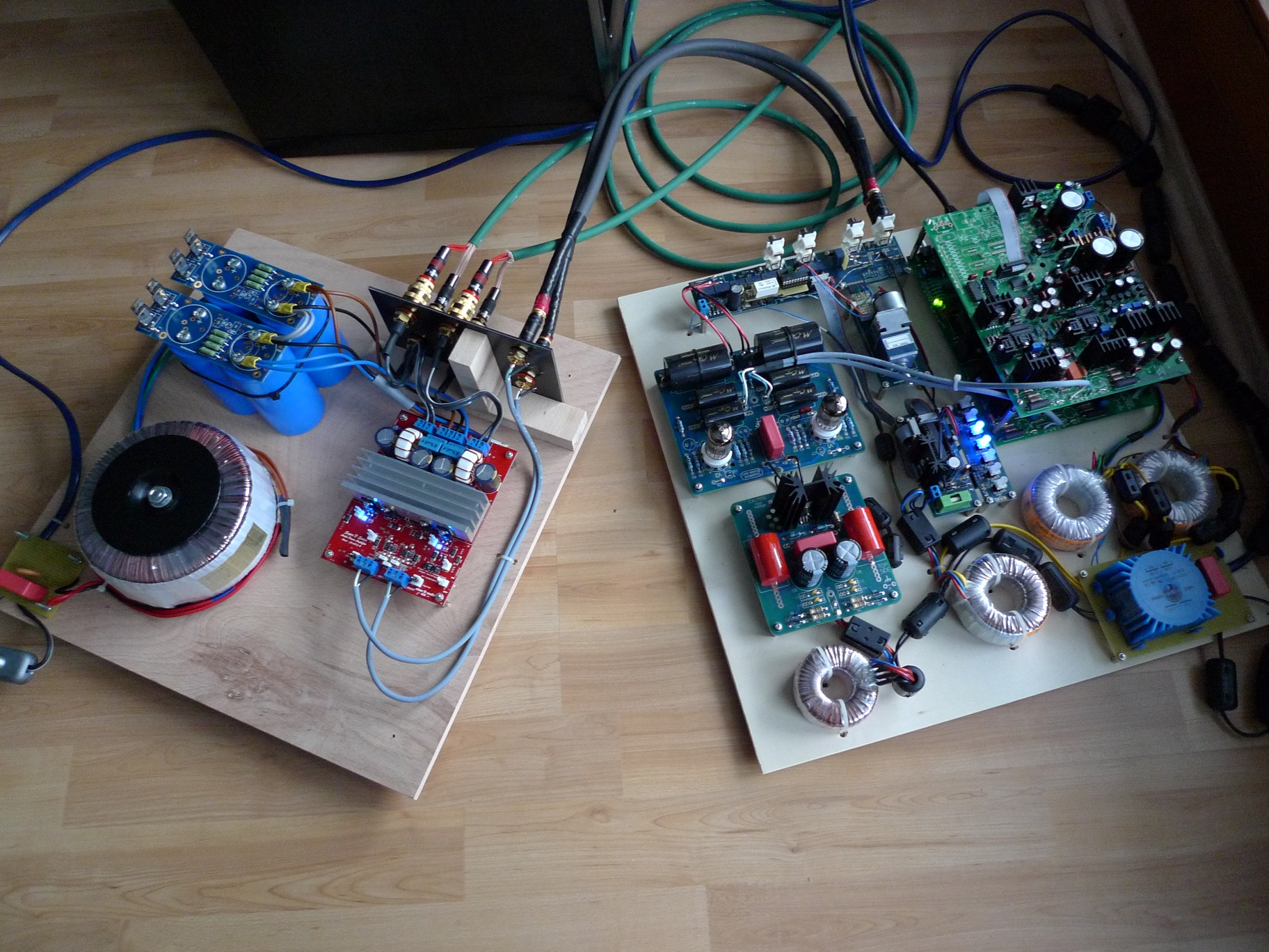

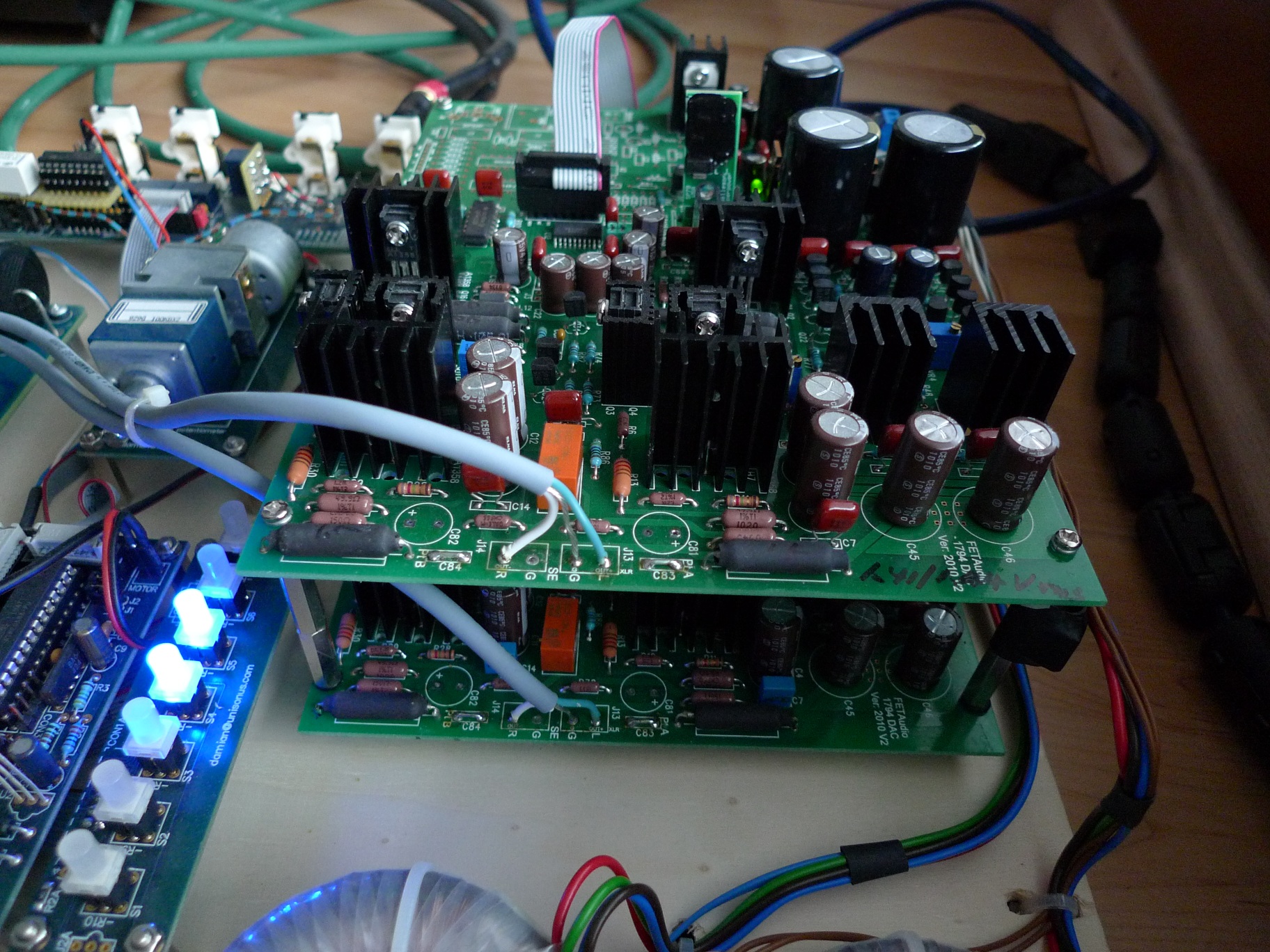

Hi All,
i had build a pre amp dac with the boards from spencer, it sounds fantastic. I would like to express my sincerest thanks to spencer and community to provide and support such great dac.
Attached some photos of my DIY stuff and dac boards.
btw.. i upgrade the dac with HFA rectifier diods and bellson LDO..
Regards
Marcus

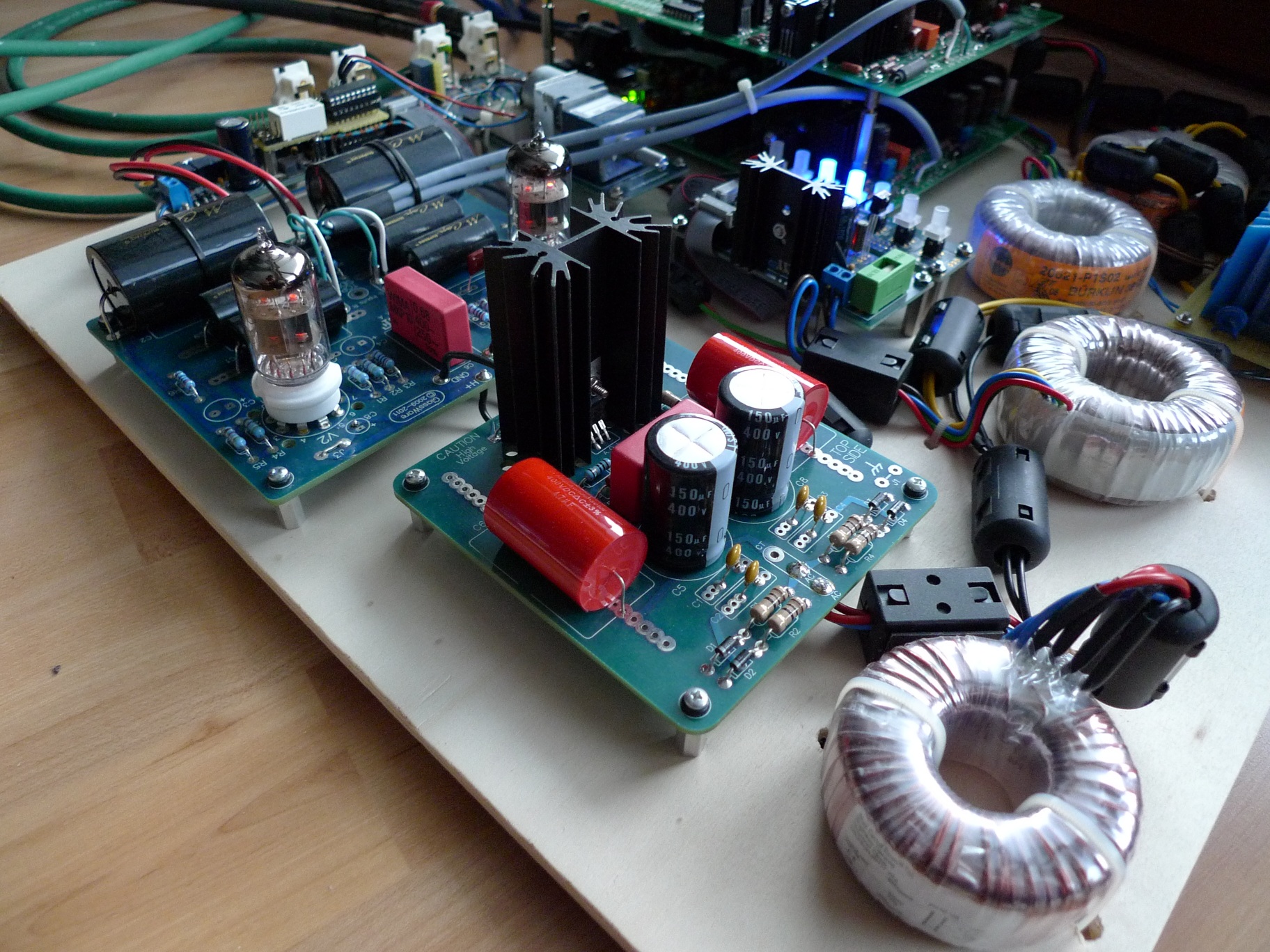

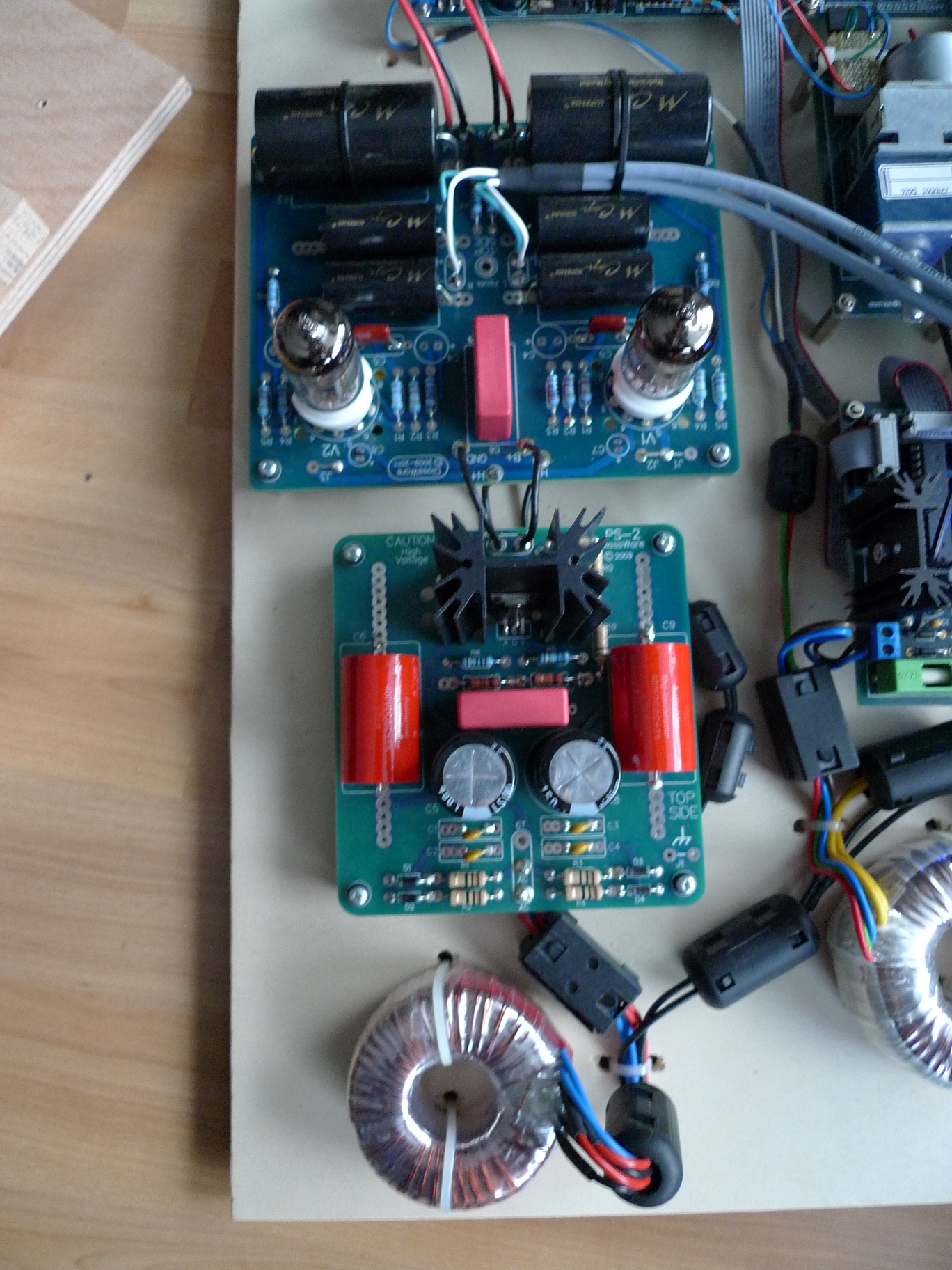

Hi Marcus,
What line stage are you using for the DAC? It is tubes but cannot read on the PCB...

the stage are from glass ware audio design. It is a broskie cathode follower board upgraded with Mundorf Caps to convert to unbalanced single end output.
btw.. what is next
I had recently do some test with reclocker (Mutec MC-6, Apoogee Big Ben) and the improvement was quite clearly. I guess the SPDIF Optical out of my pc as clock is worse. I see on spencer page he already do some test with the XMOS Demo Board and it sounds good to me, therefore i order the board and connected via optical out and it sounds better compared to optical pc out. But my goal is to pass the SPDIF by USB > I2S > DAC. The XMOS Demo board provides I2S also, but i never like the idea to connect the PC ground to audio stuff.
For this reason i looking for other solution and found the EDEL USB Audio Interface with galvanic isolation. Including low jitter master clock after isolation stage and possibility to connect external PSU also.
Regards
Marcus
