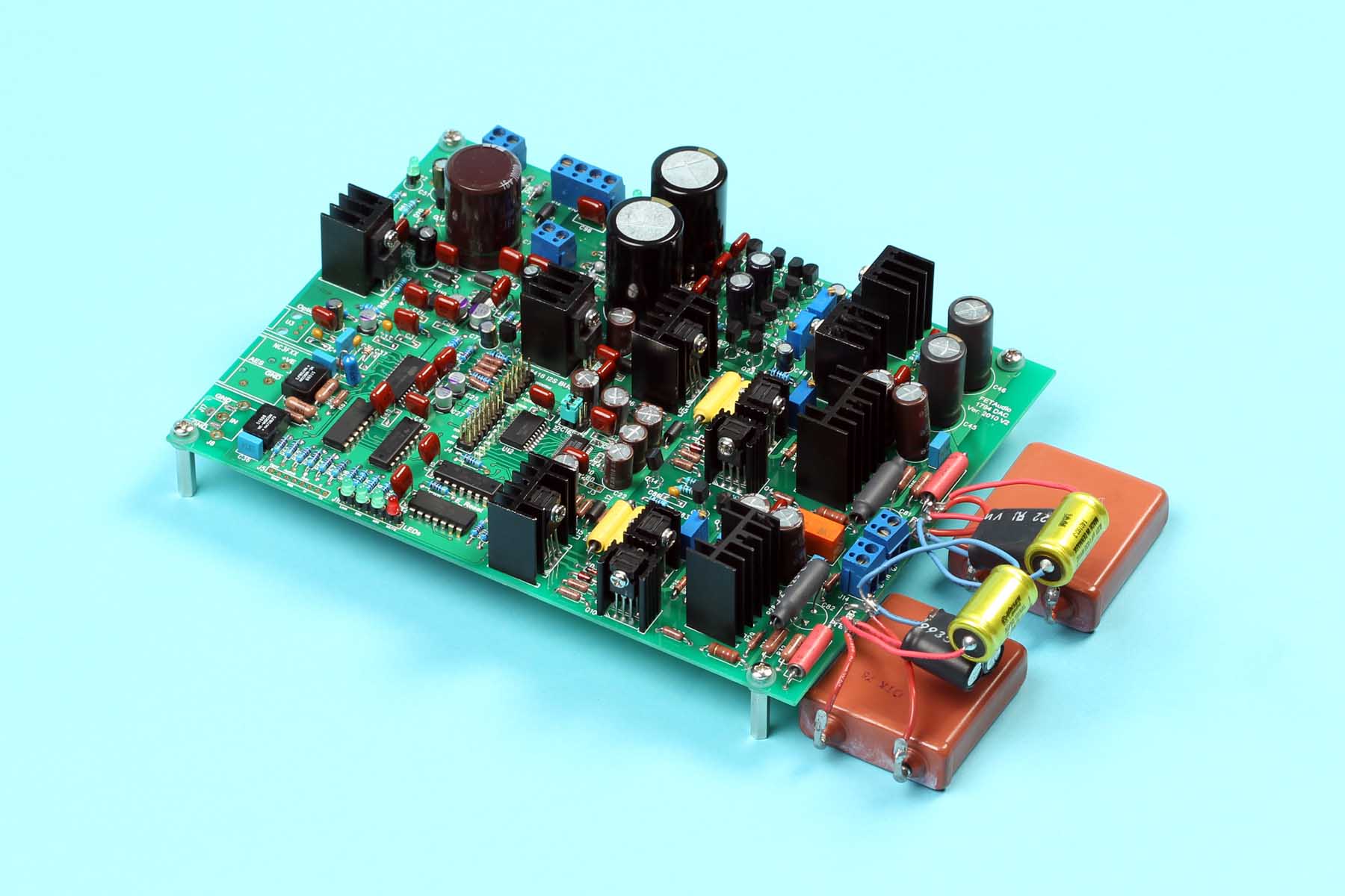

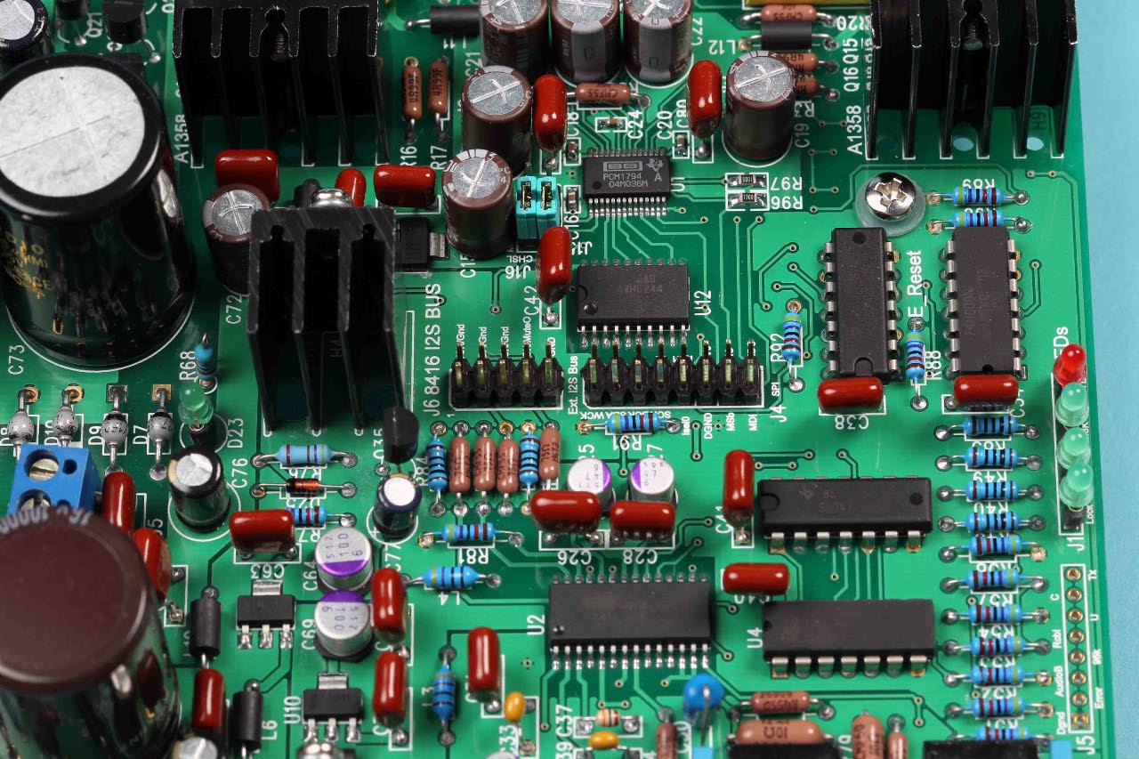

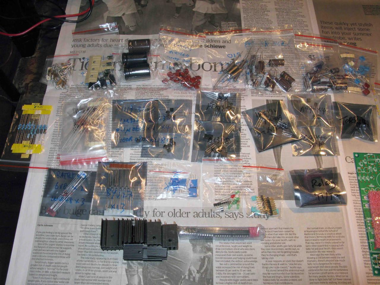

I was looking for a DAC to replace my current DAC which I bought many years ago. It uses a Yamaha YM3623B chip feeding two PCM63s. The analog section is of a tube design using 2 6DJ8/6922. I felt that although it was sweet, it lacked transparency and clarity and tube rolling was incredibly expensive!
I have never put a kit together, let alone a DAC. Anyway, due to cost and wanting to get my hands ‘dirty’ I began looking for one. I read here that the DAC Chip is largely responsible for sound quality in a properly designed DAC. After some further research, I came to the conclusion that the TI PCM1794A chip may be the best chip out there. I began searching and stumbled upon a site called Fetaudio that just released a PCM1794A DAC in kit form. After an email inquiry I decided to give this a try. It appears that the DAC is decked out with audio grade parts and uses a discrete transistor IV analog output. To top it all up, Fetaudio is in Hong Kong, where I live. I thought if all else fails, I can at least make a trip to the company and have the kit fixed!
Anyway, after working on it for two full days, I got the DAC to work. However, that was not before some troubleshooting. I must commend Spencer, the owner of Fetaudio as he was always very thoughtful and prompt in his replies to questions. When the left channel didn’t work, he helped me trouble shoot. He asked me to take some MM readings and suggested, before anything else, that the issue might be a dry solder joint and asked me to touch up the left channel IV solder joints. That seemed to solve the problem and the DAC has been singing for about 2 weeks without any problems.
The experience has been very rewarding as the feeling of being able to put something together for the first time that works is indescribable. It is like winning a lottery!
Anyway, Spencer continued to keep tabs on my progress and sent me 4 Silmic 2 100uf caps with instructions on how to create a pair of bi-polar caps to upgrade the original Panasonic ones used for output decoupling. I also got 2 Russian 10uf boxed caps from him. I had a few Jensen 0.01uf PIO lying around and I put these in too.
I must say the improvement in clarity, transparency and musicality was stunning. It blew my old tube DAC away by a wide margin. For those thinking of trying out this DAC, don’t waste time on the Panasonics output decoupling, go for the SiImics BP. They give a more neutral and defined mid and high. Bass is also deeper and lower. If you can, try out the Jensen's too.
Although the DAC was not cheap compared to those on ebay, it does sound incredible.
BTW, Spencer offered to solder all the SMD parts, including the CS8416 and PCM1794. I think that was fantastic as I wouldn’t have been able to manage them. The parts are tiny and the pins are well, microscopic….. I think I would need to be a surgeon to manage that!
I must say I am surprised that even a first timer like me can do this. I never thought I could. Anyway I did and the DAC sounds like a million dollars. It is open, clear, dynamic and musical. With the Jensen’s, I think the overall sound is best as it smoothens out some of the edgyness in the highs and adds a touch ‘Jensen’ mellowness too. I am very happy with the DAC.
What next? Well, I can hook up another DAC to create a true full balanced DAC. There are some jumpers to set to configure the boards to mono L and R mode. This will double the analog output voltage which should improve performance even further. As my pre amp and power amp are balanced too, I ordered and have received a second kit. I am working on this right now and things are getting exciting. Apart from inhaling some more flux smoke (and more sleep deprivation), this DIY business is very exciting and fun and yes, I expect it to get 100% infectious!! I have to be careful.

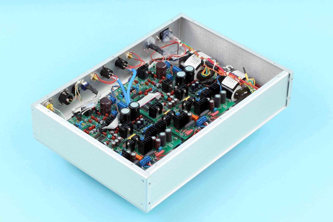

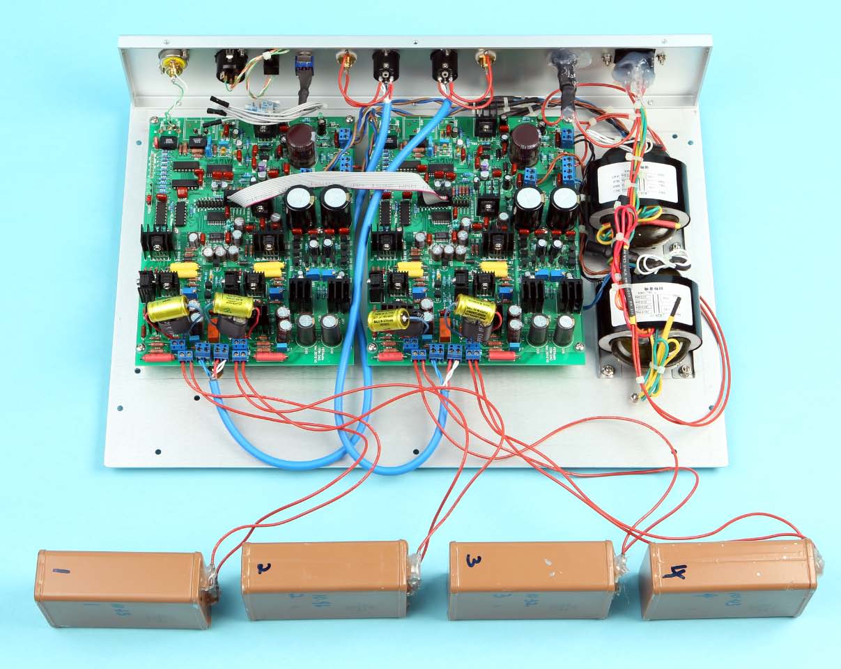

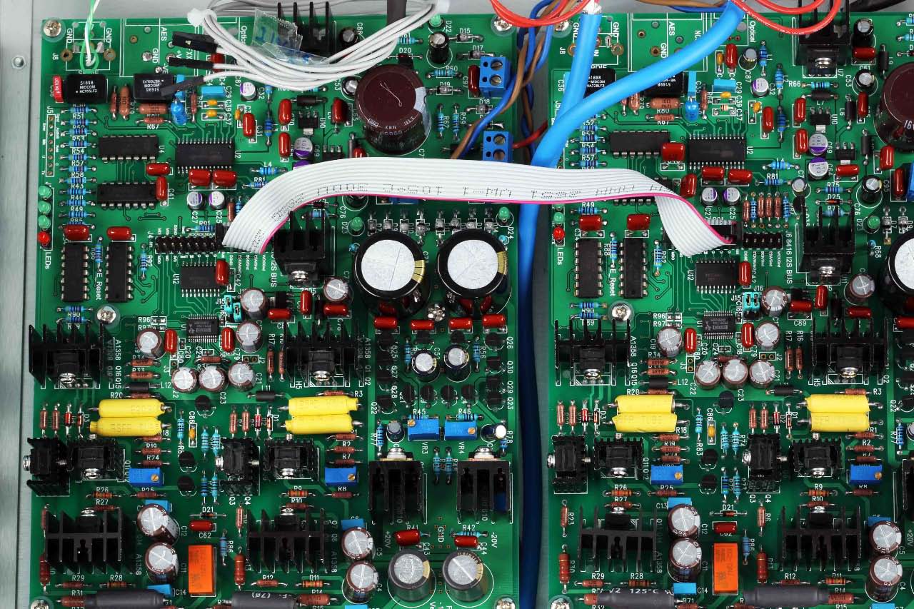

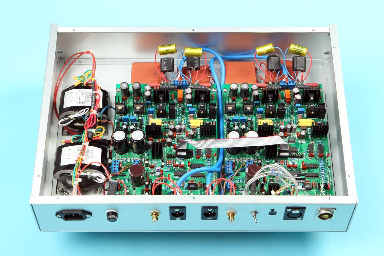

As I mentioned in my initial post, after completing the first DAC, I proceeded to kit out the second so that I can run them in Balanced Mode using a digital I2S interface cable and configuring each board to mono L and R modes.
According to the 1794A specification sheet, the dynamic range in mono mode improves from 127db to 132db. In addition, Fetaudio’s manual lists other benefits, but the most important of all (to me, at least) is that sound quality will improve significantly. There were actually two choices available for the upgrade. I took the more expensive route by getting another full board. There was a cheaper alternative, which is offered as standard, which does away with the digital receiver section - Fetaudio calls this Slave Board. My logic was if this upgrade didn’t go according to plan, I can always run them as two DACs!! However, I don’t see why I would need two DACs but in DIY, logic often gets over-ridden!!!
Anyway, I must say I am very pleased that I managed to kit the second board without any problems and it worked beautifully right out of the gate. I was very careful with soldering to avoid dry joints. Yippie ….. What a relief! I finished assembly in about a day and the half, half a day faster! No bad, eh…. After all, this is my second ever DIY kit project!

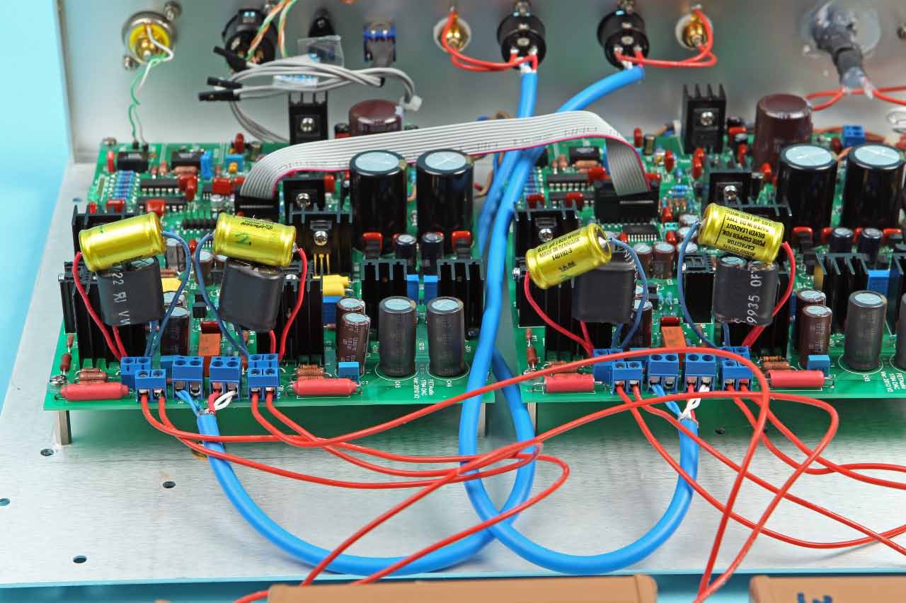

The additional item to make was the I2S cable. This is actually a flat computer cable (10 wires, I think) with a 5 * 2 pin on the one side and a 8 * 2 pin on the other. This was easy to make despite not having a dedicated crimping tool. I just laid the connectors with the wires on the floor and pressed them in with the flat surface of one of my wrenches! Ha ha…. A very high tech solution to a high tech problem!
Fetaudio’s also sent me information on how to connect the analog outputs of both the boards in XLR Balanced mode.
I also bought another transformer. Although I could have used the same one, it just didn’t seem right. I thought I’d go all the way; Full Balanced ‘independent’ mode, period! No excuses if it doesn’t sound right.
Spencer was kind enough to make me an input selector switch, which is really great of him. This allows me to switch between the three digital inputs available, coaxial, optical and AES. I tried the optical and coaxial but I don’t have any source with an AES output.
Anyway, I got the Silmics BP and Russian MBO 10uf from him too.
So enough of this construction talk … how does it sound?

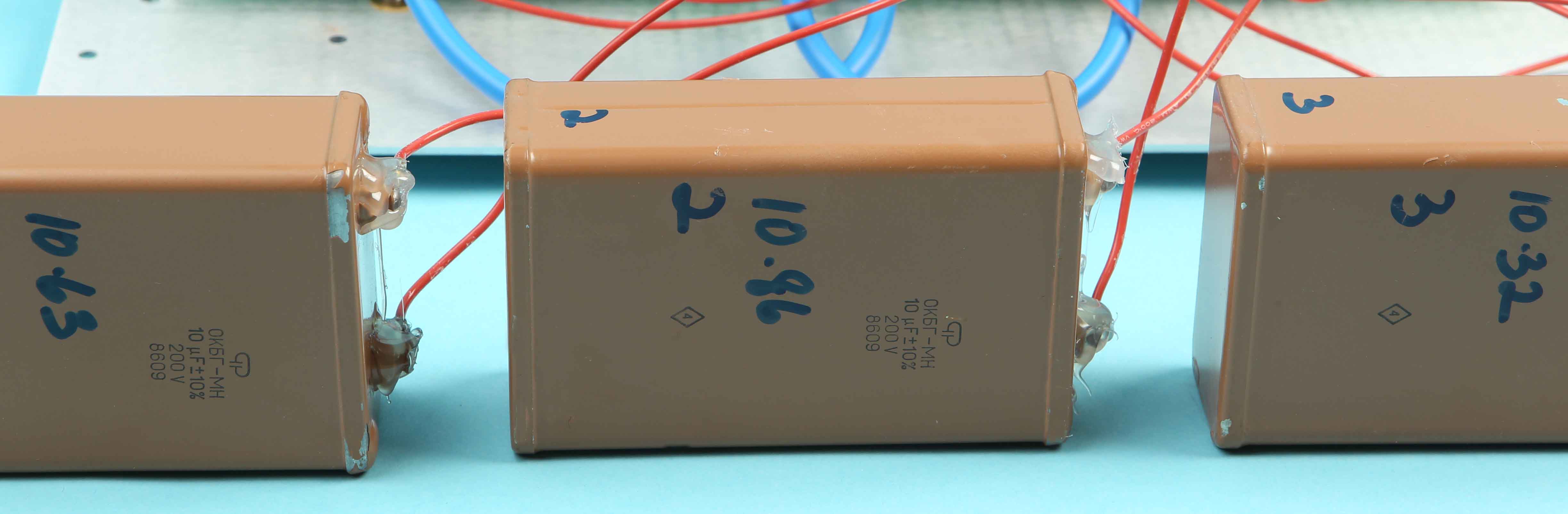

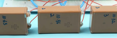

Hmmm…. In a word, FANTASTIC! From the onset, the Stereo SE version was already very good; sweet, clear, detailed and dynamic. In Balanced mode, the performance was ‘out of this world’. It felt like the hidden latent power of the DAC is unleashed with a vengence! The soundstage expanded way beyond the confines of my speakers. The height and depth of the soundstage improved significantly and the 3D effect became 4D, ha ha. At the same time, the music was dynamic and very life like. It was remarkable, and frankly, I am still a little stunned. I think I got a bigger bump moving from SE to Balanced Mode than from my previous (now in deep storage!!) tube output DAC to SE!
Of course, I had hours of fun playing with the output capacitors. The Silmics BP were good and the Russian MBOs from Fetaudio were excellent. However, I began thinking of what I can do to improve the sound even further and match it more to my taste in music, which are mainly vocals. I had some Russian 10uf KBG (as opposed to KGB!) so I decided to try them out as bypass for the ‘standard’ Silmic BP. I also put in my Jensens PIO 0.01uf. Wow ….. This combination actually blew all others away by a mile! This is by far the most natural sound I have ever heard!
