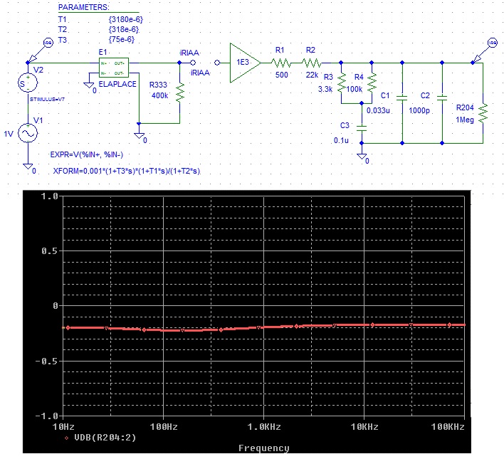

Any chance to publish the actual RIAA characteristic? 🙂
If you use crap parts you would have crap results, of course.
Using good commercial parts of values as noted, the accuracy is OK. Better than OK. Very-very good. Within 0.026dB of the prescribed time constants.
I have assumed that a cathode follower is 500 Ohms out, a grid is infinite, and the tubes are flat over the audio band (no 300Meg gridstopper).
