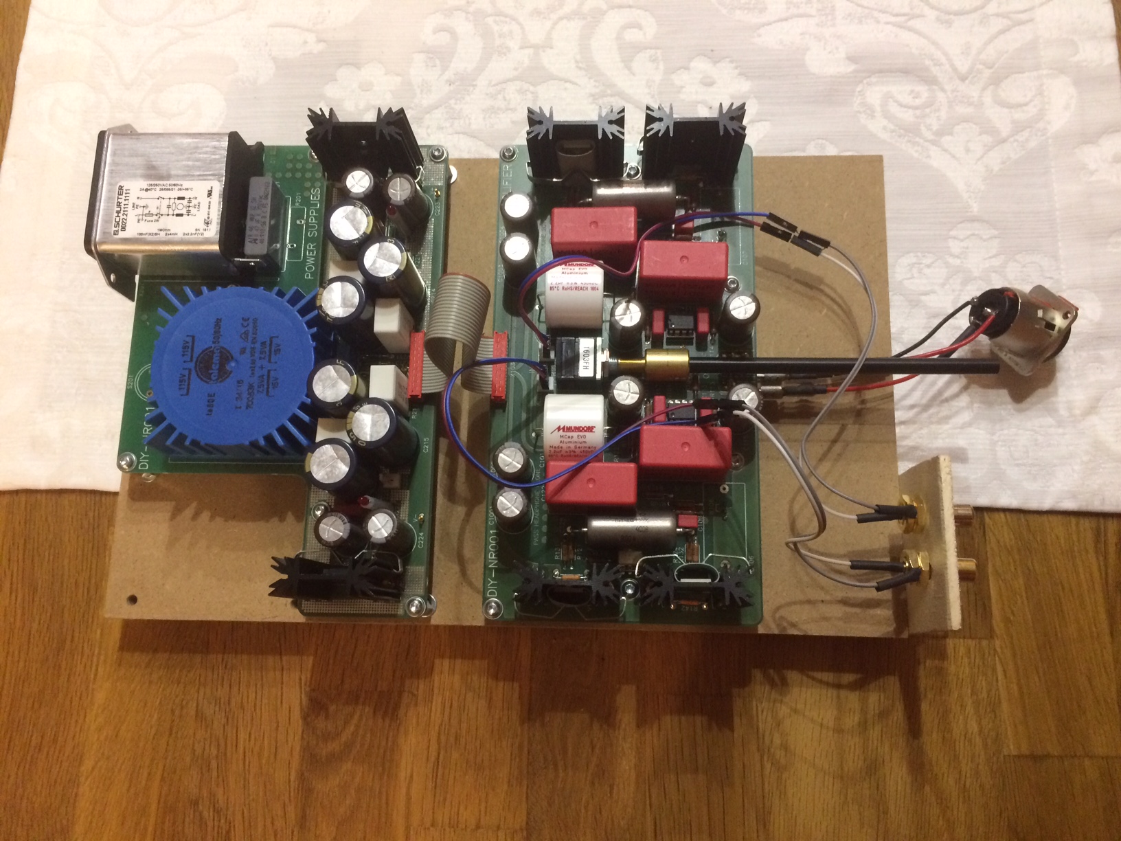

230ohms of primary resistance should allow an T500mA fuse to survive many cold restarts.230 Ohm primary and 6 Ohms secondary with 230V and 15VA.
2A blows! Will check without main filter...
JP
That T500mA fuse suits any toroid of 35VA or less.
It should NOT blow a T2A fuse which is far too big for a 15VA transformer.

@AndrewT thanks.
I´ll start tomorrow with investigation. I know that 2AT is far too big (100mAT recommended by Talema).

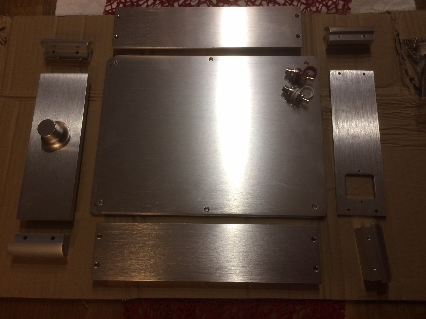

I´ll use this one.
100% Aluminium DIY Box / Case Round Corners 272x212x60mm Silver - Audiophonics

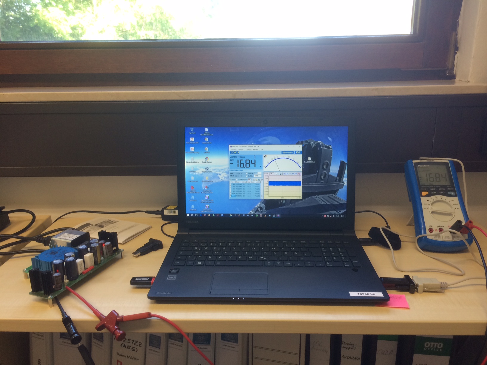

100mAT and no blow, no problem after several on/off! Perhaps after one week self healed X2 filter capacitors?
LED not selected: V- = -16.86VDC and V+ = +16.95VDC without load.

First listening, sounds really good!
Some balancing problems (or my age)?
Tomorrow, measurements.

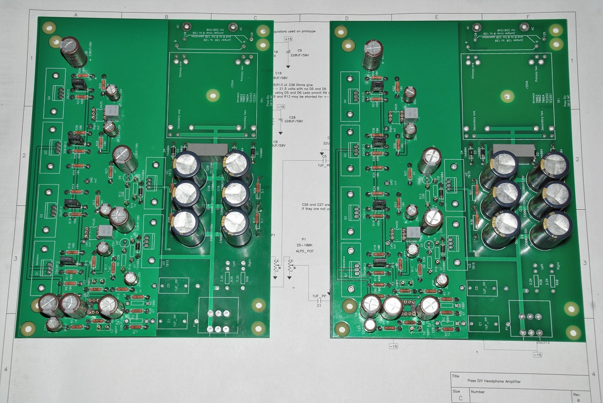

I did what I proposed. Changing all 22uF caps to bipolars is a significant improvement alltogether with using MKP1837 Vishay at bias circuit.
I just fired up the audio precision and measured some 20-22uf caps for distortion. The THD VS Level curves look similar but if you look at the spectrum you see the bipolars are about 3 dB lower second harmonic. I think Bob Cordell found something similar if remember correctly.
