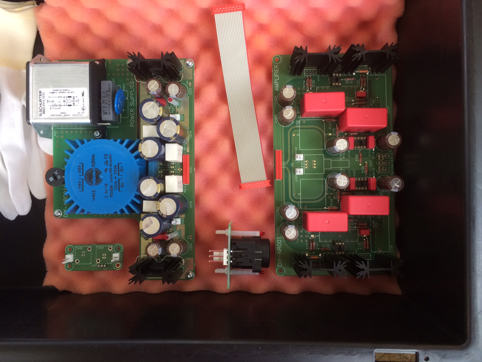

Could someone measure the primary and secondary DC resistance of the TALEMA PCB toroid transformer?
I´ve about 6 ohm for one secondary?
JP
JP
Regulators are FP type.
Mosfet becomes a condom, ordered for 2 hours.
Have big problems with inrush current: Toroidal death or filter cmc + toroidal blows 2A slow bow fuse!
JP
JP
2 amp slow blow should work fine. I measured my secondaries at 4-6 Ohms depending on transformer VA.
230 Ohm primary and 6 Ohms secondary with 230V and 15VA.
2A blows! Will check without main filter...
JP
JP
I have 2x 25VA Talema and 0.5A slow blow for my F5-HA.
Never have had a problem.
So something else wrong.
Patrick
Patrick
Hello Patrick,
do you use in your F5-HA main filter with CMC?
My Schurter main filter includes an 2x4mH CMC; main filter checked ok (removing middle point connexion of toroidal 230v side) with 2A SB fuse.
As always, I think something really stupid is going on (perhaps wrong fuse? Ordered new ones).
JP
JP
