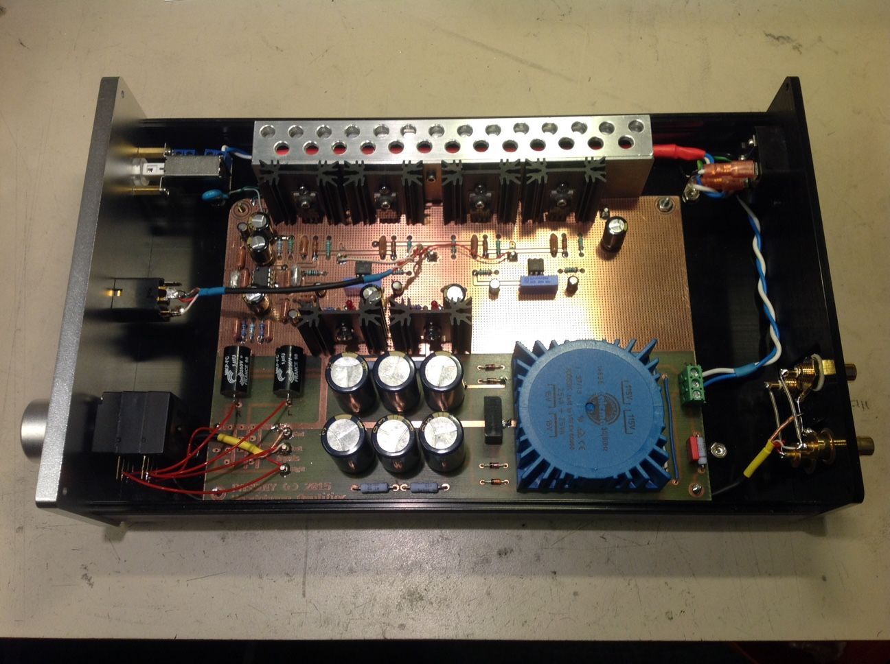

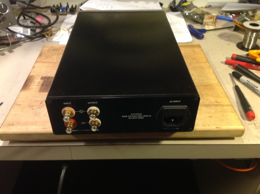

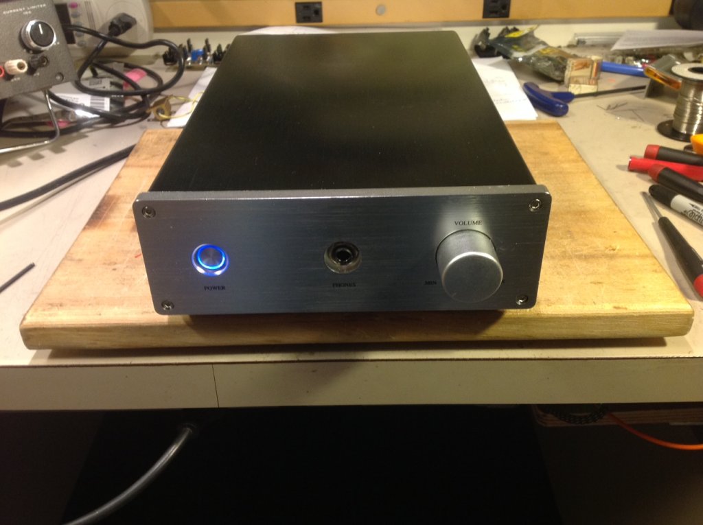

Chassis completed. Working fine. First listening, very direct sound, fast, but analytic, It is not a forgiving amp so far.
Now time for some burning 😉 Tried it with AKG702 & Sennheiser HD600.
You can see a little heatsink was added just in case, but the standard heatsinks seem to be fine for 112ma bias...
Noble volume pot, Mogami internal wires, Vishay CFM55 resistors in the signal path, Solen MKP 1uF coupling cap, Panasonic FC electrolytic. Nothing fancy really...
BTW I'm using not K2013/J313 but FKP3P20/FKP4N20 Mosfet
SB
SB
