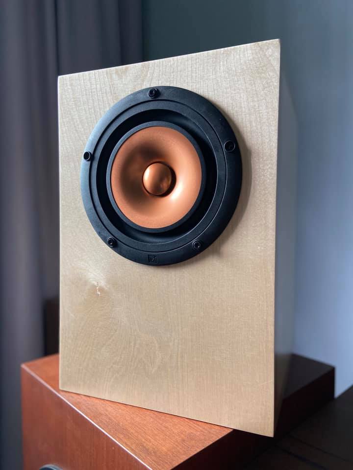

Hi All! I've just had a Mark Audio Alpair 11MS Nostromo built, with slight adjustments. Its my first proper Full range speaker, currently running them in, without damping material. I must say, they do vocals and acoustic instruments very naturally well! Not sure what damping material to use, will probably add some polyester to taste, hehe!

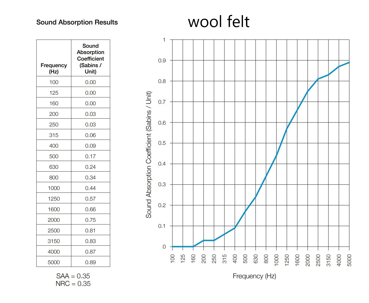

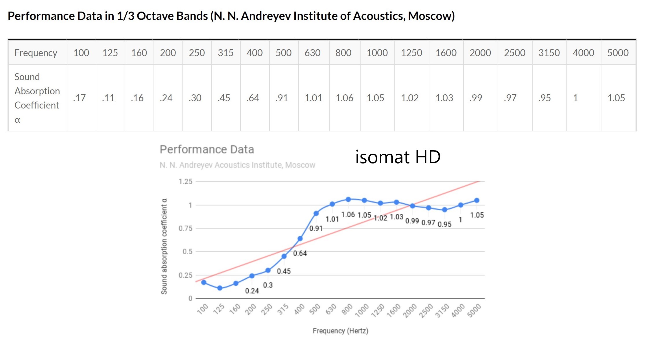

hope everyone is well. I'm facing a great hurdle on my fhxl build due to the unavalabilty of wool felt in south india. trying to find an alternative seems to be very difficult. hence i need your suggestion on something i found.
its called nankarrow isomat-hd.
i cross-checked the sound absoption coefficient (SAC) of wool felt to the SAC of isomat and it looked like a good match. in fact the isomat hd has better SAC values when it comes to mid-range frequencies. but I'm unsure if just the SAC alone is the deciding factor behind choosing a felt for cabinet inner lining.
i will post SAC data for both wool and isomat HD here.

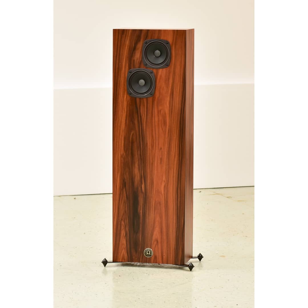

Hi scott, are there any, or can you make a design with two ms11's per side? Very happy with the nostromo's, but cant stop wondering what 2 times the ms 11 will do per side. That will give the same square suraface area as a 8,5" driver. I really dig the omega loudspeaker desigs with 2 x full range on a wide baffle.
