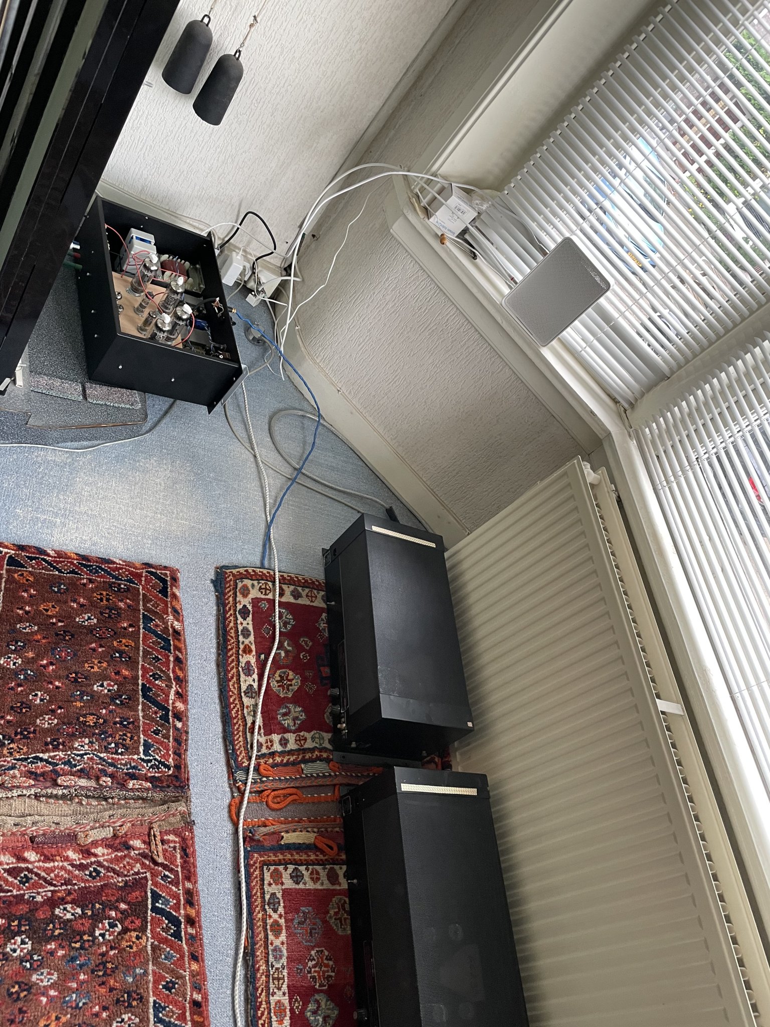

I have been trough mine, both electronics and cabinet stiffeness modification. I actually glued an extra panel 6mm Birch Plywood on top of the original panel, i used visco elastic glue made to dampen vibrations DG-A2
Hi cvanc,
I have build new amps for my set in 2007 with great succes…I also did this for my Acoustats a year earlier…
these amps are still in use on a daily basis.
just make sure you order seperate transformers for each voltage to prevent isolation issues, and it is cheaper too.

Do not!! follow instructions for sliding the panel out as in Model 3. The 2SW panels are screwed in place to a wooden frame from the rear of the cabinet.Congratulations on the Beveridges
Still amazing speakers after all these years. I have Model IIIs that I have modified to run with pure tube direct drive amps
While the electrostatic elements are fragile with careful handling they will slide out and should be vacuumed. I know that Rick Beveridge used compressed air - I would be careful to avoid that. You likely have lots of remnants from the foam grilles in the stators.
The aluminized film should not be peeling and you should not be able to see straight through it. Otherwise it cannot be tensioned with heat if it is sagging. It should be ok.
The stator elements will be very brittle.. be careful . there may be some missing. This was likely done at the factory as they were pulled from molds or if there were hot spots
The amps will have to be completely serviced with new sockets and new components. The transformer is a weak link but hopefully you are lucky.

Start with the amplifier, if already not done so (the 12" woofers are your last worry). Most problems occur with the power trafo - it dries out over the years. Check it still works - if not, there are alternatives. Second - the tubes. They are old, but there are alternatives. Get the amp to work properly first (there could be other amp components that failed). You can then place speakers on top and try them out. If they play at equal level, you're in luck. If not, swap the speakers on the amps and check if the lower level sound moves with the swap. If it does, the speaker is the culprit. If it doesn't, the amp is the culprit which means more amp troubleshooting. Apply EQUAL repairs to both amps, whether required in both or not.
Warning!! - working on the amp implies that you know what you are doing. Fatal voltage inside - +/-3200V. So be careful.
The back of the speaker can be taken off. Inspect the 3 transducers, the aluminzed membrane (use a flashlight) through the tines of the stators). Hopefully, they are stretched and nice.
