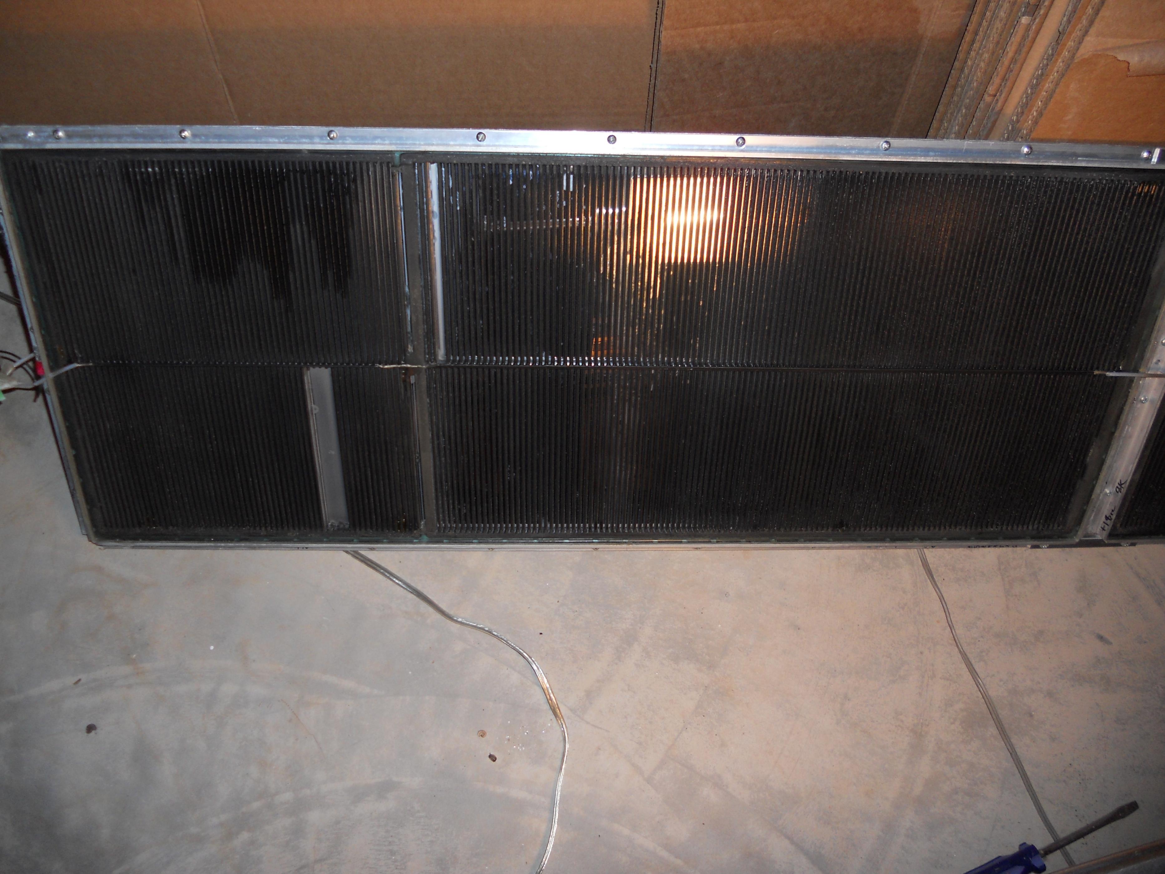

While the electrostatic elements are fragile with careful handling they will slide out and should be vacuumed. I know that Rick Beveridge used compressed air - I would be careful to avoid that. You likely have lots of remnants from the foam grilles in the stators.
The aluminized film should not be peeling and you should not be able to see straight through it. Otherwise it cannot be tensioned with heat if it is sagging. It should be ok.
The stator elements will be very brittle.. be careful . there may be some missing. This was likely done at the factory as they were pulled from molds or if there were hot spots

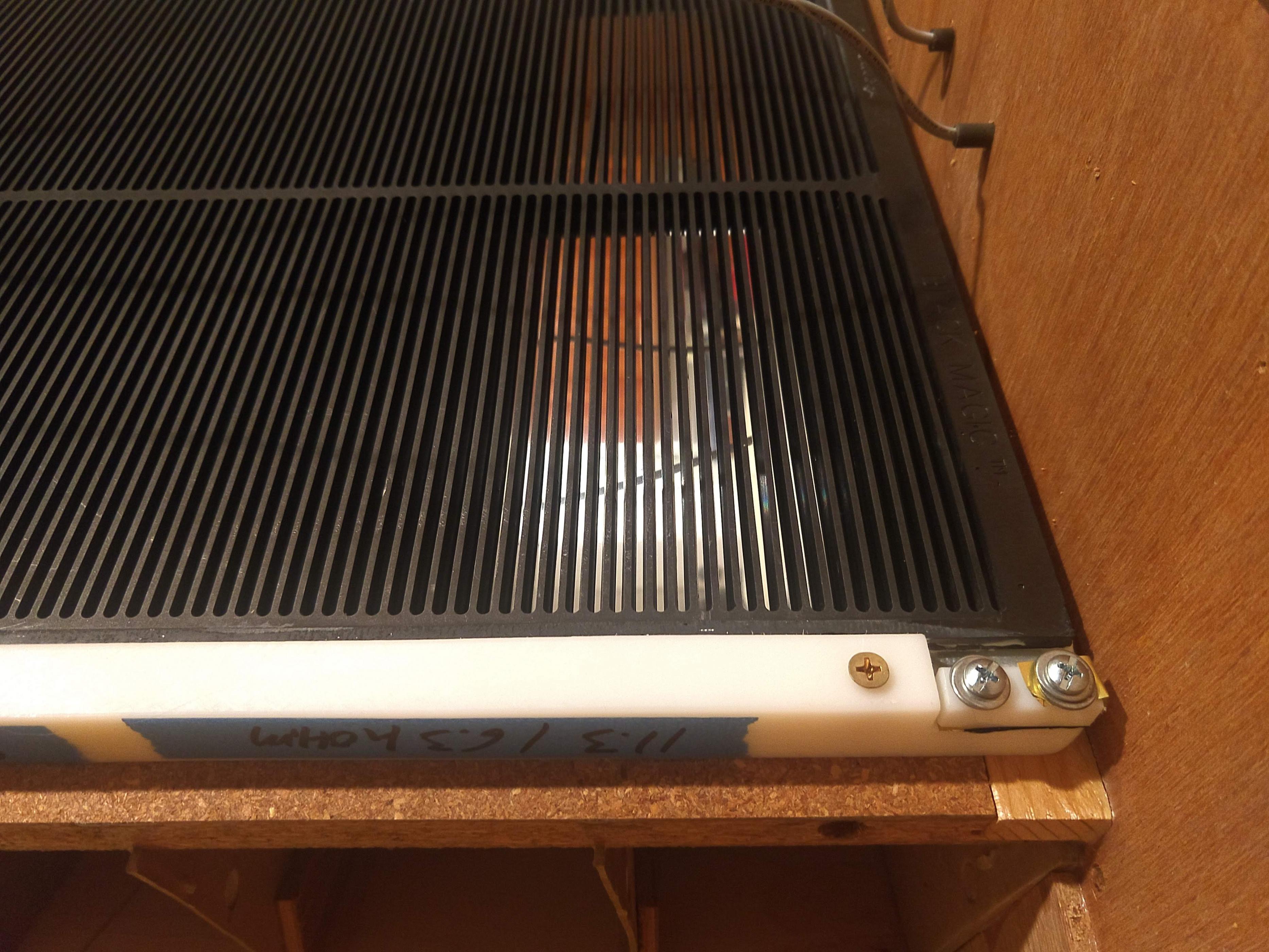

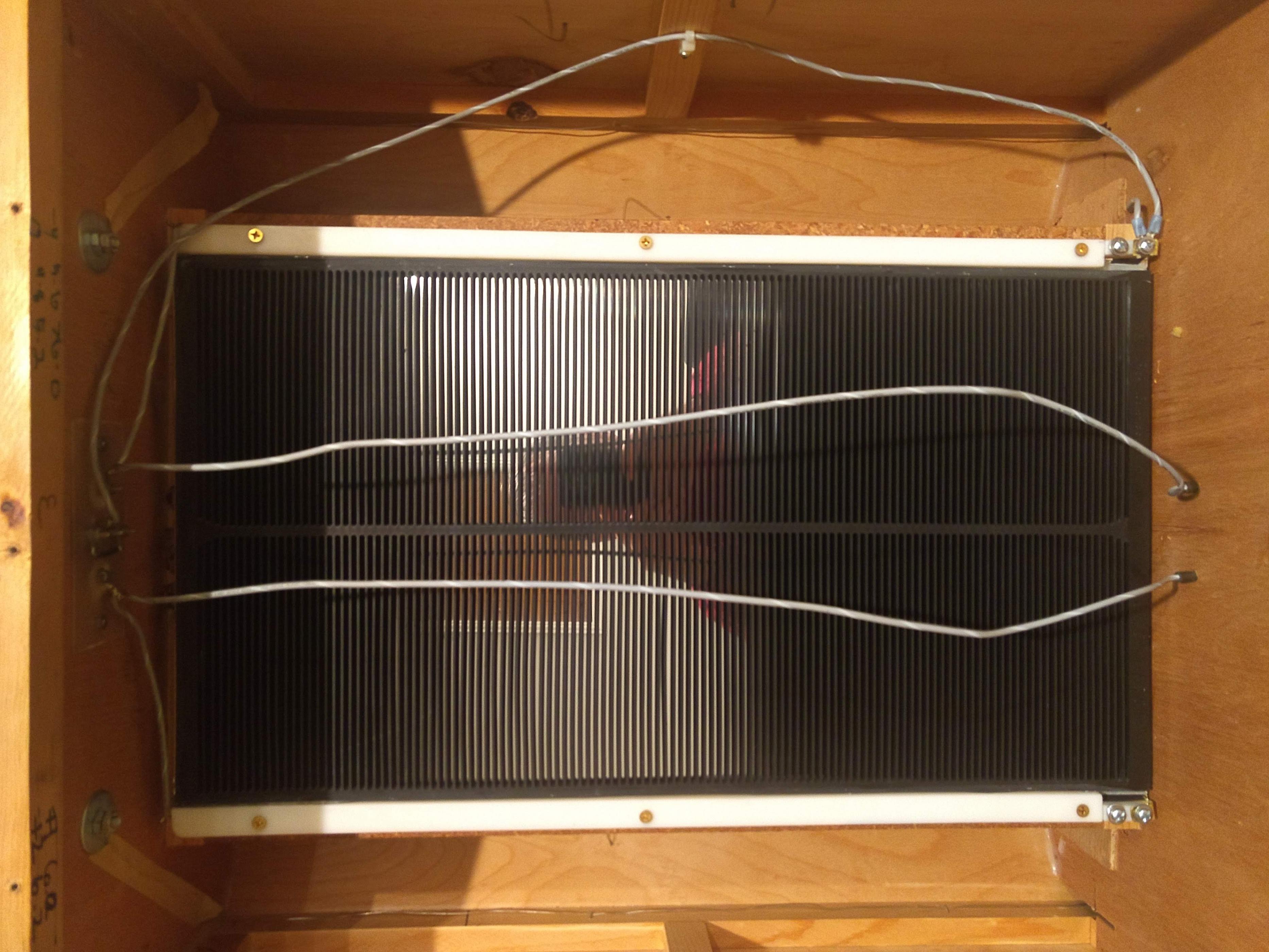

Do not!! follow instructions for sliding the panel out as in Model 3. The 2SW panels are screwed in place to a wooden frame from the rear of the cabinet.
Start with the amplifier, if already not done so (the 12" woofers are your last worry). Most problems occur with the power trafo - it dries out over the years. Check it still works - if not, there are alternatives. Second - the tubes. They are old, but there are alternatives. Get the amp to work properly first (there could be other amp components that failed). You can then place speakers on top and try them out. If they play at equal level, you're in luck. If not, swap the speakers on the amps and check if the lower level sound moves with the swap. If it does, the speaker is the culprit. If it doesn't, the amp is the culprit which means more amp troubleshooting. Apply EQUAL repairs to both amps, whether required in both or not.
Warning!! - working on the amp implies that you know what you are doing. Fatal voltage inside - +/-3200V. So be careful.
The back of the speaker can be taken off. Inspect the 3 transducers, the aluminzed membrane (use a flashlight) through the tines of the stators). Hopefully, they are stretched and nice.

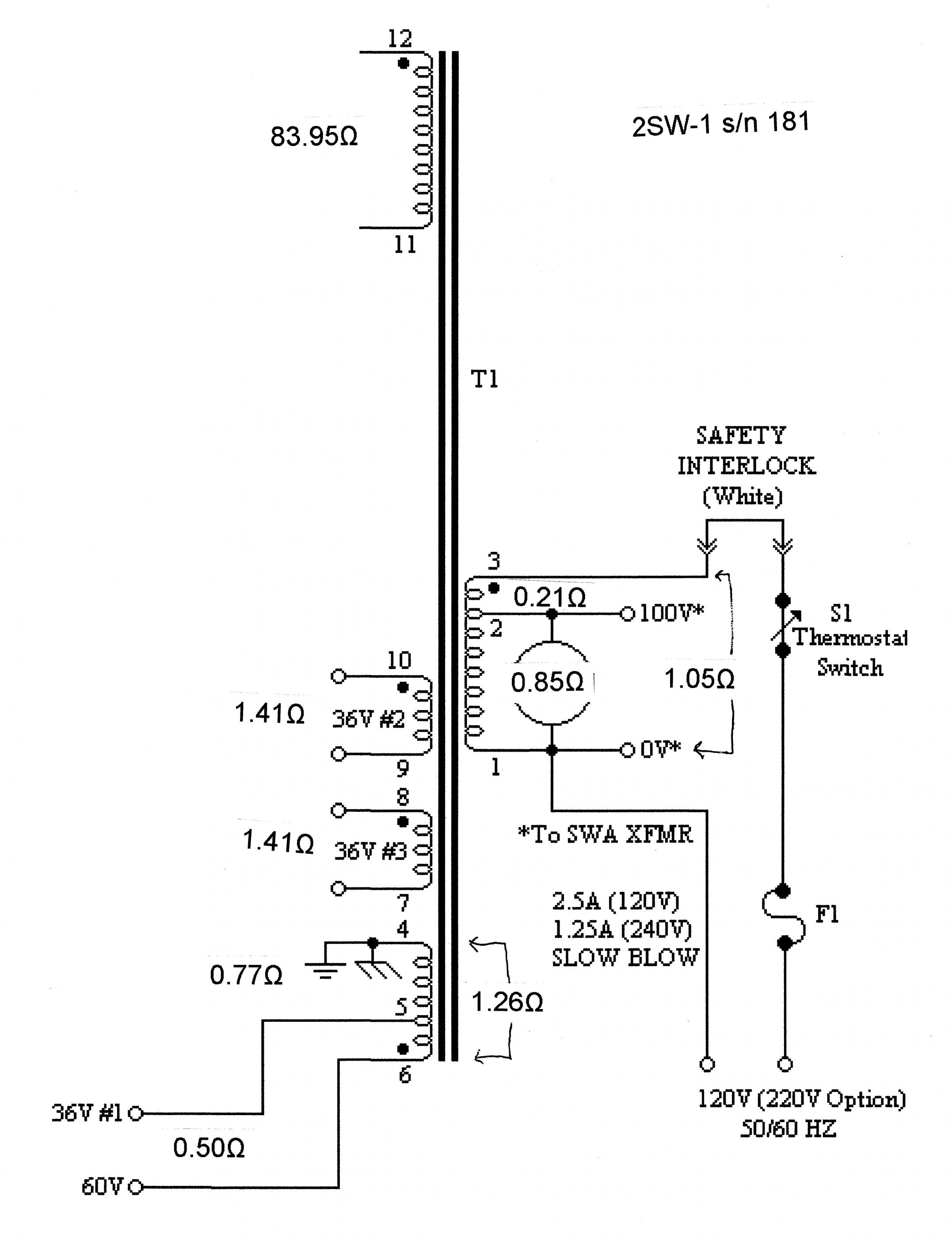

I've lived with these amps long enough to do really hard searches for both transformers and tubes.
For transformers - I've never seen an original one for sale. Aftermarket replacements do not exist but I know they used to as one of my amps has one. The only available repair is to retrofit multiple off the shelf transformers.
For tubes, nothing else works other than 36/40KD6. Not as a drop in replacement anyway. So no, alternatives do not exist. I wish they did!
I personally know people who had luck with both. For tubes there are several options, one may be:
https://www.tubesandmore.com/products/vacuum-tube-36kd6-40kd6-beam-power-amplifier
Just check that pinout match, I think one of the guys (model 2 owner) had to replace the socket, if I recall correctly.
As for trafos, I know an electronic engineer in Chicago who did several new ones, custom-made, for Rick Beveridge (son of). There are a few caps worth replacing too, but that's trivial. However, if your amps do work - leave them alone FTTB (if it ain't dead....).
Another guy switched to stepup trafos + dividing network and uses his own amp, but that's another story - I guess that's not your approach.
