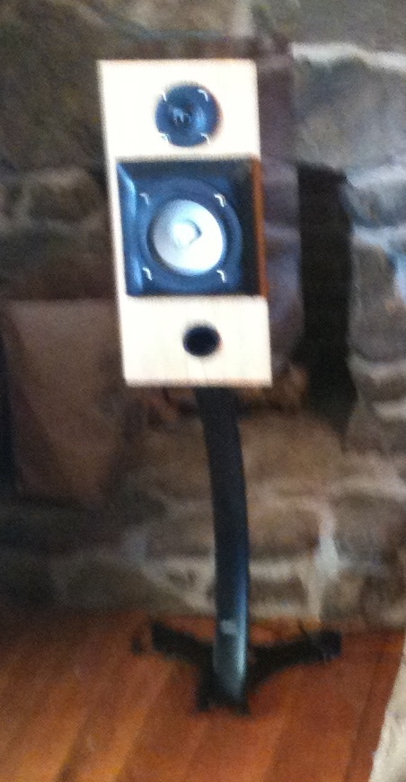

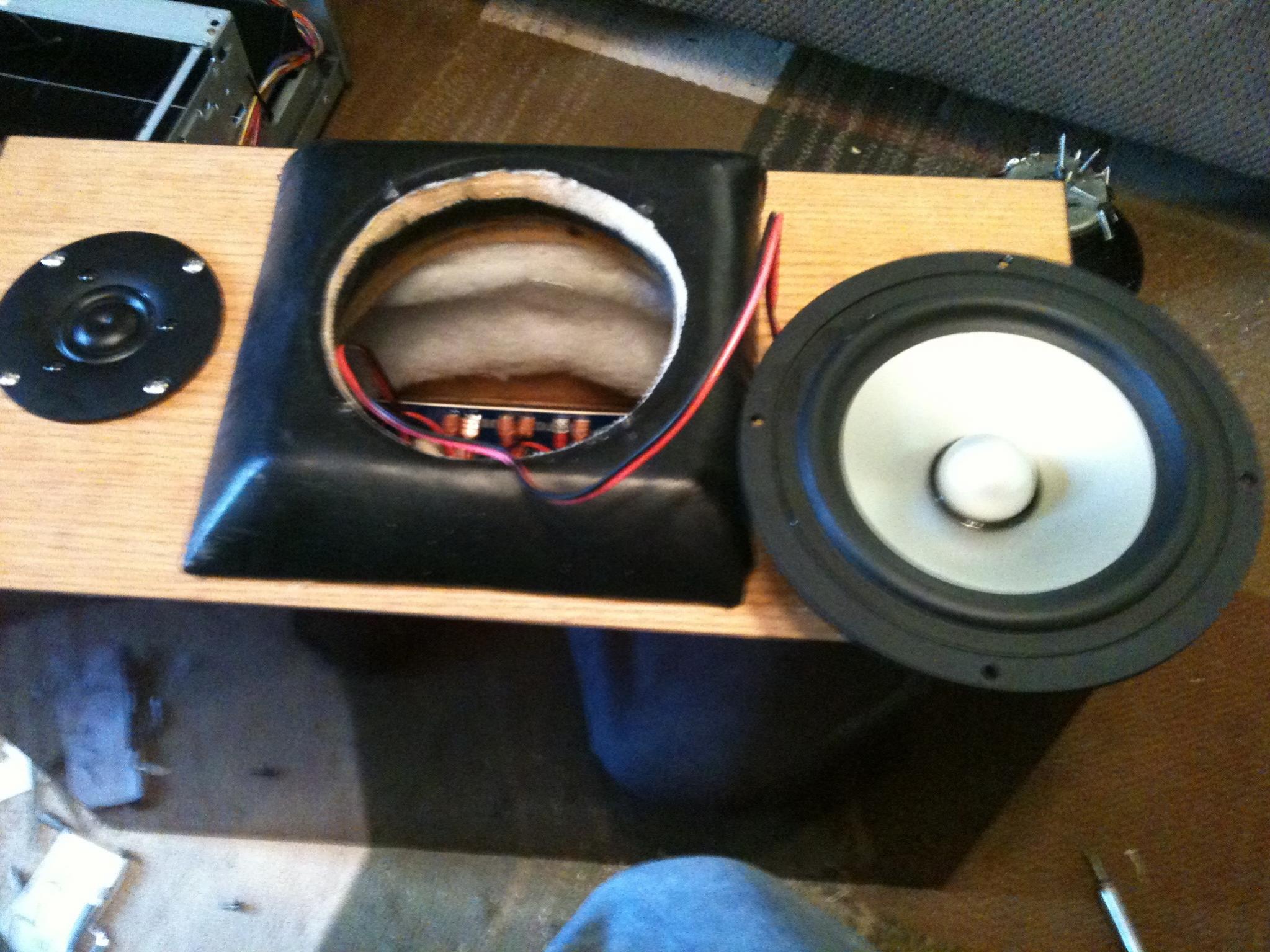

Been meaning to join for awhile. Attached are pictures of my first DIY loudspeakers, As you will see I used the Fountek fw168 6.5 mid woofer with an SB acoustics SB29RDC tweeter. X-over is 2nd order butter with an impedance matcher on the tweeter. I am really impressed by the SB tweeter, it rivals the best of the electrostats that I have heard. The woofer is extended outward to match the voicecoil of the tweeter. Imaging and sound stage are pretty good, I am not sure that I am in love with the aluminum mid woofer, maybe after I break it in I will feel different, it sure is a punchy little fellow. Anyhow take a look at the photos if you want. Happy to share my hobby with you all, not many people understand how fanatical I am about good sound. Garry
