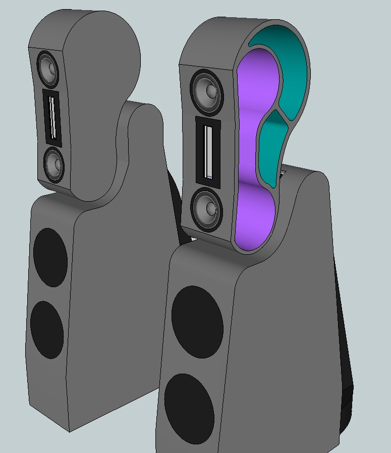

Been away for the last week having a holiday in Queensland. While I was there I spent a bit of time doodling some designs and picking up some more audio equipment.
Might look a bit strange, but the more I think about it the more I like it.

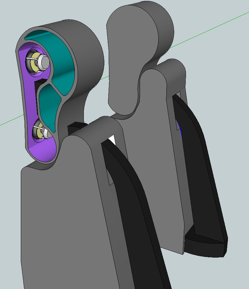

I am looking to isolate the mid and tweeter from the thumping of the bass from the woofer, the stand won't touch the cabinet below.
Still some finishing touches to be done but it's nearly there...

Your pictures look like a really complex cabinet, how are you going to get the curved baffles done?

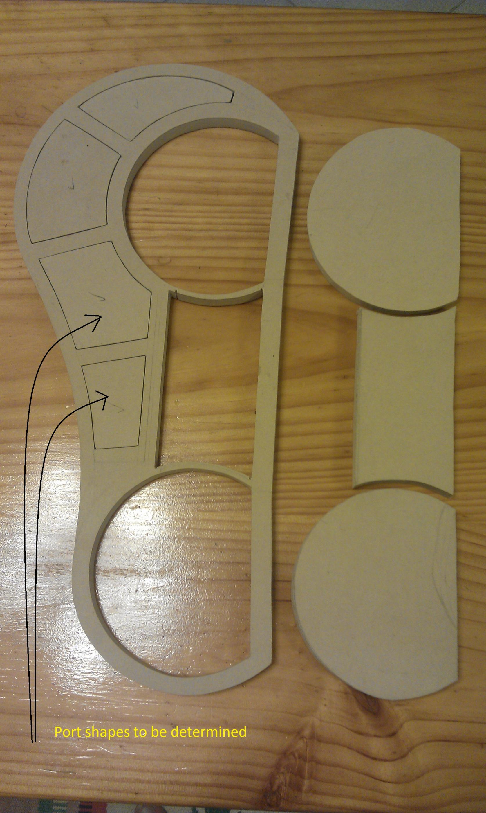

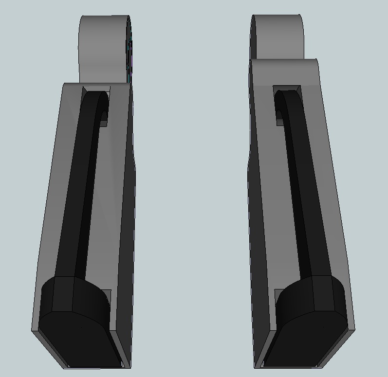

I expect that it will be far easier than it looks... Yes it looks quite complex but could be done with minimal effort.
Imagine a loaf of bread with the slices side by side. My slices will be 25mm MDF stacked width ways and vertical.
Using a router I bought recently I intend to use a couple of templates to shape the cavities. End plates will be the same as the filling without the extra cut outs.
In the top section you can see the actual speaker cavity with some additonal cosmetic cavities to reduce weight and give the outside shape I'm chasing.

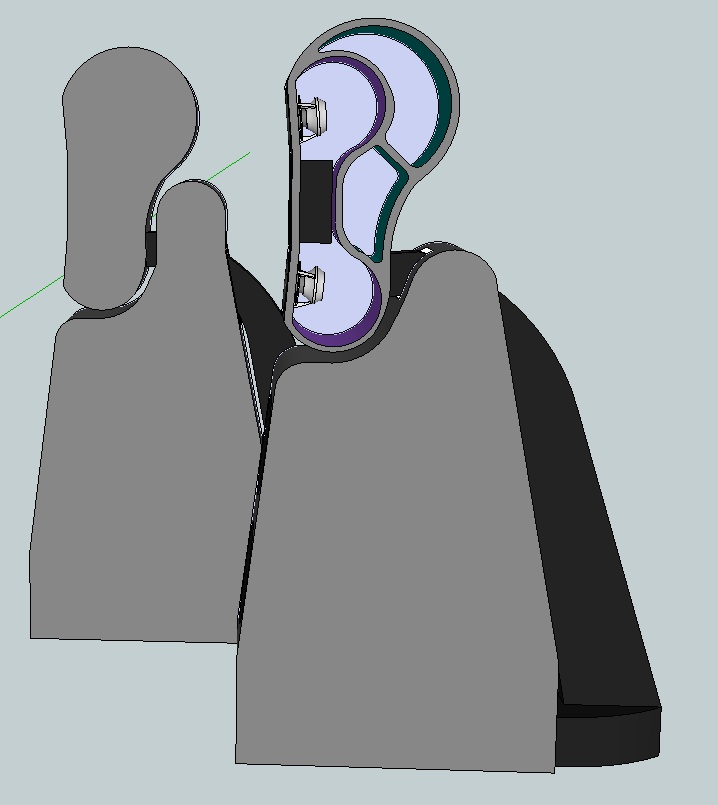

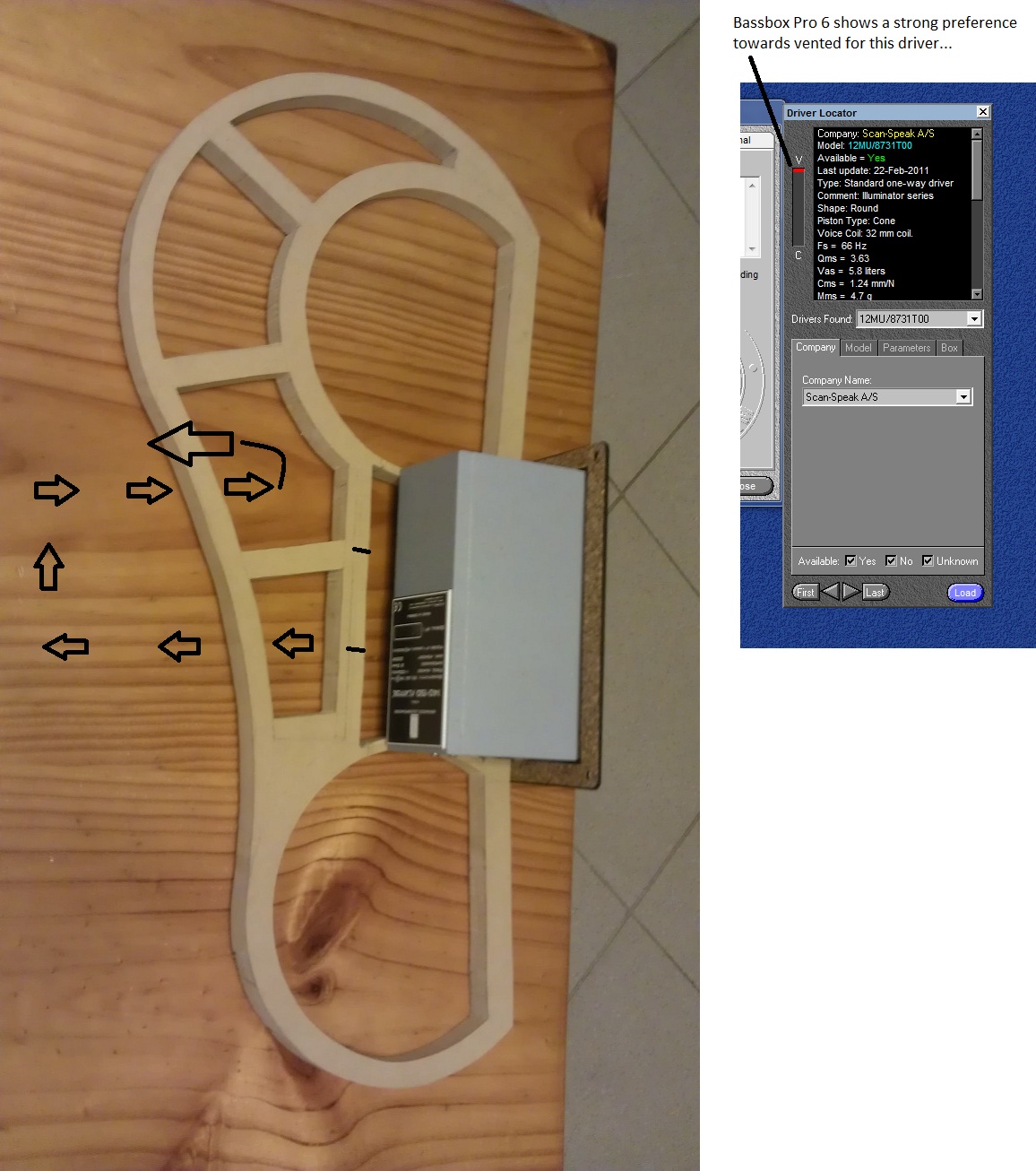

Have been slowly developing the template for my mid / tweeter box. I probably should have given some more thought to the port placement before now, but it isn't terribly hard to change... The cavity shape shown in the photo isn't going to be the final shape.
My question is would it be too detremental if I have the port go the width of the cabinet do a U turn come back and exit via the back of the cabinet?
The two mids will be slightly offset from centre and the tweeter offset the other side of centre, that give me sufficent space between the mids and the side of the cabinet to give it a generous curve.
Between the top and bottom mids there will be a passage like the cone of silence from Get Smart, in the middle of that passage will be the port exit.
The port will run across the back of the speaker cabinet to nearly the end go up and then come back parrallel to the first then exit via the rear of the cabinet.

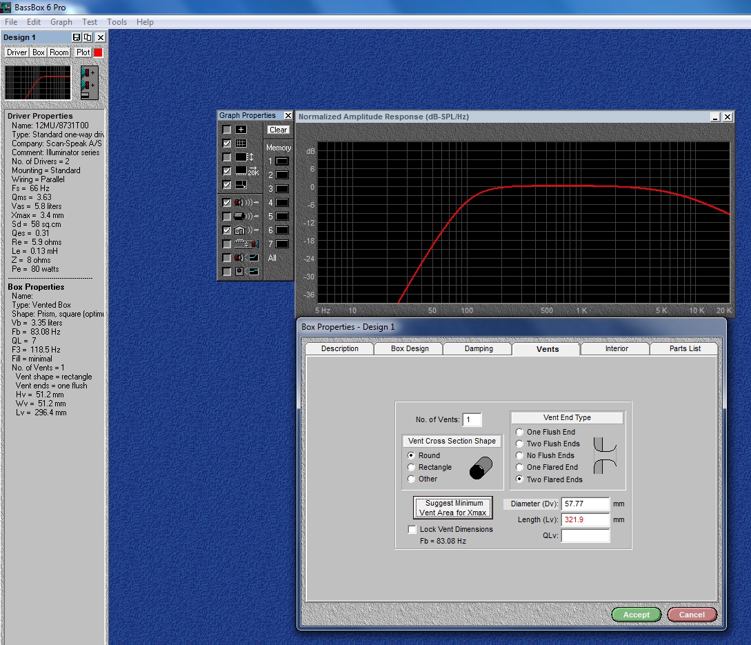

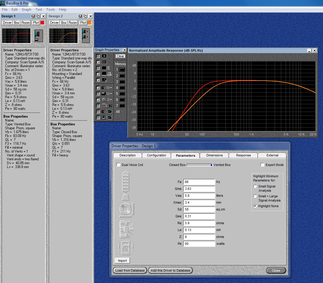

Hi, looks liek an interesting design. Any reason you are porting the midrange? Sealed mids would be better solution in my opinion. Then cross the woofer higher.
Various reasons:
The first is closed requires heavy fill where as vented is minimal and with such a small chamber I don't want the fill falling into the back of the driver if moved around.
I could glue a light fill to the chamber walls and use a better type of fill material like that wave foam.
Vented gives me a bit bigger chamber volume which allows a bit more clearance around the cone.
Scan Speak recommend vented which is based on the driver parameters so best to go with manufacutures recommendations.
My current mids are vented where as the speakers I built before were sealed and I didn't particularly like the sound (granted different drivers)...
The pic shows the response of both, besides the higher crossover point the sealed tapers off more in the lower frequencies.
What I have been reading around 200Hz would be a more ideal crossover into some larger drivers.
Hi, just looking at your design of your upper enclosure maybe consider isolating the RAAL from the mid enclosure so its not subjected to any vibration from the Mids.
Might be possible to do, provided the top and bottom of the tweeter isn’t exposed to the top and bottom cavities (which I got a feeling they might be, but I would question the gain, the Raal is encased in some kind of cast steel on all sides, going off the weight I would guess roughly 6mm thick. Certainly can look at partially isolating it from the mids.
