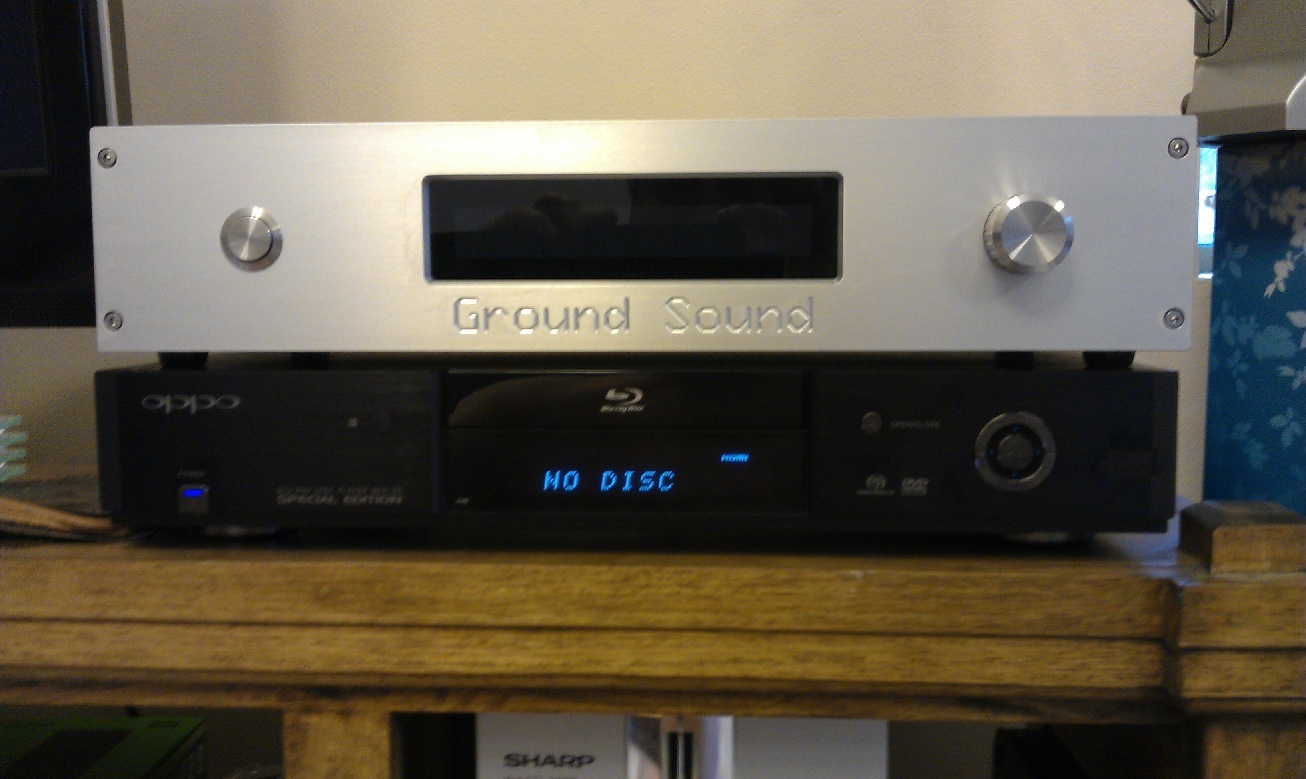

The DCN28 turned up this morning and I quickly unpacked it like a kid on Christmas day to get my first glimpse before heading out the door to go to work. First impressions is that it seems very sturdy and well made, with a well laid out back panel that isn’t cramped.
Robert at Ground Sound has been a real pleasure to deal with and extremely helpful. If the unit performs as well as I expect it will, I would be happy to recommend his product, but let’s hear it first.

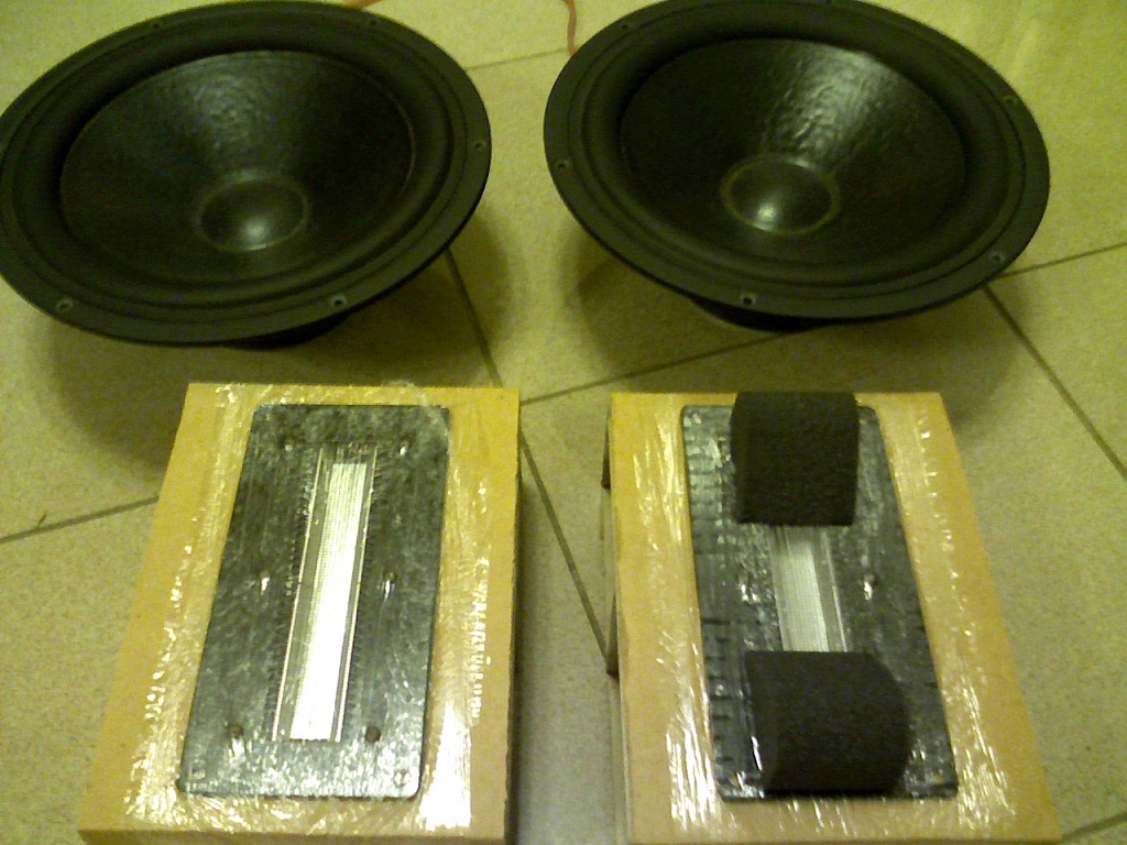

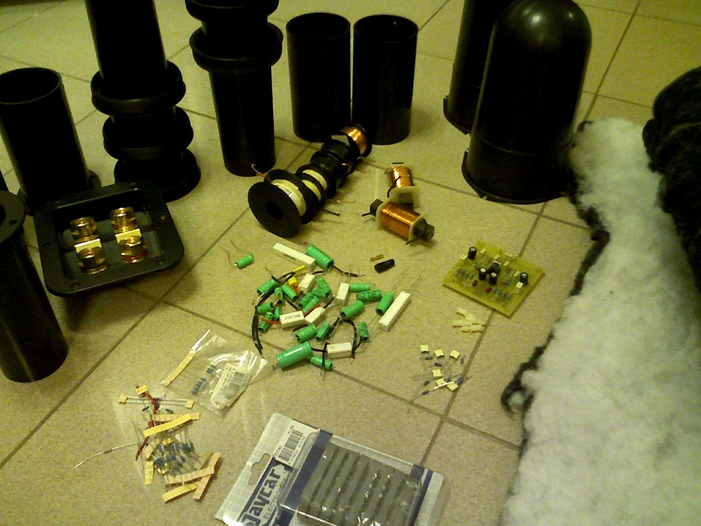

Collected enough parts now I can at least make a start on the speakers...
Found some bits and pieces of left overs in the box where I was keeping the Vifa drivers from the first lot of speakers I built in the 90's and never used.
For the time being I will use the 10" Vifa drivers (M26WR-09-08 - 8ohm) with the Raal tweeters.
Once I get the hang of the digital crossover in 2 way mode. I will start introducing new drivers (not sure what yet) and retire the Vifa 10"'s.

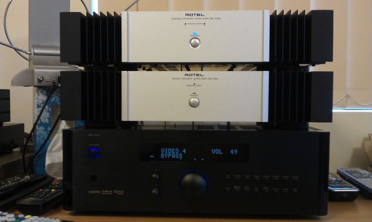

Still missing one channel as the RB-1092 & RB-1091 are only 3 (2 + 1) channels.
I have an anologue 5 channel RMB-1075 in storage about 1000klms aways, but am somewhat reluctant to use it as it isn't of the calibre of the Class D amps.
The suggestions was made that digital amps might be a bit harsh for the tweeters so any suggestions on non digital amps of decent quality for the tweeters?
