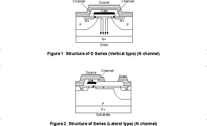

Toshiba doesn't say, but in the US we have a saying, "If it walks like a duck and quacks like a duck, then it is a duck."
Lateral power parts can be distinguished from vertical power parts by the following:
1) Gate threshold voltage is less than 1 volt for lateral parts and over 2 volts for vertical parts.
2) Lateral parts have the source tied to the case, while vertical parts have the drain tied to the case. (For flat plastic cases, the middle lead is tied to the case.)
3) The zero tempco point is well under 1 amp for lateral devices and well over 1 amp for vertical devices.
4) The input capacitance (specifically Crss = Cgd) is much lower for lateral parts than comparable vertical parts.
5) The transconductance is significantly higher for vertical parts than for comparable lateral parts.
The Hitachis are lateral parts, as noted in their literature. The Toshibas are not specified, but can be identified as verticals by the above noted characteristics. The Toshibas are the only vertical MOSFETs that are designed for audio with true complements available.

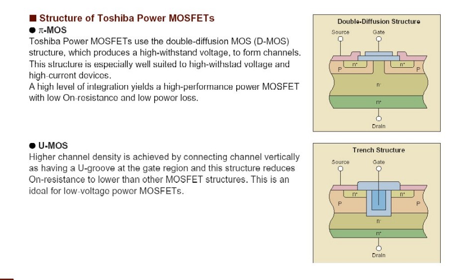

I think I should stop hijacking this thread for lateral FET discussions. So just one last mail for clarity. 2SK1529 is referred to by Toshiba as pi-MOS (see picture).
Their U-MOS looks more like the IRF Mosfets to me.
Patrick

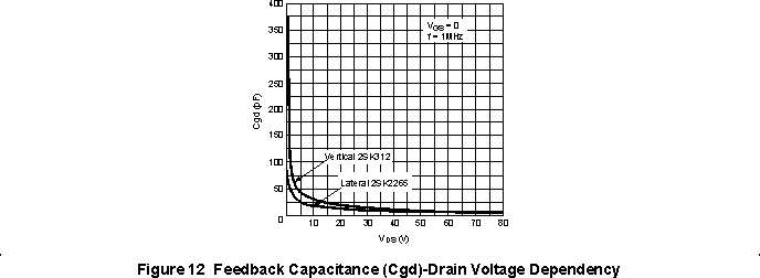

For those of you who are fans of vertical MOSFETs, it may be instructive to look at the figure showing Cgd for the two types of MOSFETs. (Cgd is the important parameter for followers, which are the main circuit used for these devices in audio power amplifiers.)
Note that the capacitance increases by a factor of four for the lateral part between Vds = 10 and Vds = 0. For the vertical part, the capacitance increases by a factor of roughly ten. However this diagram is severely understating the problem, as you will note that the test conditions are Vgs = 0. This, of course, is not how these parts are used.
To get a better idea of how the curves are in real life, you must shift them to the right by the threshold voltage. In the case of the lateral part this is approximately 1 volt, and for the vertical part this is approximately 4 volts.
Now you must ask yourself what happens as Vds continues to 0 volts (as it does when driving the amplifier to full output). In this case the vertical part continues its precipitous rise in Cgd, while the lateral part simply levels off with no further increase in Cgd. So in real life the non-linearity in Cgd is about 10x worse for vertical parts.
