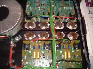

The new series of Naim amplifiers has an unusual output device. From their website:
"A bipolar transistor with a specification combination of very high current, power rating and bandwidth was needed, far in excess of anything available to Naim before. A suitable output device was eventually developed after six years' collaboration with a semiconductor manufacturer.
"These outstanding components each provide up to 80 Amps and 350 Watts, negating the need to use parallel pairs of transistors (which always have a negative effect on sound). Additional 007 transistors are used in the fully regulated power supply, ensuring the very best performance."
My understanding is that Naim uses quasi-comp output stages, so I would assume that these are NPN only. This is still an extremely robust part. Does anyone out there have any more information on these parts?

some to-3 trannsistors can dissipate 350W
:nod: 80A BUR51, BUR52 from ST, 60A BUX20 from Semelab
hFE=20-100, transition frequency 10Mhz
NAP-250
dimitri said:
OK, Dmitri, you've solved the mystery. The NAP-250 uses the "007" transistors, and they are clearly TO-3 packages.
I'm used to using TO-264 packages, which stop at about 15 A and 230 W for modern high-speed designs. I was surprised to hear about devices with 5x the current and over 50% power dissipation, but as you and others have pointed out, the Naim transistors are not so unusual.
