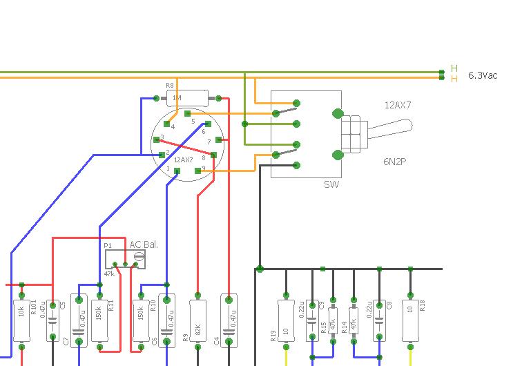

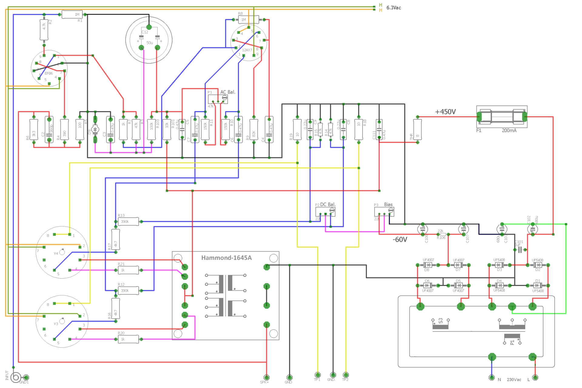

Some asked me for a "wiring diagram". This is how I wired it, using tag board for most of the circuit. Some resistors are mounted directly onto the valve bases. The component positions are almost exactly as the original 5-20. The wire colors are purely to visualize the various connections, it is not according to any wiring color code or standard.
(The input gnd is actually connected to the R1+C12 [1M + 50uF] gnd junction)
I have a high res. image, but it is almost 10MB big.

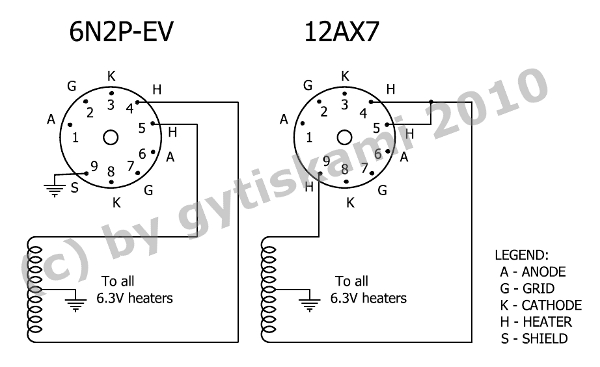

You can also use a 6N2P instead of the 12AX7 / ECC83 (did not compare them yet, so do not know if it is better or not.) They are almost identical, but the heater connections are different. I fitted a switch to easily swap between the 2, like this:

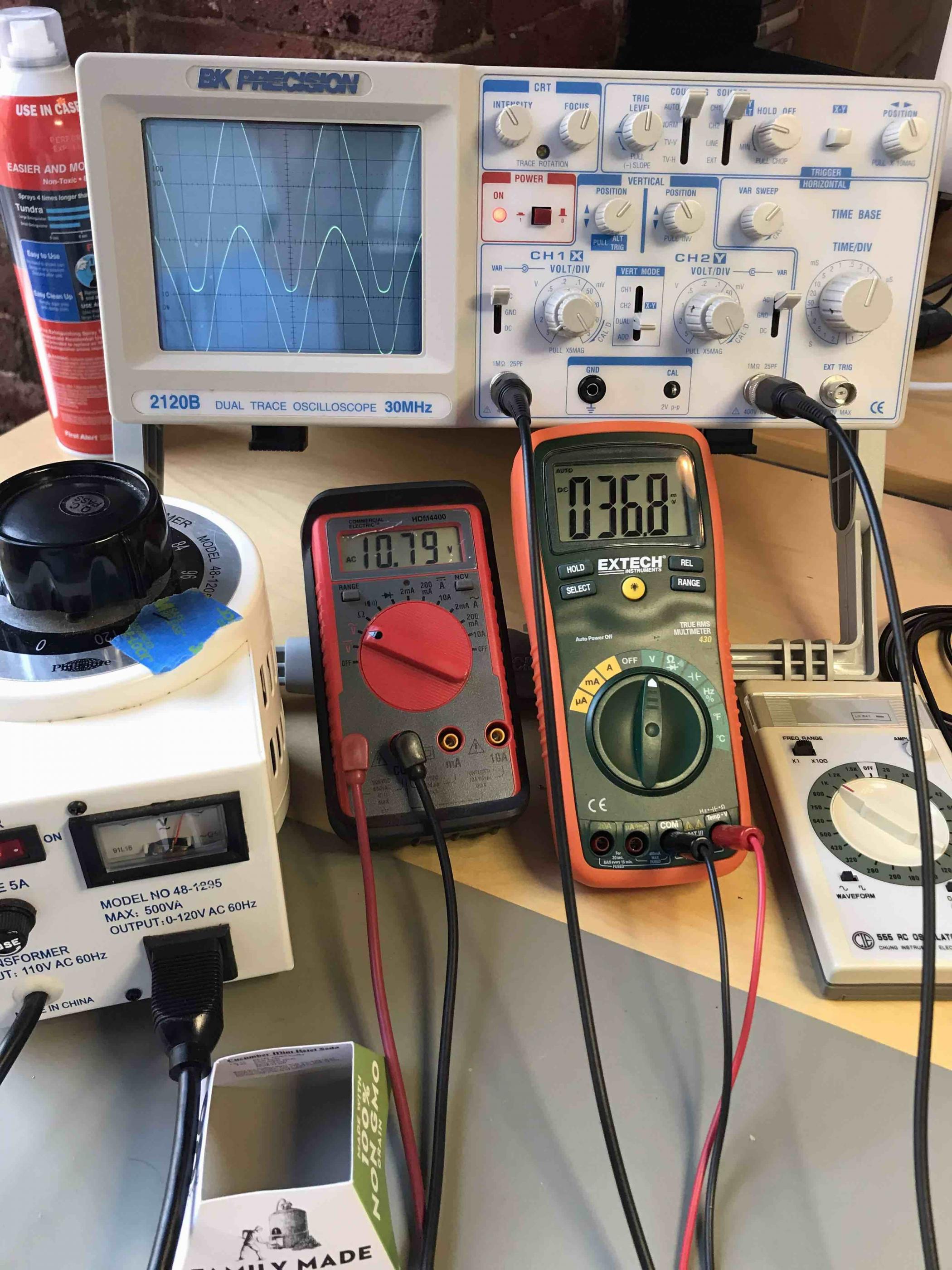

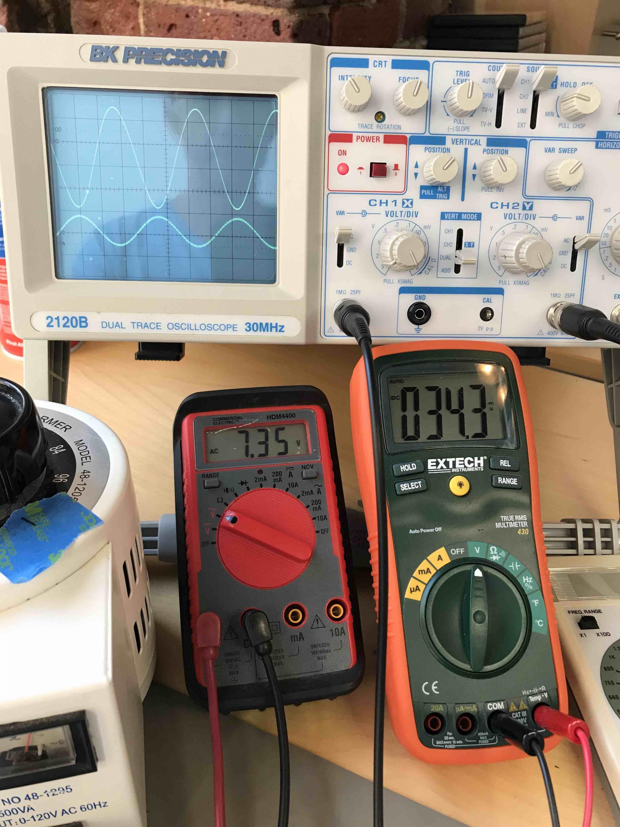

I built the CB 4-30 version and it's way too sensitive. 36mv in is max before distortion. It's configured for variable feedback and as I apply more feedback the gain and sensitivity also increases. I thought more NFB would reduce the gain.
The only difference is I used 5881 tubes and cathode bias 8K transformer. Cathode resister is 470 ohm with 390v on the center tap of the transformer.
The picture shows the scope the top being the output the bottom showing the NFB the right DVM showing the input the left showing the amp output.
Any ideas or suggestions on how to reduce the sensitivity or fix a NFB issue maybe?

What are you adjusting to apply "more" feedback? If you are making the resistance in the feedback loop larger, it will apply less feedback, and vice versa.
The Claus Byrith 4-30 design has an input sensitivity of ~500mV, at 36mV input clipping voltage, there is something not going right in your implementation. I would debug that first.I built the CB 4-30 version and it's way too sensitive. 36mv in is max before distortion. It's configured for variable feedback and as I apply more feedback the gain and sensitivity also increases. I thought more NFB would reduce the gain.
I would check the following.
1. Are you sending Positive feedback signal instead of negative feedback.
2. The Design call for getting NFB directly from the 8R speaker connection, are you doing that
3. Are you using Ultra Linear transformer and running in UL mode and not Pentode mode?
Yeah I think the input sensitivity might be related to the feedback loop.
Should the feedback be in phase or out of phase with the original signal? Would that be what you mean by Positive feedback or Negative feedback?
I am getting it from the 8 Ohm tap and the the transformer is wired to be UL mode. the Negative of the transformer is tied to ground.
I got it. The plus and minus on the output transformer were reversed. I wonder why they were labeled wrong. They were orange and black. the schematic said the orange was the 8 ohm lead.
