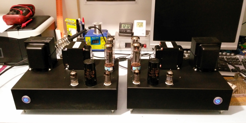

I think it will take exactly the same amount of time to make the other one.
Who will REALLY notice the differance in behaviour without an oscilloscope, spectrum analyzer, distortion meter and a seismograph? I don't think I will and the symetrical appearance wil be more pleasing to me. ;-)

Mirrored amps are either a waste of time, or worse. This because you cannot buy mirrored active devices so the stray capacitances and lead inductance will not be matched - unlike a pair of identical amps.
Yes - and no.
I faced the same situation when once, not for conscious mirrorring (how many 'r's??), but building a stereo amplifier on the same chassis, it turned out to be a non-problem for audio.
Yes, lead inductances, and rather more severe capacitances, will be different. (I laced leads so there was enough capacitance anyway to make me apprehensive). But I found that between the two layouts the open loop frequency response only started to differ quite above the audio spectrum - where any discrepancies (e.g. in NFB stability) could be taken care of by slightly different compensation measures within the loop.
Yes - this will also certainly depend on the design. Some amplifiers are sadly so close to instability with NFB that a capacitance change because of wiring could make waves (!!), but I would think that, unless the layout was woefully poor, there need not be a problem (or else I would certainly have had a few).

I finished the one amp (the mirrored one), and it is actually working.
Here are some pics, nothing special, but it works and sounds GREAT. 😉
Nice work! I wonder, though, why you put the filter 'lytic between both small signal tubes and why you didn't arrange these tubes in the same order as the signal flows.

It was like that on the original 5-20, and on my previous clones. Worked without any problems.

Finished the 2nd mono recently. Here they are, both working equally well.
Only problem I experienced was because off the high supply voltage in my area (245V) I had to use 47ohm resistors in serie with the supply. I ordered 2x 100W metal clad resistors from eBay (China), 1 was open circuit. 🙁

Here (Pretoria, RSA) we also have that problem, as you probably know. Locally wound transformers (imports are expensive what with the postage) are mostly done with mains taps up to 250V. I often have to use series primary resistors of some 33 - 47 ohms for overseas' products as well, but found that a well ventilated 10W suffices.
Fine build there.
As a "cruel" joke, the one OPT had it's secondary colors swopped, causing the amp to howl when I powered it up. Had to "mirror" that also. ☺️
