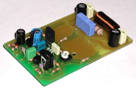

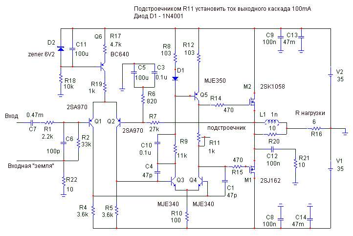

Can Not show here...
There is what that restrictions...
See beside me :
http://www.kievsat.com/phpBB/download.php?id=889
http://www.kievsat.com/phpBB/download.php?id=731
http://www.kievsat.com/phpBB/download.php?id=730
See beside me :

A modest increase in power
The upshot of all this is we can push this design a little but it's close to it's maximum output already, due to the output device voltage limitations and on resistance.
Here is one scenario: we could run the front end/driver at say 10v above the output devices, which would be conservative but still allow for driver losses and full Vgs for maximum current from the outputs. (You must upgrade the BC transistors to higher voltage parts, as well as the caps, diodes as appropriate). We still have the voltage drops through the output devices, which we can reduce a little with a 3rd device in parallel.
If we make those changes, I'd estimate only a 20% increase in power, from the present 180W to perhaps 220W. However, the reliability would be higher because the per device dissipation is lower. [Again, if you use high supply voltages and drive low impedance loads or bridge this amp, you must add output devices in parallel!]
Clearly, for significantly more power we need to go to higher voltage output devices, such as the Renesas 2SJ352/2SK2221. You could safely use +-90v rails with these, and expect something like 30% higher power, perhaps 240W. I'd definitely use more output devices per bank.
http://www.renesas.com/avs/resource/japan/eng/pdf/transistor/e2081193_2sj351.pdf
http://www.renesas.com/avs/resource/japan/eng/pdf/transistor/e2081352_2sk2220.pdf
Whew! That would be a lot of work for a modest increase in power. It does seem that the original design has hit the sweet spot for using these particular devices.
If you still want Mo Powah...
Multiple vertical MOSFETs with higher voltage ratings would be needed for truly significant power increases, and they would require significant temperature compensation not needed for the lateral MOSFETs. This is not really feasible to showhorn in to the P101, because you would need to add a Vbe or Vgs multiplier for that function.
I just bought some 500v Ixys complementary MOSFETs for fun and games.
http://www.ixys.com/94535.pdf
http://www.ixys.com/91536.pdf
The problem with these is the capacitance and on resistance is much higher than that of the lower voltage parts. Perhaps Holton's N-channel amp is a better option, because the N-channel devices are so much better than P-channel. To be continued....
There are frequent posts here requesting more power from an amp. What would it take to increase power output from the P101? There are a few minor mods that can push it up a little, but this little design is pretty near the max. Here's the original:
http://sound.westhost.com/project101.htm
Increasing Output Voltage Swing
Lateral MOSFETs are somewhat limited in voltage ratings to 200v and below. The devices used in the P101 (Renesas 2SJ162/2SK1058) are rated 160v max, and Rod recommends operating them at a supply voltage of no more than +-70v, and lower for low impedance loads.
http://www.renesas.com/avs/resource/japan/eng/pdf/transistor/e2081182_2sj160.pdf
http://www.renesas.com/avs/resource/japan/eng/pdf/transistor/e2081244_2sk1056.pdf
If we had a very well-regulated supply, we might bump that to +-75v, but that would really be at the hairy edge, considering tolerances and noise -- the cruel real world.
Another approach is to run the front end and drivers from higher voltage, to compensate for the Vgs drops and driver losses. However, there are problems with this approach. As Rod has pointed out: "...using an auxiliary supply will make only a small difference ...The specified MOSFETs have a rated Vds (saturated voltage, Drain to Source) of 12V at full current, and that is simply subtracted from the DC value of the supply voltage."
Increasing current output by adding output devices
That's 12v worst case for a single device, but not for multiple devices in parallel supplying the same total current (say 7A). In the case of the P101, with two P channel devices running 3.5A, the drop is 6V max, 4v typical. If we add a third device in parallel, the numbers drop further to 4v max, 3v typical (comparable to a bipolar output stage.)
Similarly, Vgs needed for a given total Ids falls as per device current demand is reduced. So for say 3 devices in parallel, we only need a Vgs of 4v to for 7A total current.
Note: If you intend to run low impedance loads or bridge this amp with the high supply voltages, which Rod advises against, you must add output devices in parallel! Let's face it, Holton already does this on his similar amp, using quad outputs. See:
http://www.aussieamplifiers.com/sym-sch.htm
True. If this is a serious problem, add an R/C filter to the base drive. I was being cheap.rode said:
...I'm always a little wary of using the same reference for the LTP and Class-A driver sources. There is a real possibility of cross-modulation because of the varying current into the (relatively) high current base circuit of the Class-A driver's current source.....
True again. The old RCA data books had little bootstraps to drive the other rail too, check out the 1966 edition for examples.rode said:
There is also the loss of drive signal - negative drive in my case, but positive in some other designs. The bootstrap circuit can drive to well below (above) the rail voltage, so there is no drive swing limitation. Unfortunately this only affects one side of the amp 🙁
Both the VAS and CS can stick. I put Baker clamps on both. It ends any possibiliy of sticking for either. When a device is saturated, the signal path is open, no signals can pass and the negative feedback loop is confused too. Best to minimize the duration.rode said:
There is the potential for a current source to cause 'rail sticking' under severe transient overload - it has a relatively unlimited base current supply, so can fully saturate if driven hard enough, where the Class-A driver (VAS) has very limited base current resources - it can saturate, but can never go into 'super saturation' because there's just not enough base current available.
Again, audible? Probably not under proper conditions (minimal or no clipping).
