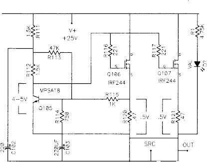

Nelson Pass said:Other things aside, I don't agree with using a resistor for
the bias voltage when it is not fed by a constant current
source. With the bootstrapped loading, the quiescent current
becomes a function of the supply rails, so anyone building this
should use a well regulated supply.
Do you mean it is only in combination with bootstrapping you
don't like the method, or do you want a CCS anyway? I am
asking since most or all designs I have seen that use lateral
MOSFETs use only a bias resistor without a CCS, but none of
them has been bootstrapped, I think.

Nelson demonstrates his expertise about bias!That said, we welcome yet another designer seeing the light
Re: Reply
First pick Rod's goal. Then, has he reached it? Everyone here know that Rod's goal wasn't extreme high-end, more like easy to build (few parts) and decent sound quality.
Note also that Hugh's AKSA amp is similar and highly regarded and I haven't read a bad thing about his amp.
I (as Nelson Pass) think that the bias circuitry may make trouble beacuse of the somewhat unstable currents. It may not be a problem but I trusted too must to the negative temperature coeffcient in my QRO amp and the result is a somewhat unstable amp with respect to it's idle currents.
In Rod's case it may not be a problem.
hifiZen said:Bootstrapped VAS - yuk!Use of L-mosfets in source-follower is good though. Overall, it doesn't look like anything special; I can see plenty of potential enhancements.

I think it is stable once the rail voltages are fixed. To the extent that you are adapting the design for for different voltages, you will have to adjust the pot. But once the rail voltage is fixed, you are done, 🙂

wrong again.........
"probably becuase bootstrps went out of fashion in the 1970s"
No..... The enclosed schematic section (R111,R112,C102) shows a bootstrap circuit by a pretty well regarded designer on a pretty recent design. A very popular kit amplifier which also sounds very good also uses a bootsrap circuit on the voltage gain stage.
The point that nobody seems to recognize is that bootstrap allows the circuit driving the output mosfet's gate to swing outside the supply rail and gives more output swing without seperate rails for the front end. It also provides a more resistive load at high frequencies for the voltage gain stage and most likely less high frequency parastics than a transistor current source.
I can't see why bootstraping and quasi- comp output stages are not as valid design approaches today as in the past.
Before everybody second guesses Mr. Elliot, I should point out that his circuit topology is very simular to some off the highly regarded B and K amplifiers.
Every one seems to forget a major advantage that the Mosfet follower has over the BJT follower in not loading the VAS stage with the load impedance divided by the Hfe of the output BJTs.
I just sent a mail to Rod hoping he will shed some light on his design. Maybe he can comment about using just a resistor for the bias voltage.

no.......
"I think it is stable once the rail voltages are fixed"
The current through the bias resistor for the mosfet gates is defined by the base to emitter voltage for the common emitter voltage gain stage and the resulting collector current for the value of the base to emitter voltage. This base is driven by a current mirror so the base emitter voltage is not as well defined as with a load resistor at this location. Even with a fixed load resistor for the diff pair, changes in the VAS transistor quiescent current with temperature will more the MOSFET bias with a just resistor to set the gate to source voltage.

Re: no.......
I am not sure how you came to your conclusion but if I were to calculate the bias, it would be quite simple. The lower mosfet's gate is about -4v (look at its Vgs), give or take a little.
so at idle, the current going through R7/R8 got to be, per Ohm's law, (Ve-4v)/(R7+R8). Rod seems to be setting his bias at about 5ma so it works out to be (Ve-4v)10ma, very close to the formula he gives on his site.
you can then calculate Vr1 to be 8v/5ma = 1.3kohm. I tend to double that so a ~2.7kohm pot will do the job.
is that too hard to express?
