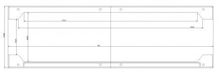

Question here about "Heat-spreader" (1 or 2 pr. chassis) made by 10mm aluminium to connect the two heatsinks thermically.
I prefer a "Heat-spreader" that is close to max. dimensions the inner measurements of the chassis allow. Then I will mount everything on "Heat-spreader". Drill some holes for mounting. Cut some threads in heatsink for mounting the "spreader" (or maybe make holes all the way through).
For my project with SIT-follower I don't need the standard thread-holes in heatsinks (but of course the holes for mounting the heatsinks to chassis I need).
If possible, how to order such an "add one"?
So if I get this right you would need some small 10mm thick panels which are going to be "the middleman" between the heatsinks and your components?
Hi Gianluca
Yes, 10mm thick but large 🙂 ....so it covers as much of the heatsinks inside the chassis as possible. It will be less than 400 x 160 mm but how much less I don't know. Maybe you can see what is possible so alu panel does not interfere with internal mechanics?
This was my idea.

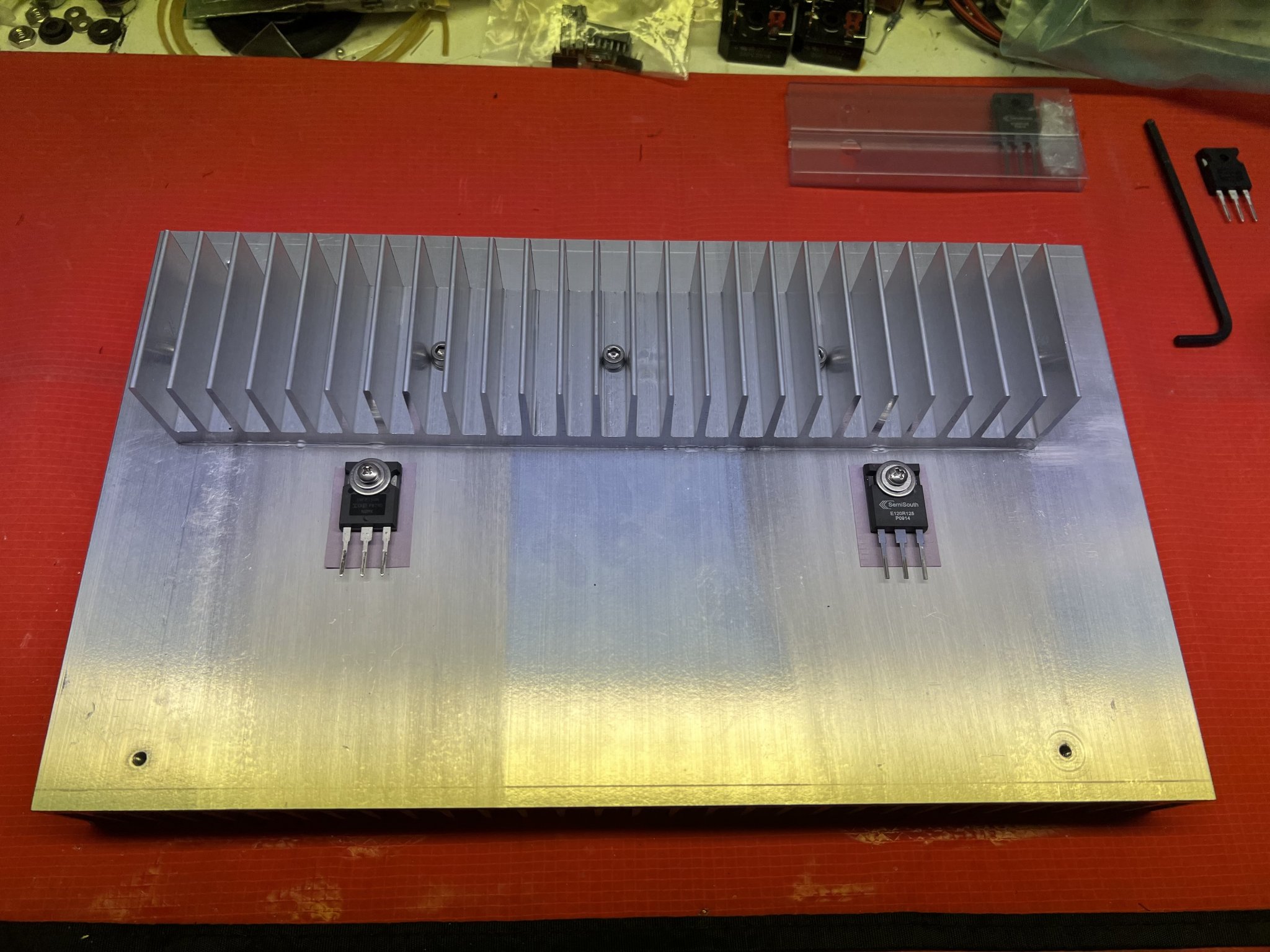

Extruded heatsinks most times have a slight wiggle/warp to them.
Recent first hand experience with with this.
I wanted to increase the mass/surface dissipation of a chassis I built with some 4U/300 heatsinks I was try to pump some more current through.
Needless to say, both pieces of heatsink had some warp which was pronounced by trying to bolt them back to back.
Be prepared to have to use some real force if you are going to try and flatten a full size 4U heatsink. I propped both ends on some blocks and tried standing and bouncing on it to no avail.
I got lucky that the smaller piece of heatsink responded and I was able to reverse its warp to match the 4U piece. I bolted them together with stainless 8-32 (m4 equivalent).
Trying to pull it in place with M4 through bolts may work, it will shift as you flatten it so give the holes some clearance if you can.

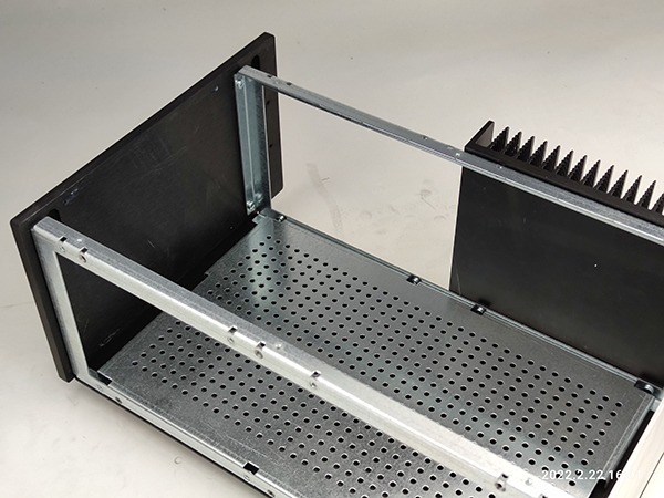

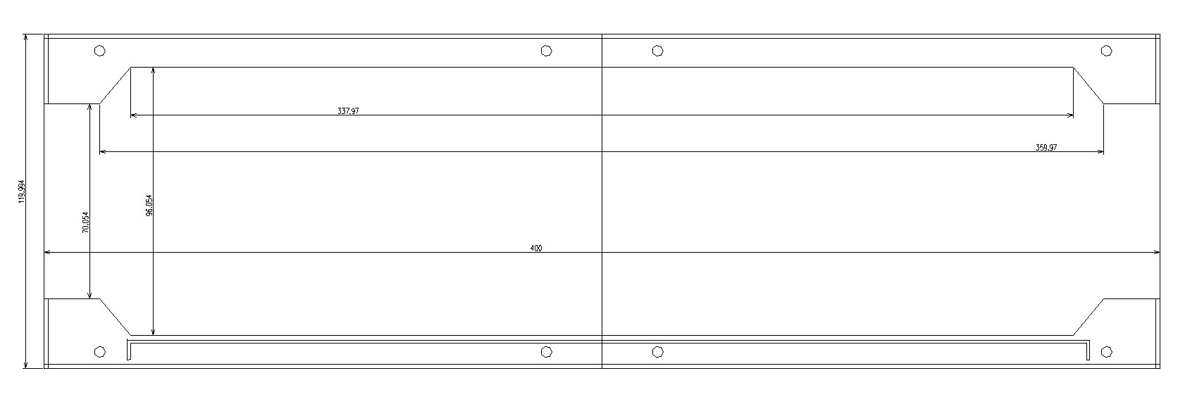

Using this picture as reference, considering there's about 15mm of space used by the brackets on top/bottom edges of the heatsink and about 20mm of space used by the brackets on left/right edges of the heatsinks I would leave some extra mm of tolerance to make these panels, what do you think?
I think this would be perfect to subtract few more mm than 15 / 20 mm for the alu panels. E.g. 20 / 25 mm ?
If I could order 4 of these panels for two mono blocks, I will be happy.
Fine, and the heat-paste will help the heat transfer also.
Modushop heatsinks are high quality and very flat 🙂

To note…I think it’s pretty obvious I was not working with Modushop heatsinks from the picture I posted…they were sourced from Heatsink USA.
This was a project where I was endeavoring to create something unique for myself as I felt that was really the only thing I could contribute to it.
I have long since given up on the idea that I could save money taking this route (if anything it probably cost me more than a equivalent professionally manufactured product) or that I could improve on a professionally engineered product such as those offered by Modushop.
Playing engineer to try and improve on something is often just that…playing. I have spent more time trying to fix my “good ideas” than anything else.
I think what is a relevant piece of information is that when trying to mate surfaces in an attempt to improve heat transfer between them what is considered an acceptable tolerance regarding gap(s) that we can hope thermal grease will help improve transfer. It is minute (.001?) and can’t address issues like heatsink warp.
