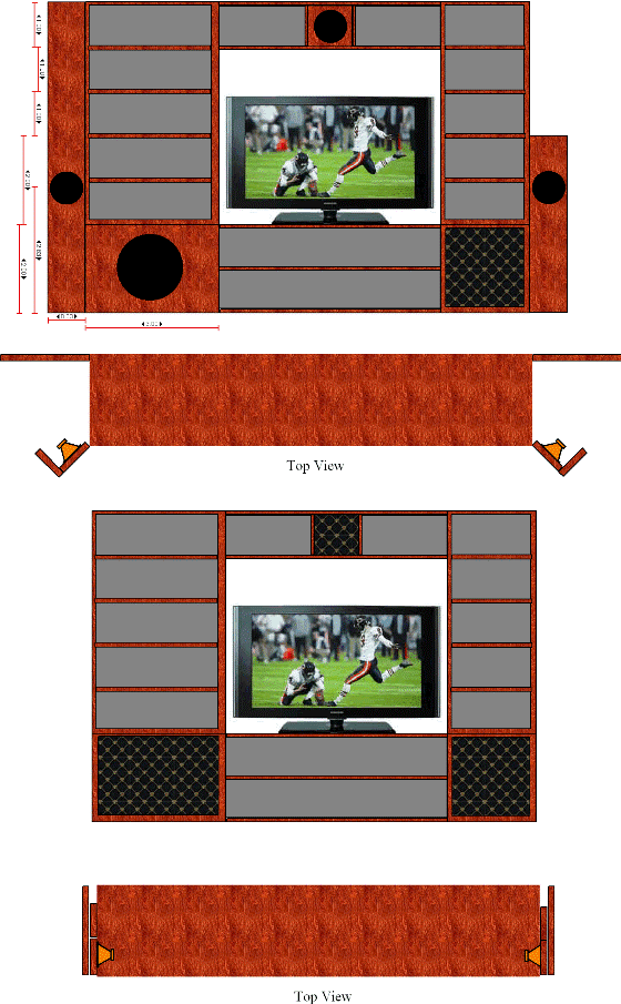

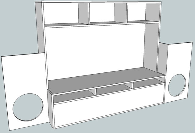

I'm wondering if either of these would work. What happens to the radiating figure 8 pattern when one half see's a finite baffle and the other side see's something closer to an infinite baffle -- okay not infinite, but really big by comparison - approx. 6m (nearly 20') from front to back going the long way round.
Obviously the baffle to the left of the entertainment unit (EU) has the drawer protruding forward of the baffle, potentially upsetting some of the upper frequencies covered by the woofer.
If the upper frequencies covered by the woofer would be upset due to the EU's drawer then a simple extension on the baffle to create an 'L' shape would allow for the baffle to be flush with the front of the EU like the baffle to the right in the image.
Of course if it's just a stupid idea and I haven't thought about it enough, which I haven't then could a moderator please delete for fear of public lynching 🙂

Here is a similar concept that I have been working out using some Wild Burro Betsy speakers in OB combined with a tapped horn hidden into the bookcase proton of an EU. The sketch shows one bookcase as being 36 inches wide and the other as being 24 inches wide to see what they would look like. In application both bookcases would be the same size.
Now if I could only come up with some $$$ to do a bit of prototype work 🙄
In this concept everything folds away for storage and WAF......(of course)
