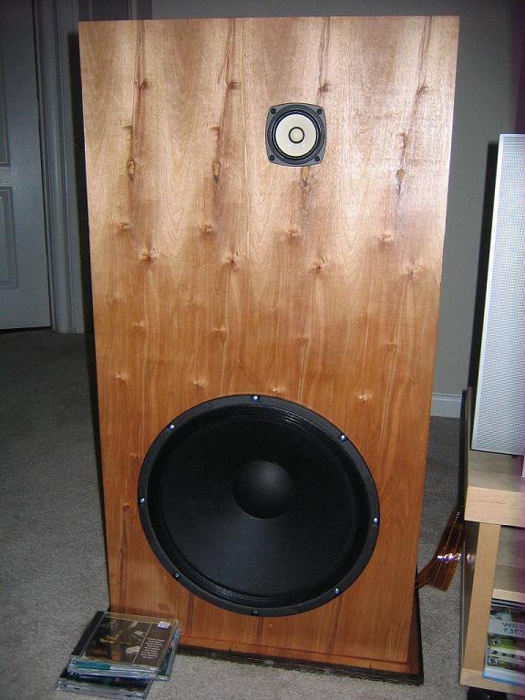

good design..
My MJK-OB version finished about 6 months ago and I use Ron's choice of FE87 for the full ranger.
Now it has gone thru the 'burn in' period and sing more beautifully...😉...
Great job MJK...:up:
Joshua

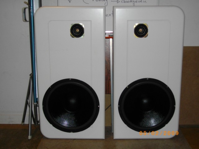

Martin, thank's for sharing.
Took about 4 hours from start to finish.
Top and bottom piece from a bed.(a bit smaller : 19x36 inch ....made all the x-over parts 10% smaller also)
Cut holes .............place speakers.
Look for x-over parts in the box.......
start listening...............and be surprised!!
Total cost:
woofers 2x 40 euro (Qtc ; 0,78 was the best I could find around here)
foster 085 2x 1 euro
x-over , was in the box ??
wooden stand at the back 2x 2,5 euro
small parts , about 2 euro
anyway less then 50 euro !!!
Sound like thousend euro each !!
Great work Martin!!
Never build anything with so much ease and so satisfying result!!

Those are some slick looking panels!
:up: :up:
to tea-bag,
Thank's for the compliment.
All the work was already done in the bed factory.
Was the only proper way for me to re-use the bed-components.
I'm at work at this moment, will post another pic of the back-side this evening.
They have 100+ hours on them and start sounding more smooth.
Very positif reactions from the others who hear them.

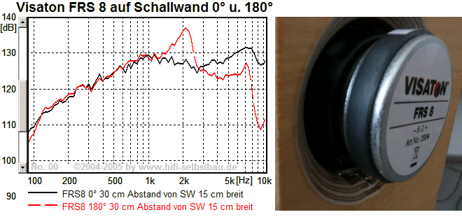

Sorry wixy,
from what I can see on your picture, the inner taper of the FE108 back opening looks quite narrow. Any chance to get it any wider, like chamfering a bit at the outer end?
Look, what a difference different mounting of a driver can make for the front (black) and back (red) wave on-axis:
attachment.php

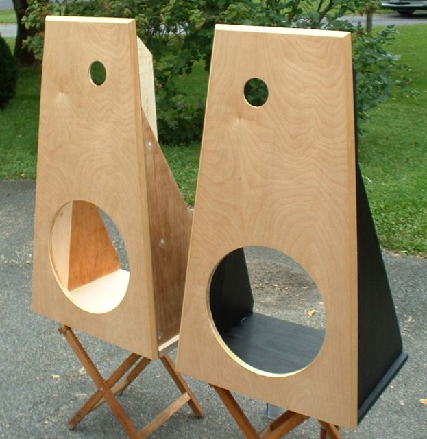

The Back Story
I bought a pair of Fostex FF85k drivers to build a pair of micro-Fonkens. Since I was in the middle of another build (Metronome with F120A,) I built a pair of cabinets (using the term very loosely) from 2 liter soda bottles and scrap wood which I dubbed The Sprites.
I was so taken with the FF85k that I decided to build an OB with it. I figured I’d build an H-baffle with Eminence Alpha 15, per Martin J King. So I bought the Alphas and another pair of FF85k’s.
Now I’m going crazy seeing the drivers just sitting in my office. Can’t wait. Must build something NOW! Maybe I’ll buy a piece of OSB and make a simple passive OB like MJK’s project. But I’ve got half a sheet of birch veneered ply sitting in the garage. Maybe I should use that. Can’t stand to make a hack job with decent ply...
OK, fire up MJK’s MathCAD worksheets and look at how the FF85k might work. And while I’m at it, how about making the baffle more attractive? Consult wife...
Sidebar
My wife has been VERY tolerant of my stereo systems. From the rather large RTR 280DR’s I bought back in ’74 to the Visonik sat/sub second system added in the late ‘70s. The key is consultation. If she is part of the process, then she is invested in the program. So the ugly little Sprites were fine in the living room before the micro-Fonkens were finished. And now they’re fine in the family room preparing for the OBs. She chuckles every time she looks at them.

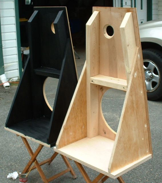

An MJK OB (mostly)
Large black rectangles won’t cut it. (Too much like the monoliths from ‘2001A Space Odyssey.’) A key stone shape (22” wide at the bottom and 14” wide at the top) with a veneered, beveled edge and finished with clear polyurethane gets the nod of approval. The MathCAD model looks essentially identical to the rectangular baffle.
Perfectly vertical isn’t good; a 5 degree tilt should do it. How to support the baffle? start with a base 15” deep X 22” wide made from 2 layers of 0.5” BB ply leftover from the micro-Fonkens. Triangular side pieces 28” tall made from demolition scrape (kitchen remodel a couple years ago.) That doesn’t sound like enough to brace a 15” woofer... OK, let’s add 2x4’s up the sides and another between those supports above the woofer. Photo below shows a back view--one before and one after the flat black paint.
Second photo is a front view.
I am adding small furniture glides with 1/4-20 shafts for now. If I don’t like them, I can replace them with spikes.
By the end of this weekend I hope to have the paint and polyurethane done and enough hours on the FF85k’s for me to install the drivers. More then...
