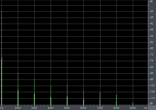

Any particular sims you wanted to see? Attached is an FFT from a 1kHz sine wave, 11V peak into a 4 ohm load.
amplifierguru said:
Hi Evil

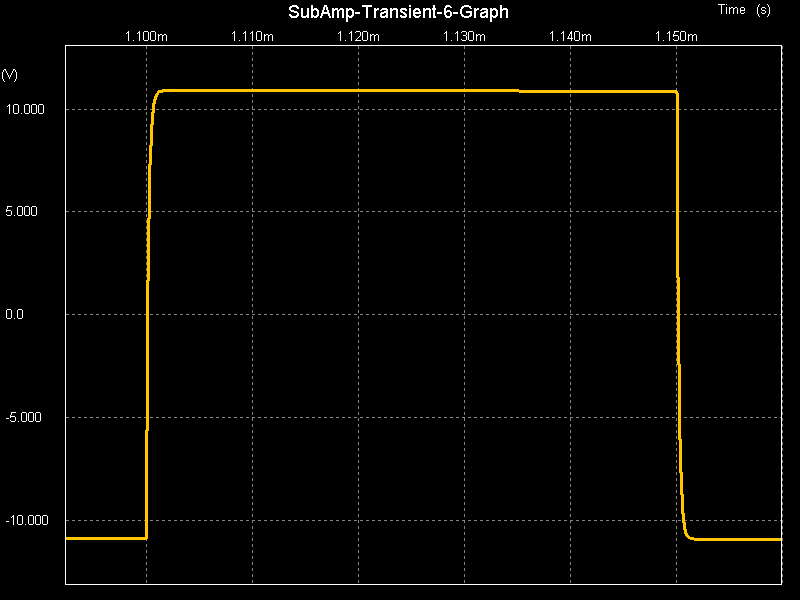

Unless, of course, it's approaching slew then OL THD will be rising very sharply and NFB decreasing.
Greg
Yes, there could be (probably is?) a new mechanism at higher frequencies that would increase distortion faster with frequency, but it won't be due to insufficient slew rate, since this amp can provide an adequate 100V/us.
