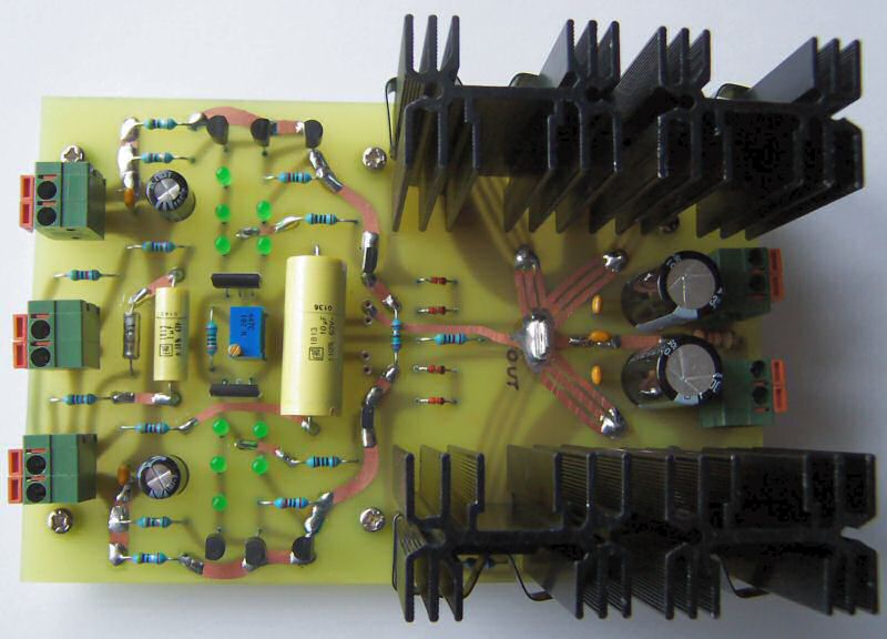

This is something I've been slowly piecing together since I started coming to these forums. It makes use of all three common types of transistor (BJT, JFET and MOSFET), making use of the good points of each. It incorporates many features inspired by threads here, such as the symmetrical folded cascode topology from the thread of the same name, current mirrors with gain from a distortion cancellation thread, and it is through this forum that I finally managed to find somewhere in the UK that sells the Toshiba dual JFETs that I've used..
I've posted information and pictures here.
It sounds pretty good to me (as if anything I made could possibly not sound good!), and it has 10 - yes, ten - LEDs, which guarantees it must be good:D

I might put an article up on my PCB creation method one day. In short, I print out from the PCB layout software onto a piece of paper and use that as a template to drill holes (for SMT devices I use a small hammer and a nail to put an indent where the pads will be). Then it's just a matter of joining the dots with an etch-resist pen. It's a mix of art and science: I try to bear in mind what form might be best for a track and also draw them in a way that pleases my eye.

...What are the driver MOSFETs (X1 and X2)?
I was supposed to explain that on my site, but I seem to have forgotten. They are ZVN2106A and ZVP2106A from Zetex. They seem pretty good, although not my ideal choice. What I really wanted were some rated for 2-3W so I could run them at about 50mA rather than the 20mA they are at now to better drive the input capacitance of the output FETs. However there seems to be a bit of a gap in what's available, with plenty of low-power devices and then a jump to power FETs of 20W+, which are a bit too big.

Did you look at the 2SJ76 + 2SK213 from Renesas (nee Hitachi)? These lateral parts are in a TO220 package and are very easy to heatsink.

They look quite interesting. Lower capacitance than other similarly rated devices is good. That was a particular consideration, since any increase in the speed of driving the output stage by choosing a power FET run at high current tends to be offset by them being slower devices. It's too late to change now, but I'll keep them in mind for future projects.

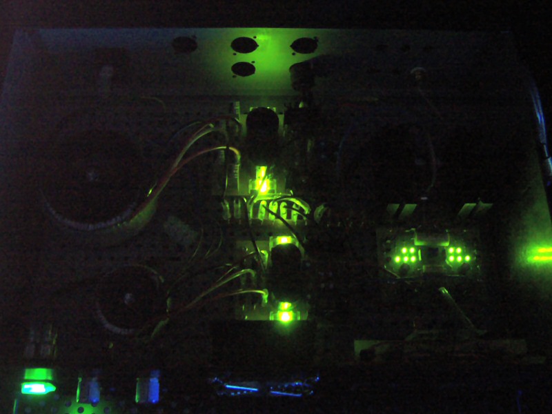

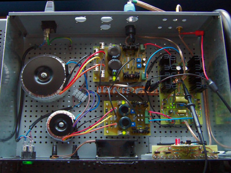

And another in the daytime, complete with 'scope probes. As you can probably tell from all the extra holes, fans, VU meters (PCB in the lower left corner), this case has been used for several previous projects. It's not exactly a compact amp, taking a whole 4U rack case for just one channel.
