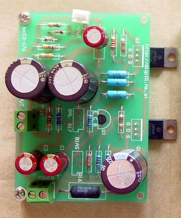

here is my board assembly photo:

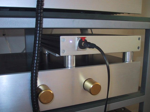

Just finished mine🙂 As it happened, I had a chassis like Tortello himself😉 I fitted a heatsink in the bottom of it. It is running from a "pure breed" Zen regulator. Big caps are Black Gate's, input cap is a BC 4,7uF MKT. The sound is amazing😀 I didnt use a pot for it, but runs the amp from my beloved BosoZ. I also had some rather tall feet machined for the chassis, to help the airflow around the heatsink. You can see the heatsink right underneath.hello everyone,have you finished your amp?
The amp is totally quiet in the headphones, with no signal. Only a little "mosfet hiss", with the volume at full throttle.
Thanks, Tortello for this fine circuit, and DIGI01 for the boards🙂
Steen😎
steenoe-
I love the chassis.
Couple of questions:
1. Where did you get the chassis?
2. Why the heatsinks? Was the chassis it's self not enough to cool the amps?
