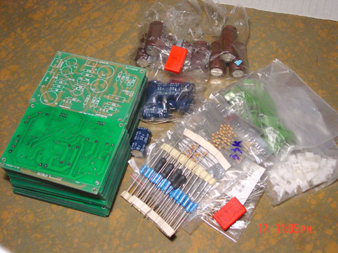

thank you for your appreciation🙂lately,I have received some e-mails ask for my boards.I may do another round orders.
dual mono zen headamp boards,total=60 PCBs (30 sets)
R/C kit,total=10 sets (maybe add,basis on order quantitys)
if you have other ideas,please add comment.

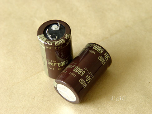

btw:I am considering append power supply caps and bridge diodes in R/C kits.I have find some good components.
such as ELNA standard or Nippon chemi-com 6800u50v caps.

The boards is available now.
dual-mono PCB boards, Total = 60 pieces(30 sets)
The price is $3.6 USD per board.building one amp need 2PCBs boards($7.2).the boards including partlist.
surface shipping costs is $5 USD.take 2-6 weeks arrive.
by air ,cost is $10 USD.2 weeks arrive.
R/C kit,total = 10 sets.
each kit can fit 2 dual-mono boards and mono power supply used.
part list-

ELNA standard 6800u50v cap*4

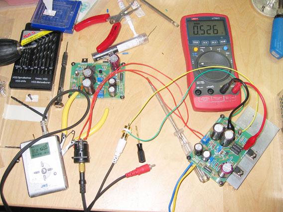

Hello,
I have just started testing my circuit after soldering all the components to Digi01s PCB.
I was aiming for a bias current of 300mA but all i seem to be able to achieve is 192mA (0.58V/3).
Here are some measurements that i took
24.8V supply
V R18 = 1.1
V r2 = 3.5
Q3 (ZTX450) B= 12.1, C = 16.8, E = 11.6
Vbe = 0.54
Q2, G = 5.2, D = 11.6, S = 0.58
Q1, G = 16.7, D = 24.1, S = 12.1
can anyone see if anything is wrong from these values?
Also I tried to set the Id(Q1)/Id(Q2) ratio the way tortello suggests on the Headwize site but cant seem to do it correctly.
Tortello's tutorial says to measure the AC contribution across R10 and R12 whilst applying a 1kHz input.
If i connect my scope probe across R10 with the probe ground at one side of R10 and probe at the other end I dont get a proper reading. If i connect the probe between Q1 source and R10 with the probe ground at ground i get a nice sine wave.
When i connect the probe across R12 I dont get any signal no matter how much i adjust R17.
Is this normal or is there something wrong.
Thanks for any help
Mark

Mark,
Lets tackle the bias issue first. Could you measure and post the voltages across R4, R16, R3 and R10. R4 and R16 will have the biggest affect on the bias current here. It may not be possible to get 300mA bias with them in the circuit. At first glance, your other numbers seem OK, but I'll check a little closer.
In my amp I had to remove them to get the bias up to 300mA, but in that case you have to add an extra capacitor in the bias circuit to maintain stability.
Start by measuring and posting those values and we'll go from there. Just so you know, I've benn pretty busy lately, so I may be a little sluggish in replying promptly.
Terry
