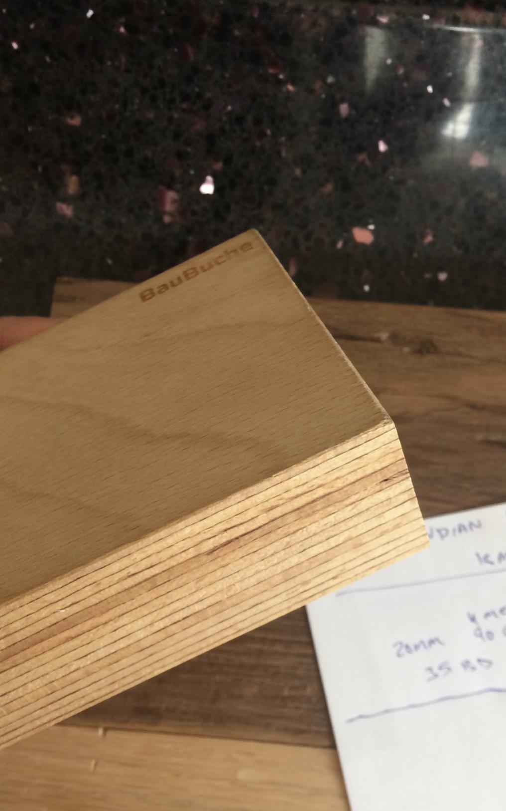

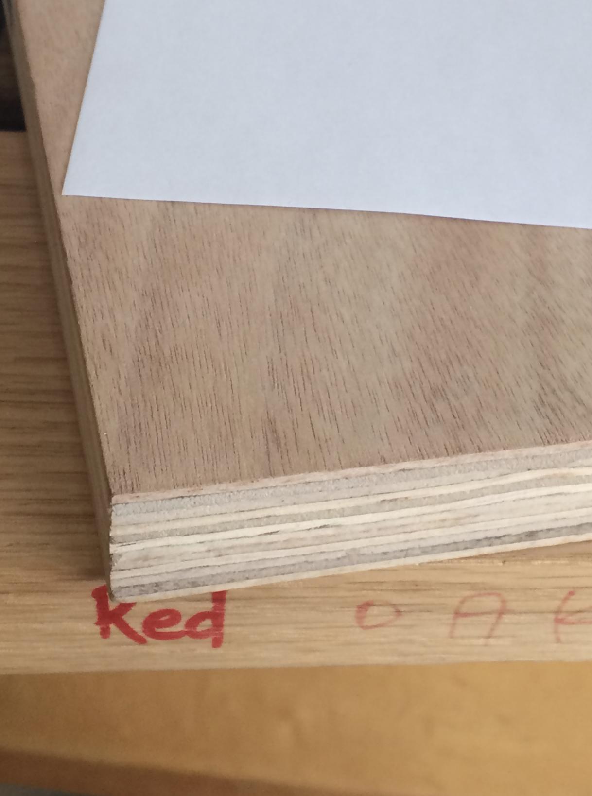

great, then i’m taking a step back to focus on building the cabinets, and will leave that for later. so on that, i can’t find baltic birch here, and since you’re so much against mdf, which is very easy to find, what other alternatives i can consider.
best i’ve found is an indian wbp plywood (attached above ”red’), and a german lvl baubuche. which one do you reckon i should try?
thanks dave
Got a picture of the German option? FWIW, in my 25 career in the millwork /cabinet trade, the European sourced plywoods were always of significantly higher quality than the Asian.
It was not unusual to find debris such as small gravel, and even machine nuts/bolts imbedded inside the laminated layers. Guess how we found them? Thankfully most of the time they were being cut on large beam saw in which the 14” moving blade was securely shrouded, but it did require resharpening or sometimes even replacement of carbide tips. Some of those blade sets are well over $500 CDN, so we want them to last.
Then there were issues of delamination of glue bonds and inconsistencies of material thickness - even within the same sheet of material - which mostly only affected tightly machined joinery such as dadoes, etc.
you’ll find it attached, and here is a link from the source, for more info about it. and digging for more information on diys, i found this example, and this too. though, the finish is different from the one i can source here. it’s much more expensive option from the asian one, it’s about €82 for the 20mm sheet.
Holy ****, that is beautiful plywood!
