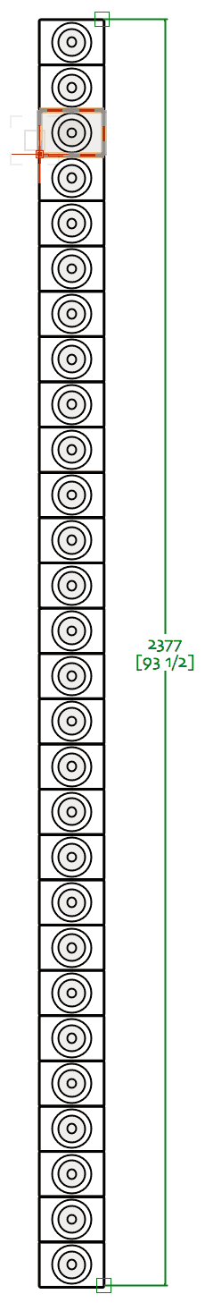

Here is a mock up of 28 CHN-50R. I have increased the height to the nearest 5mm.
1.5-2 litre sealed will give you ~ 140 Hz second order to an array of woofers (or some EQ to take it lower, est 10 dB @ 80Hz to bring it up to an 80 Hz woofer, 6 dB @ 100Hz) … 2.5 litre vented could take you to 80 Hz 4th order (but would likely want some sort of electrical HP for safety). The latter would be best done as individual enclosures. That could invoke the use of a 3D printer to manufacture the back of the baffle structure.

I had a conversation about this with the factory. It is doable and a new square frame could be made of the correct dimensions to take the CHN-50 drive train. However to make the amortisation of the frame press tooling into the the final driver costs sensible there would be a MOQ of 3k. Prices would be about the same as where we are with the CHN-50 (TBC) for that. It seems like you would need a LOT of people to join a GB to get this off the ground. I'll happily run the manufacture and distribution part of it of you can get enough folk interested.
On the other hand, Scott and I did chat about an active eq version using the round drivers that might be more achievable.
Actually looking at this again and getting the factory to do some more maths I can get the MOQ down to 1000 which is more doable I guess. Price to the end user would look to be about $38-40 a pair. which is about £1100 for a pair of Dave's mock ups above. We'd need 18 people to make that doable.

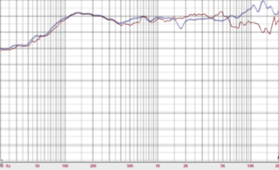

Overlaid/scaled the two Pluvia models' FRs as best I could, 0-100 dB, 20-20kHz.
Blue = HD, Red = PHD. Apologies for the grim level of blur due to image scaling.
