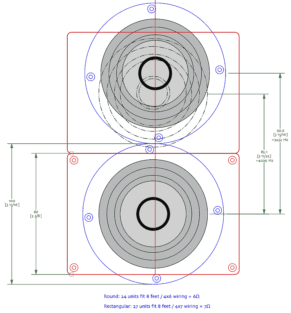

I might be mistaken, but I doubt that will happen. AFAIK this driver utilises an existing basket. I don't think they've got the money to create a brand new square basket specifically for this purpose
I would be surprised if this basket is not choosen out of one of the huge catalogs of a Chinese basket manufacturer. It is highly likely that a rectangular basket is also in this catalog. Unlike the A5x which would indeed invoke considerable tooling charges.

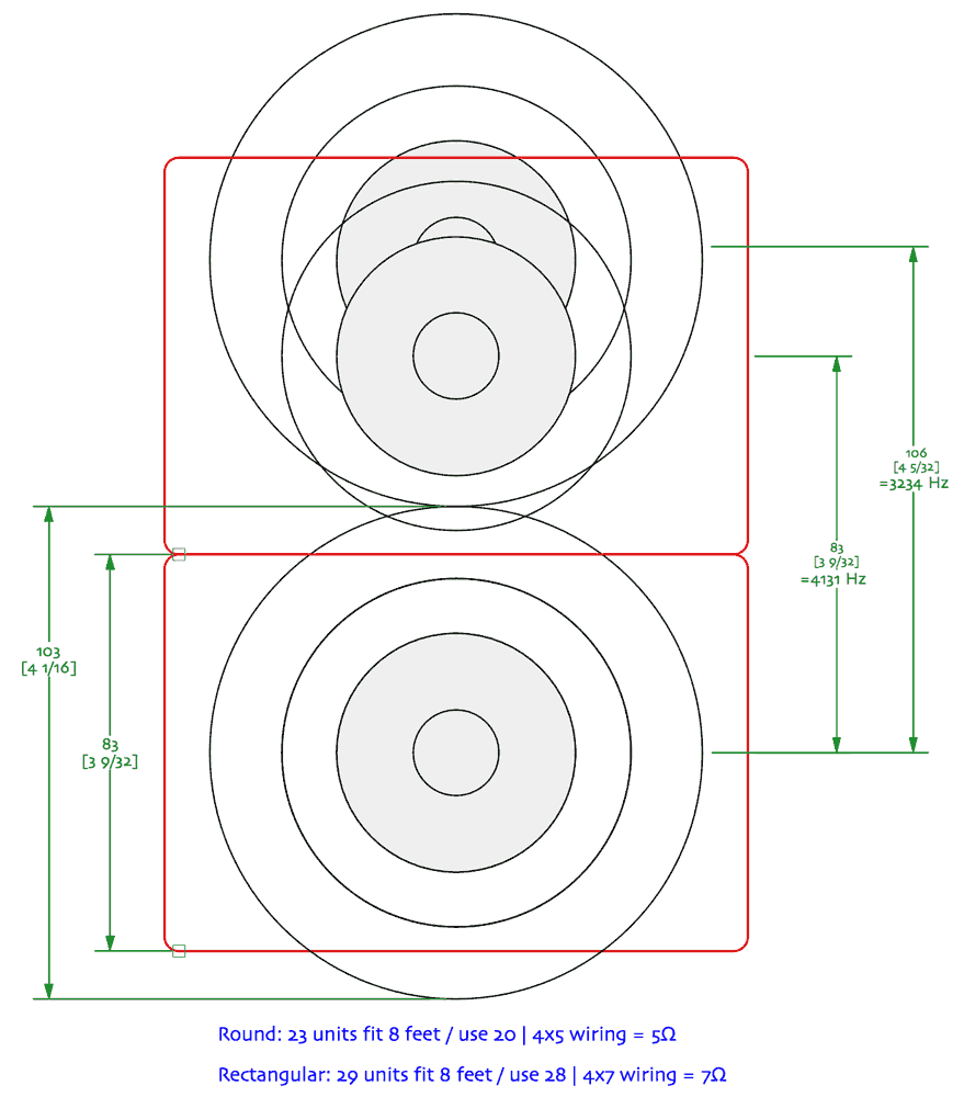

But as an example — before i got the number from Stefan — i did a quick & nasty sketch based on the A5x. By Stefan’s number the CHN50 is 2mm larger (by the factry drawing 3mm)
I suspect it might only take an order of 1000 units to fullfill this option.

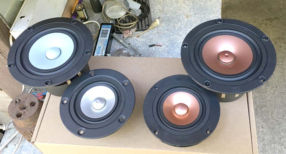

And a snapshot of my samples. It is clear from the dimple in the P7HD that this is not exactly like the A7.3 (A7.3 with P7 dustup?).

The 7 PHD is showing 7 HD; I found a spec for the 7 PHD on a Japanese web site a day or 2 ago but didn't book mark it and now I can't find it. I'll keep looking; I believe the 7 PHD high end starts rolling off above about 5 to 6 Khz, not rising as the 7 HP shows. Thanks for putting these here anyway!
I took the calipers to the CHN-50 and have tweaked the diagram above for the cast basket driver.
1000/60 = 17 or more people.

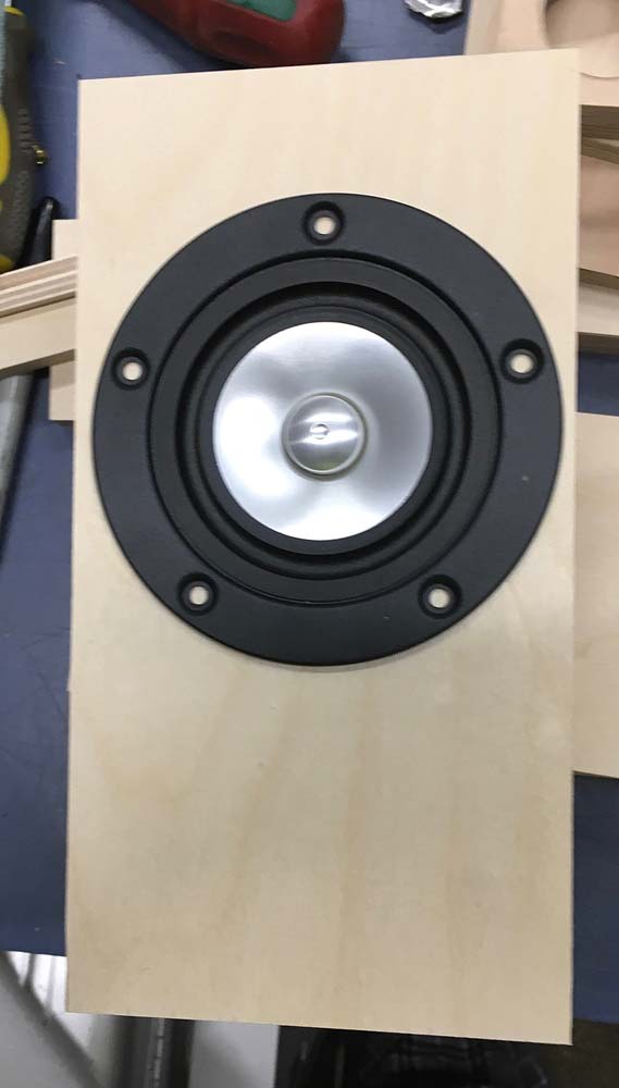

I also figured out that if i flip the baffles inside out i coan easily surface mount the CHN-50.

Dave, the basket is definately made in house, the wider company Telefield make loads of drivers for other applications so they are basically the company that would have a catalogue full of stuff. I don't think it's likely we'll see an MA square driver from the company any time soon as for most folk they are a bit of a turn off. All that said your numbers would work well for a group buy and I'd be happy to persuade the factory to make a thousand if we could get a group buy off the ground. Scott mentioned the other day designing a line array although it looks like you've got your grey matter churning it over already ��

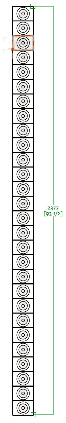

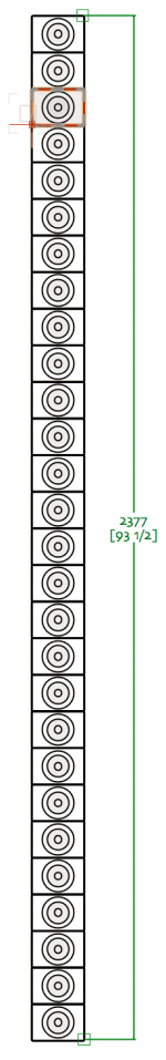

Here is a mock up of 28 CHN-50R. I have increased the height to the nearest 5mm.
1.5-2 litre sealed will give you ~ 140 Hz second order to an array of woofers (or some EQ to take it lower, est 10 dB @ 80Hz to bring it up to an 80 Hz woofer, 6 dB @ 100Hz) … 2.5 litre vented could take you to 80 Hz 4th order (but would likely want some sort of electrical HP for safety). The latter would be best done as individual enclosures. That could invoke the use of a 3D printer to manufacture the back of the baffle structure.

Did it. I heard nothing similar to buzzing at 30-200hz on high volume.
Awesome! Thanks a lot. What excursion are you able to get from the 11ms?
