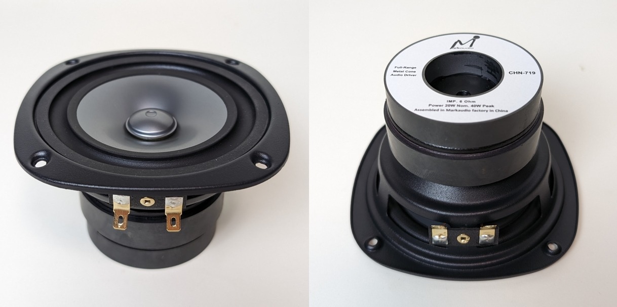

In Japan, CHN-719 (4" Full-Range) is scheduled to be released in January 2024.
The price is expected to be around 63 USD?

Have any details been released on it?In Japan, CHN-719 (4" Full-Range) is scheduled to be released in January 2024.
Suitable for a line array? the basket finally looks stackable. The rear venting is tiny, almost looks closed...keen to see how it sounds.In Japan, CHN-719 (4" Full-Range) is scheduled to be released in January 2024.
Japan only at this time, no plans for other markets.Have any details been released on it?
Apparently there was a listening session of japan's distributor.
However, the details of the driver have not yet been announced.

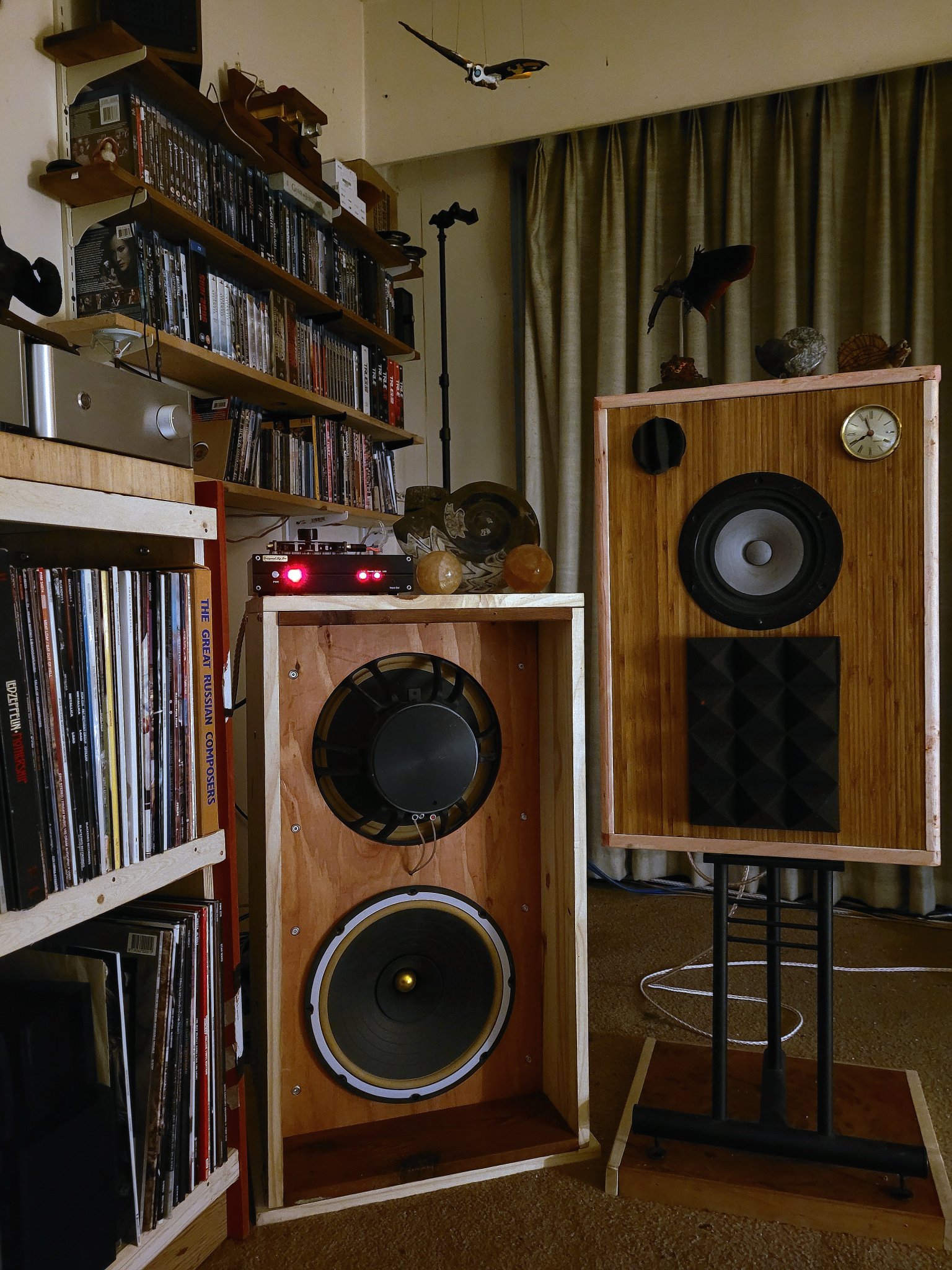

Today I pulled out my Ariel paper 10" subs, and replaced them in my H Frame sub with a pair of 12" paper cone full ranges.
Even with electric bass guitar, there's a lot more going on down low than I had realized before, even protecting them with a -14 db cut at 25 hertz.
Lighter is a lot more expressive with these, in my room.

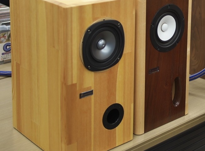

@orangeart any idea if the MAOP5 would be a suitable swap in for the 5.3 in the 3D print design posted above?

It's a drop-in replacement for the 5.3, as it's basically a lightly modified version of the same drive unit.

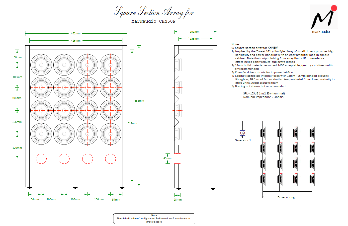

Keep in mind, the above was me basically doing a varient of the old Sweet 16 & is aimed predominantly at Japan, where buyers / listeners often have slightly different priorities to many elsewhere, and listeners with a focus on earlier recordings. That's a minor cliche, but like most cliches, there is a degree of truth to it. Sensitivity / dynamic range for drivers of this size is very high, but the HF limit is reduced. Good fun though.

I had those. Not near as good a driver in it, but the dispersion characteristics are not very good. You would be better to use the 16 drivers in a line arrary for domestic hifi use.

How would the low end be with these?
Likely 60-80 ish extention on the bottom. Same as a single in an approriate reflex.
dave
74Hz nominal Fb, lightly damped alignment (nice alignment actually), should be good for 60Hz[ish] in practice @ roughly a 95dB 1m/2.83v sensitivity & little step-loss to worry about.
Dispersion isn't great, as Dave says -as a Sweet 16 type box, it wasn't meant to be: this was about dynamic range & efficiency with small drivers in a modest-sized (and relatively short) package. HF starts to drop away above about 10KHz, although not quite as badly as a vertical column due to the shorter overall distance between extremes. As I say, I designed it mostly for Japan, where small drivers are popular, & so are spud amps with very little power, although I gather a couple have been built elsewhere, & I did something similar in the midband with the CHN-50 in my friend Colin's 'The Things', with 14 units run as 2 x 7 driver hex clusters. It's surprising how well they hold up on axis, especially on material (such as < mid-'60s, when most was BW limited by current standards) that doesn't have a whole lot of the upper octave present anyway.

....or Bessel array if wanting something 'kinky'. 🙄You would be better to use the 16 drivers in a line arrary for domestic hifi use.
