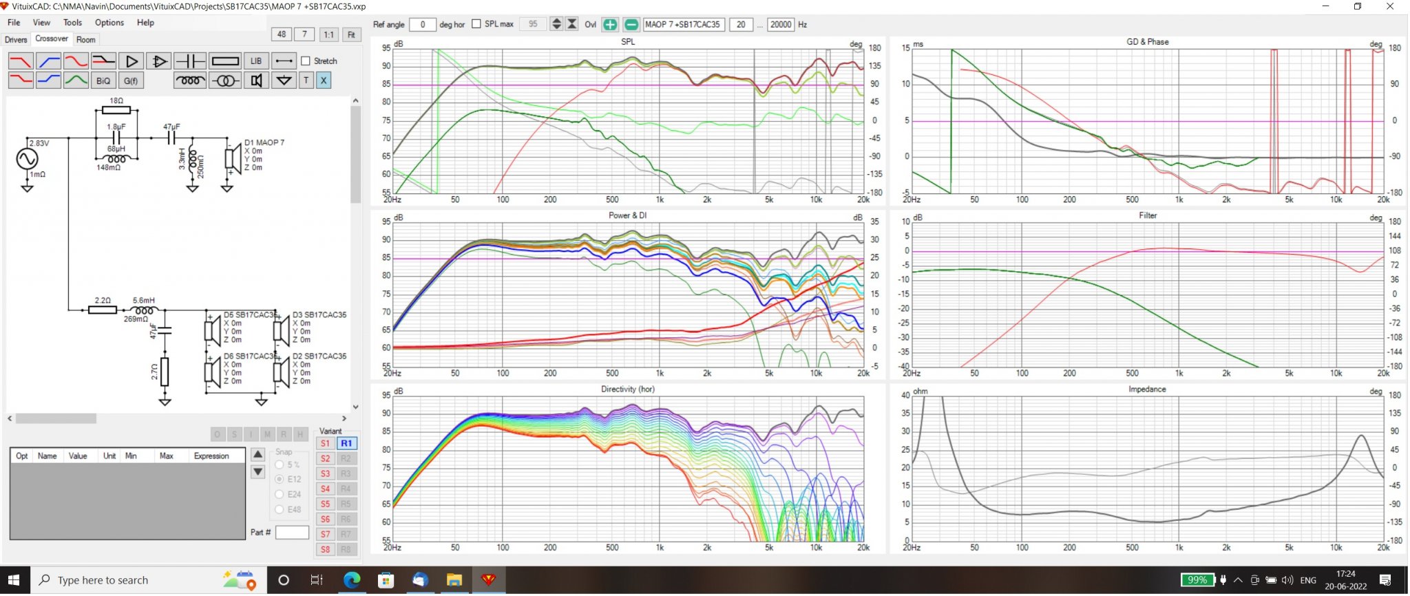

Sorry for the delay. I did try the SB drivers but I am getting very different results from what Madisound suggests.Have you looked on SB drivers?
For example, for the SB17CAC35 their website suggests "0.50 cubic foot with 2" x 6.7" long port for an F3 of 44Hz"
https://www.madisoundspeakerstore.c...coustics-sb17cac35-8-6-ceramic-woofer-8-ohms/
WinISD and VituixCAD however suggest a box size that is closer to 1 cu. ft (25 litres). With this larger box size, I get the following simulated result

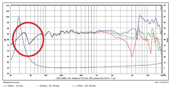

Talking of SB Acoustics vs SEAS why are the curves so different. I understand SEAS and SB Acoustics might be using different testing methods but almost ALL the SB drivers have this rather odd bump in their response curves (see below)

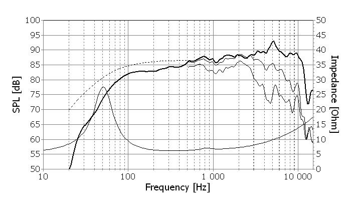

The SEAS drivers do not exhibit this bump (see example below)

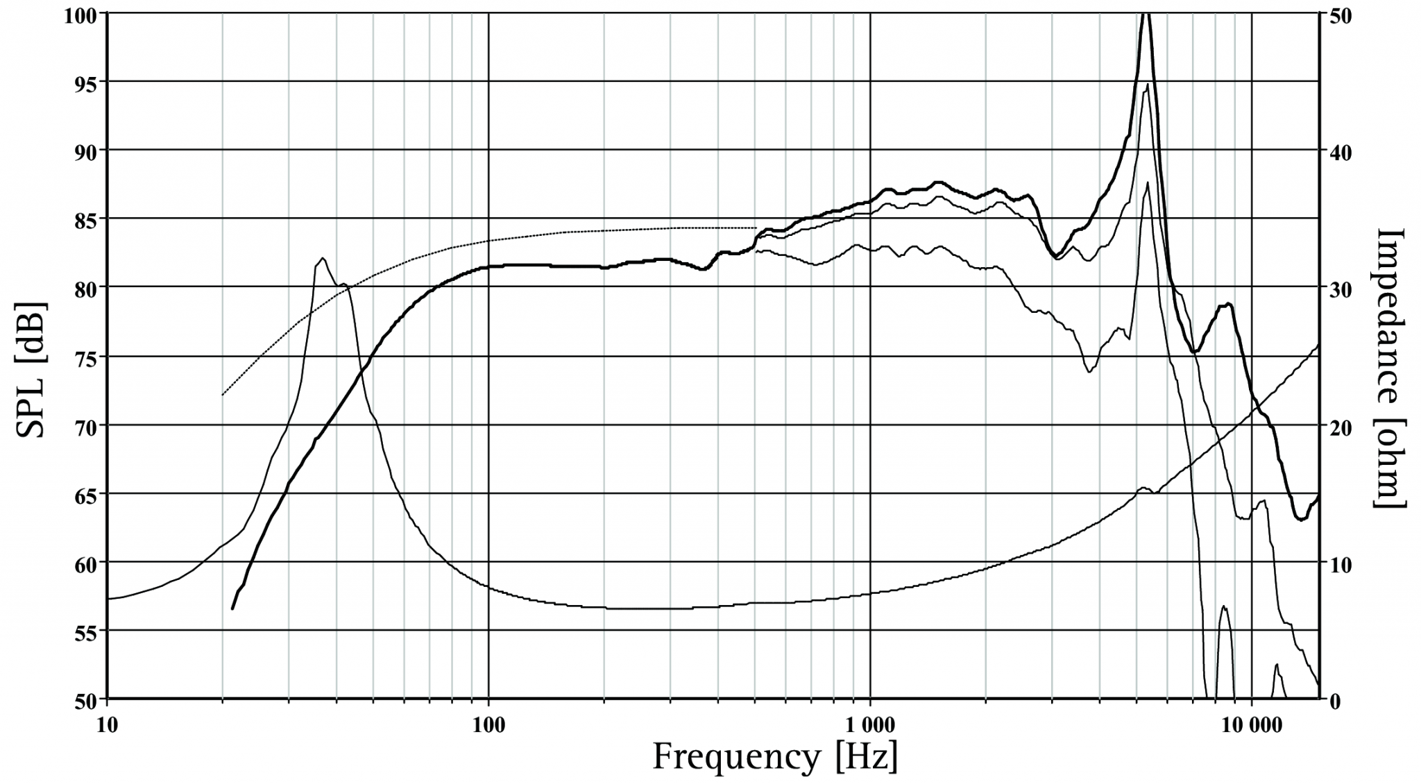

Meanwhile, I am hardening to the view that may be the SEAS H1480 with its lower sensitivity below 300Hz might be the best match to the MAOP 7.
https://www.madisoundspeakerstore.c...estige-l16rn-sl-h1480-5-aluminum-cone-woofer/

too small an anechoci chamber to test in?but almost ALL the SB drivers have this rather odd bump in their response curves (see below)

A quick look started at 25 litre /driver, tuned to 30 Hz (i would use a slot), gets into the low 20s F10, if you have significant room gain maybe even lower....suggest a box size that is closer to 1 cu. ft (25 litres).
dave
True but then I can only use 2 drivers in 50 litres. In which case I could consider an 8" woofer like the SEAS L22 (linked below) as it would move more air than a 6" woofer. The L22 has a QB3 alignment (at least according to WINISD and VituixCAD) of 25 Litres with a Fb of about 32Hz and an F3 of about 40HzA quick look started at 25 litre /driver, tuned to 30 Hz (i would use a slot), gets into the low 20s F10, if you have significant room gain maybe even lower.
dave
https://www.madisoundspeakerstore.c...stige-l22rn4x/p-h1208-8-aluminum-cone-woofer/
