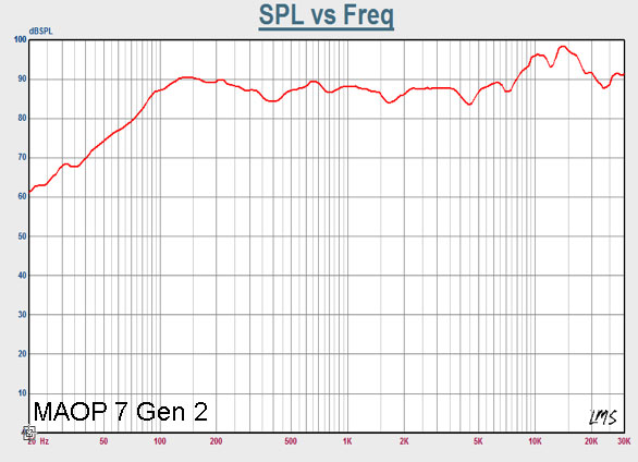

I used the instructions here to get a simulated response from an image of the frequency response and impedance curves published by Mark AudioAre these your own polar measurements or are they a Vituixcad simulation?
https://www.diyaudio.com/community/threads/vituixcad.307910/post-7027808
The frequency curve from Mark Audio also shows a big bump around 10kHz. This data is on-axis only and the off-axis data is simulated using VituixCad.FWIW, I owned a pair of MAOP7 for a couple years, I think it was, and in a couple of different enclosures never perceived anything approaching those graphs. To echo Allen’s query, when you say “tried”, does mean real world auditions, measurements, or simulations?
I understand I am using published data and not measured data but given the fact that I build a speaker only about once a decade, don't own these drivers and don't have the equipment or infrastructure to conduct frequency measurement tests (in open air or an anechoically dead room) the best I could do was used published data.
The off axis response should exhibit a lower peak than on axis. The on axis peak is there because the nature of a full ranger, is it beams at higher frequencies. If the on axis treble response was flat, the off axis treble would be very low.
Something is off with the simulation, in other words.
I thought the 3k dip looked a bit too perfect.
With regards to this higher frequency issue at least, you could do your own polar measurements.
Vituixcad might not correctly simulate the part you're interested in. Simulations become productive once you understand their limitations and strengths. You should have been informed of these.the off-axis data is simulated using VituixCad.

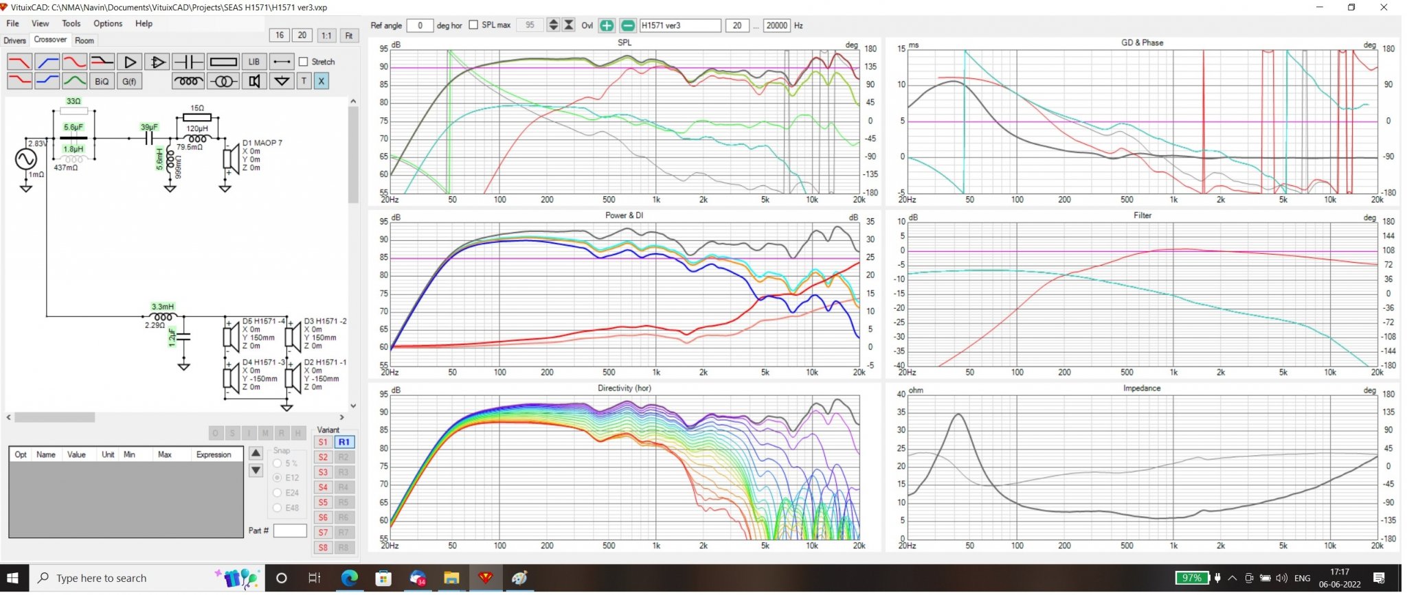

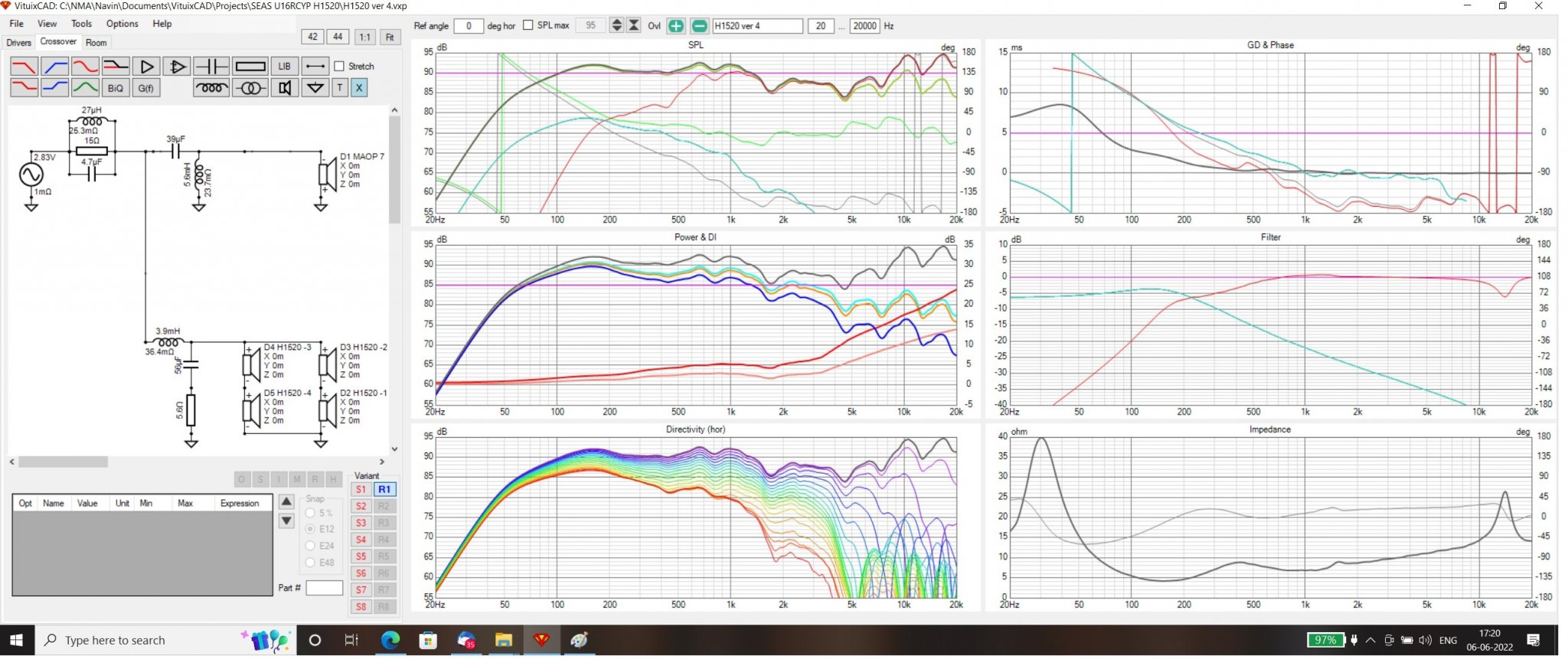

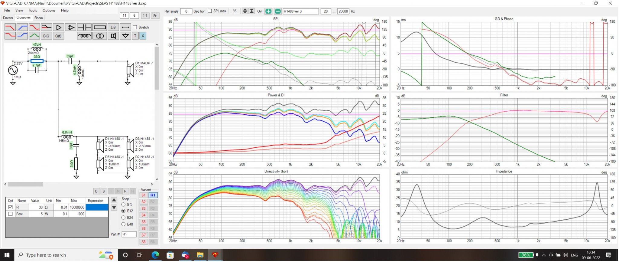

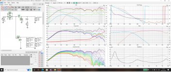

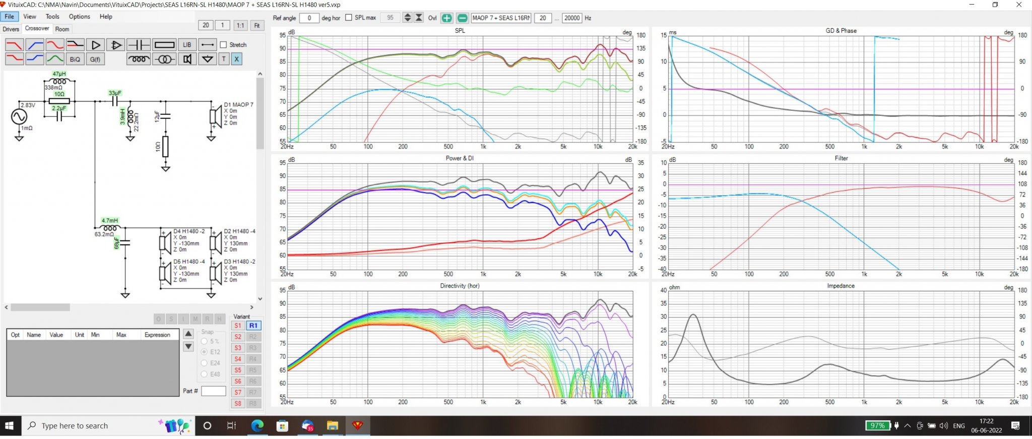

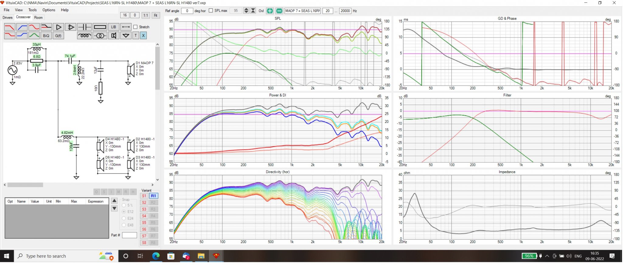

What would you reckon I did wrong? I did some more simulations and found that there are several woofers that might work well (or at least they will all work equally well) with the MAOP 7.

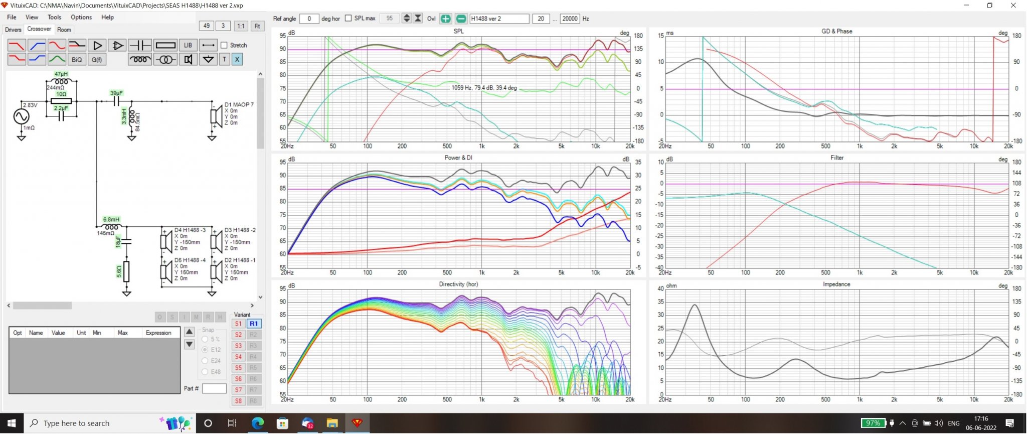

Do these look any better?
My object with VituixCAD was only to determine which woofers if any will work well (or if there are several which would be the best choice) with the MAOP 7.
I currently have 4 candidates. All of them cost around $100-120 each.
SEAS L16RNX (1488)
SEAS U18RNX (1571)
SEAS U16RCY/P (1520)
SEAS L16RN-SL (1480)
I found that rolling the woofers off less steeply would give a better response on paper because the woofer's midrange response would fill the dip in the MAOP 7 on-axis response. However, given that the woofers are on the side walls of the cabinet I don't really like crossing them over too high. No simulation is going to simulate "side-mounted" woofers.

Which woofers to use? I'm not sure I see how vituixcad could help you find an answer to that? More or less all woofers will behave similarly when crossed low. (not talking about the obvious things like sensitivity) Also, different woofers can be forced to have the same response.

Scan-Speak Discovery 22W/8534G00?
Thanks, Allen.Which woofers to use? I'm not sure I see how vituixcad could help you find an answer to that? More or less all woofers will behave similarly when crossed low. (not talking about the obvious things like sensitivity) Also, different woofers can be forced to have the same response.
Sensitivity (between F-10 and say 500Hz) was the primary concern since the design calls for 4 woofers to match with a single MAOP 7.
The other parameter was the response in an 11-12 litre bass reflex box (MLTL is an extrapolation/variation of a bass reflex box)for example from the drivers listed above the SEAS L16RN-SL H1480 (used by Linkwitz) prefers a box (QB3 alignment) that is about 25-28 litres.
The other question was how fast should these side-firing woofers roll-off? How high can we cross them and at what slope? Given that there are 4 of them flanking the full range (above and below and on both sides) would the sound emanating from them envelop the full range and how does this affect the response of the system. If we can cross them higher and gentler maybe the U18RNX/P H1520 and U16RCY/P H1571 might work better since they do not have any serious peaks in the upper-frequency response.

The closest I can come is something like this:
Not a huge difference between these 2 (and several others) which is what confuses me.

Navin, it is hard to screw this up as long as things look close. Low XO eliminates many issues you usually have to deal with.
