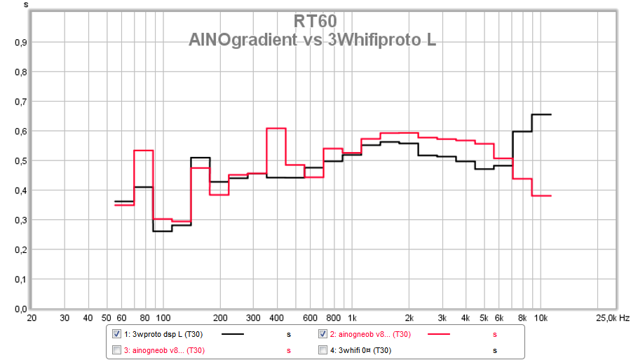

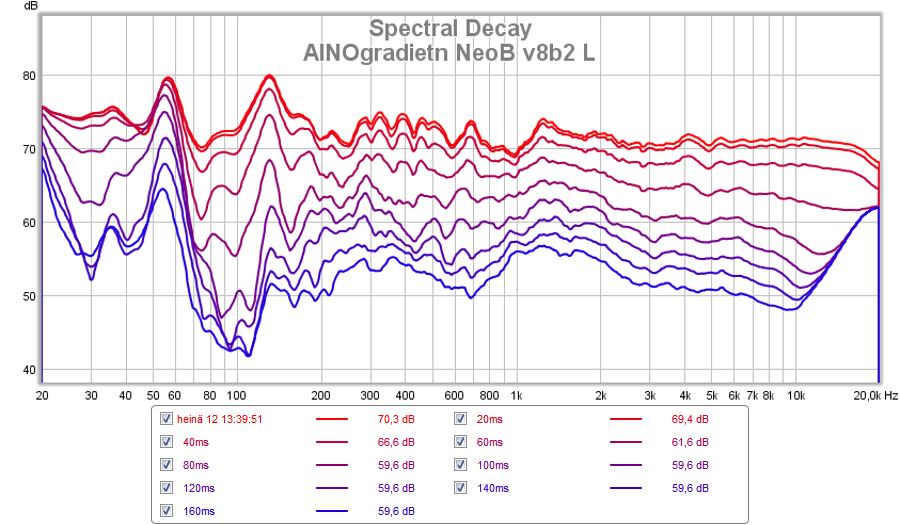

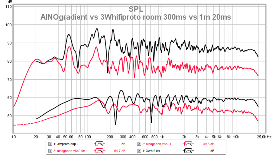

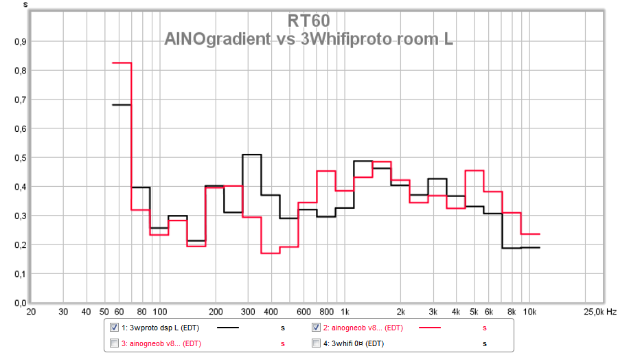

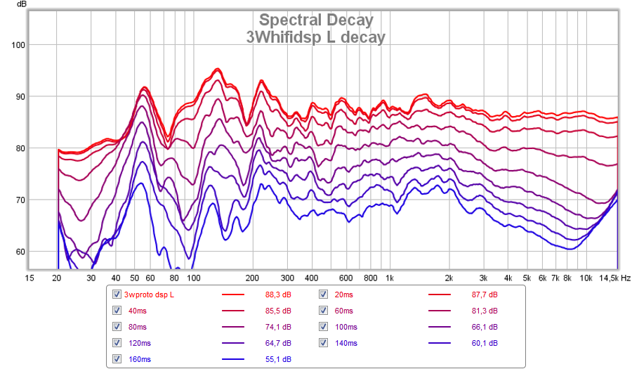

My AINOgradient diy-speakers are crossing monopole bass to dipole mid LR at 120Hz. My 3Whifi proto is just monopole 3-way, double 8" woofers.
I can see the proviously mentioned issues in these measurements clearly. The sound is not so different though. Same location 80cm to front wall, 2m to mic.
