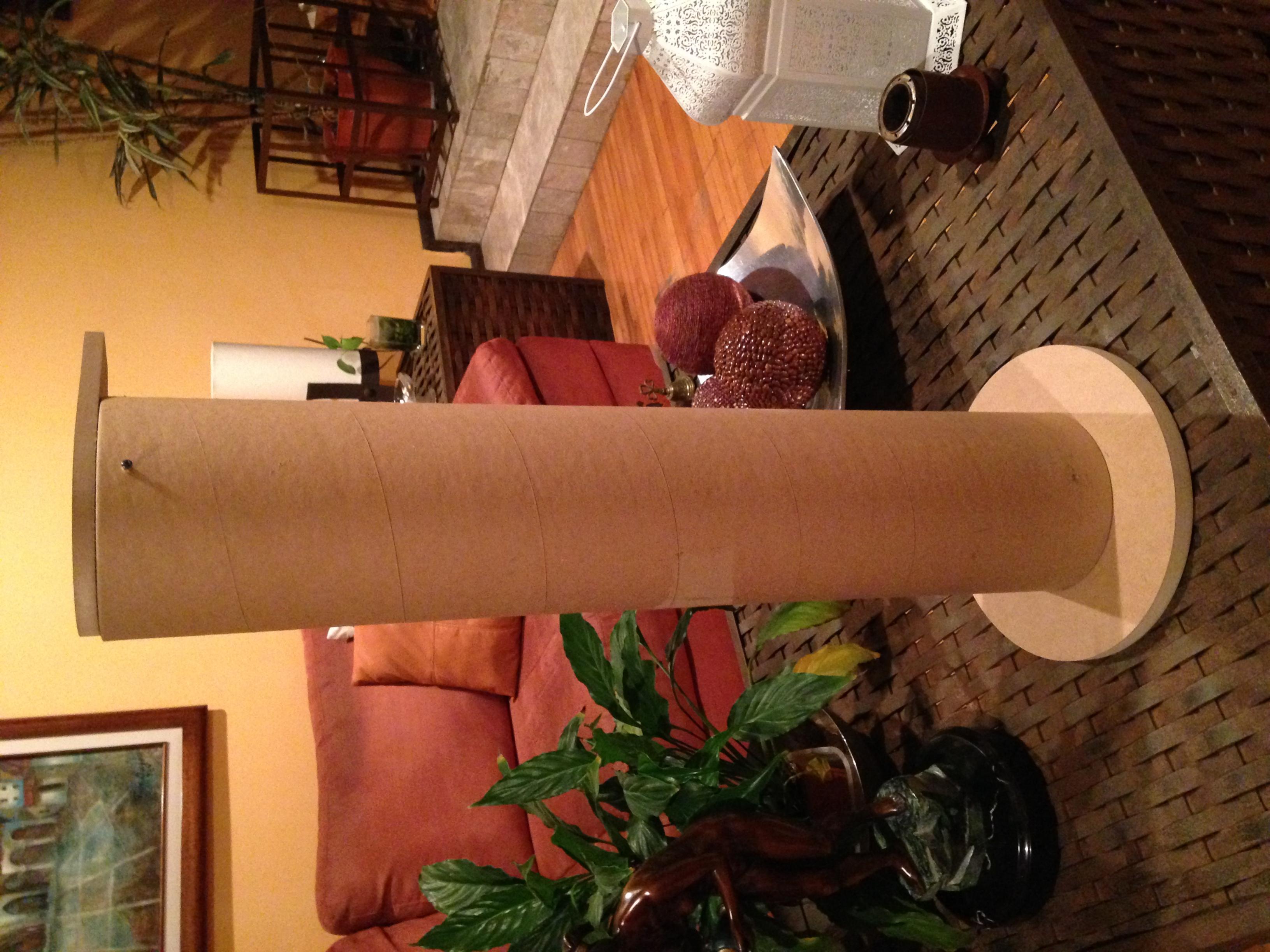

I don't like how the LXmini looks
Hi, as i said, i don't like how these speakers look. So I'm trying to make them a little different.
The original setup is inside the cardboard pipe.
Could this affect the sound?
I also plan on stuffing the space between the PVC and the cardboard with acoustic fiber. Thanks for your help.

I see no problem with that at all since you haven't increased the baffle size of the woofer driver. Personally, I would fill the space between PVC and cardboard with play-sand vice an acoustic filling.

Dave. Thanks for answering. I'll take your advice.
I think I'm going to love this ugly looking speakers.
