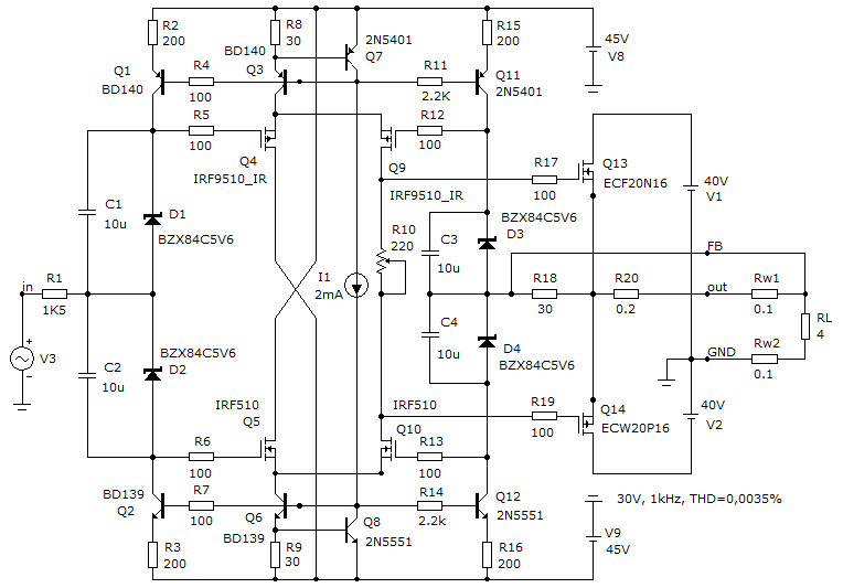

Scheme can be greatly simplified if we use the type transistors Lateral. Duple difkaskad FET input impedance stabilizes.
Using a third-wire and resistor R20 provides a small negative output resistance, which reduces the noise on the wires because Back EMF.

Here is the error correction output buffer
"Here is the error correction output buffer "
I would suggest 1N4148 type diodes in series with each of the zener diodes.
The zener diodes have a non-linear capacitance with the audio voltage. The added diodes will allow this capacitance to charge up, but not discharge into the gates during normal operation.
