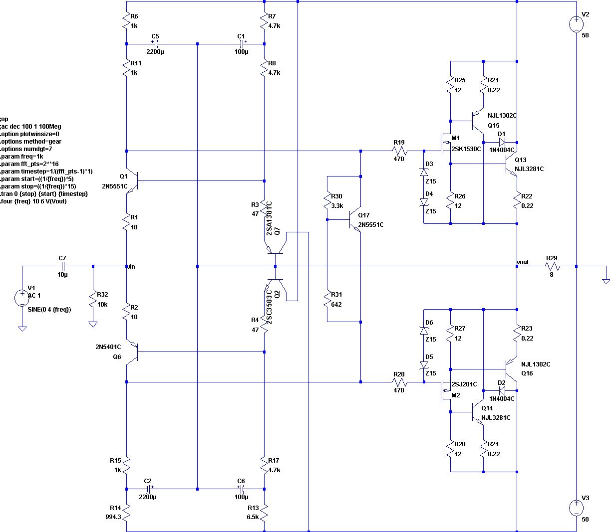

Still playing around
Ditched the CCSs to try bootstrapped resistive loading and it isn't too shabby. It definately isn't as touchy with getting offset in check. I think I'd like to play with the BIGBT some more, maybe just go stupid and try the BJTs in a CFP driven by a smaller MOSFET. Simmed distortion doesnt change much until just shy of clipping, about 3V off the rails.
The NJLs each have a thermally coupled diode, are you using those somewhere in the circuit?
No, I just used the models that best fit what I currently have on hand, which is some 2SC3281 and 2SA1302 I bought in the early nineties and never used. It wasn't my intention to confuse the issue showing specific devices.

I think I'd like to play with the BIGBT some more, ...
Way to go
I can not tell you how pleased I'm with them and how good these are in real world practice. Only that I prefer to use verticals (IRF610/9610) for drivers as they're faster and likes to drive more current. VAS stage, no matter which topology, driving BIGBTs breathes with full lungs at all times.
I remember the old philips BD to have <100mhz ft, am i correct? If not, apologizes.
Not correct, Typical ft at 30ma is 150Mhz. The most important factor is the 30ma, which is where a typical driver is biased at. At this current toshibas manage around 70Mhz and onsemi a dismall 20 to 30 Mhz.

Clearly I do not understand things the same way as you, homemodder. Rather, what I understand is that there is more to BJT performance than mere Ft. Gain flatness over the current range actually used is more important and does not require that this be coincident with the maximum Ft point of the device. In this view, I am joined by name designers whom I respect.
Lazycat, I finally took a closer look at your discrete IGBT circuit and understand why you like it. If you took out the diode between the BJT collectors, you have a formof Bryston Quad-complimentary output stage in effect, with a mosfet driver instead of BJTs, and without voltage gain. The combination of an emitter and a collector working the load for each signal half has a profound effect on the distortion spectrum, generally making it more balanced and benign.

Jkuetemann, the mosfets in your sim are now obsolete according to Toshiba. However, the K1058-J162 may still be current. They are all close enough to each other in performance to be swappable for the circuit. It is disconcerting to see these obsoletions occur, especially when you have these parts in your inventory; should you use them? keep some as spares?
Fortunately with the plastic packages, the mosfet and BJT pinouts are compatible. So, if you lay out a board for the LU buffer, you can use either technology. Just make a provision for the extra drive or predrive stages, and for gate zeners and balancing caps. Then, if the original mosfets die and cannot be replaced, BJTs can be subbed, or vice versa.
