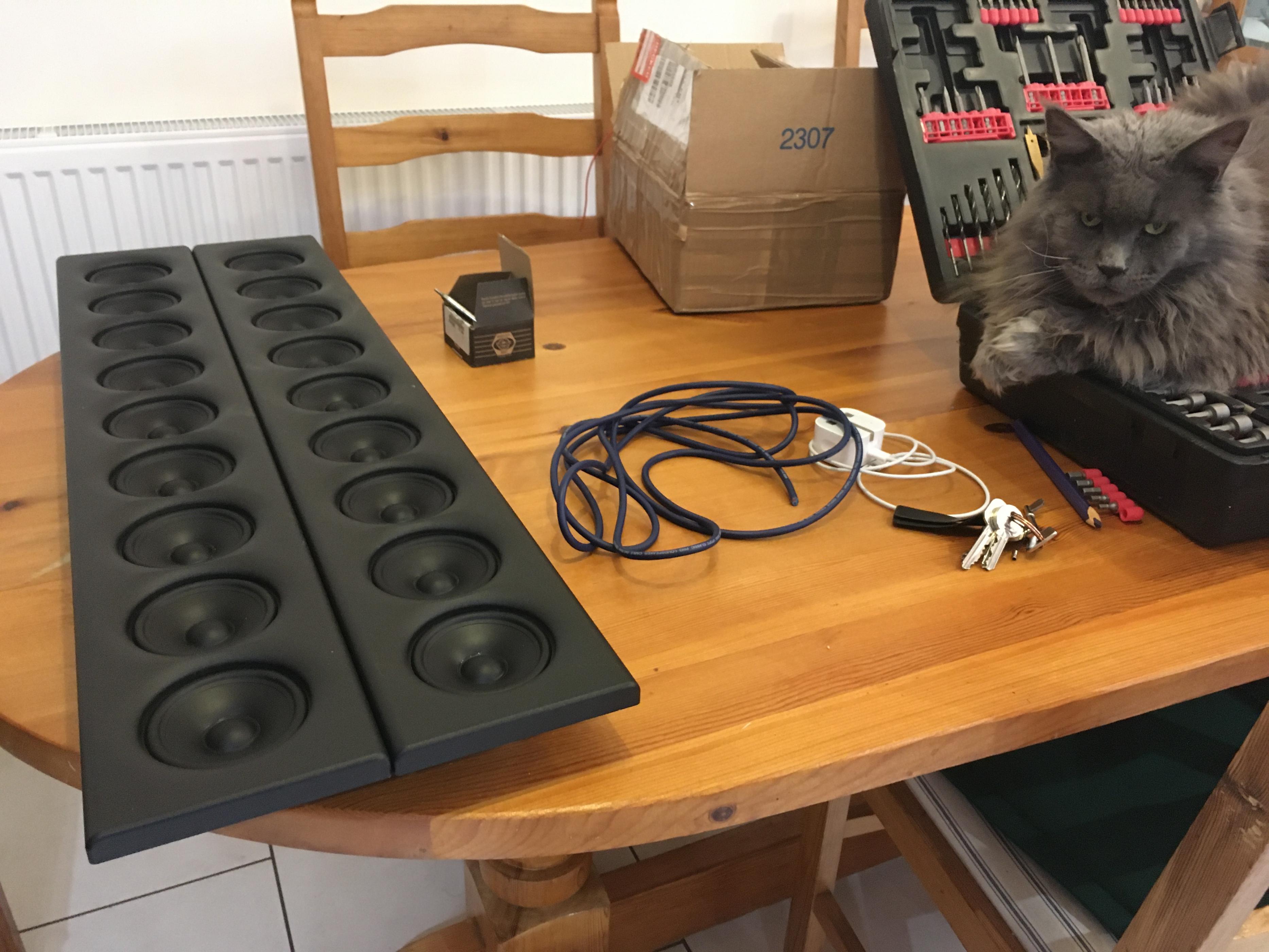

New Line Array - 16 x TC9FD18

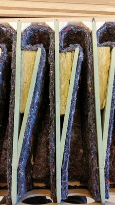

Cool rear chamber. Sort of a folded Dagger! I wonder if that extra length lets it reach deeper?

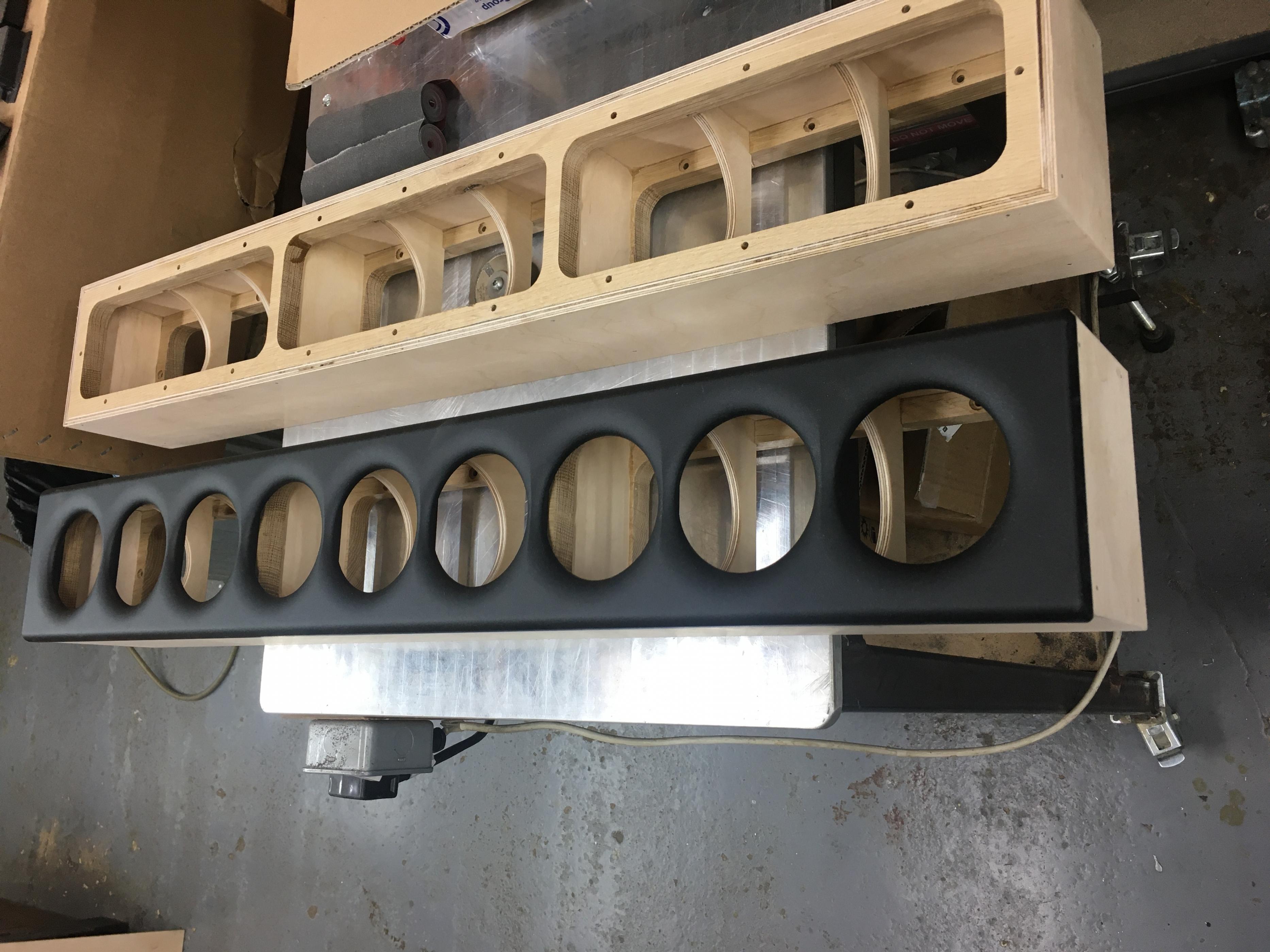

813441d1580595802-line-array-16-tc9fd18-loudspeaker-columns-jpg
Those problems will be much worse using a smaller line of drivers if you were to only use one of your 16 driver arrays. 75% floor to ceiling coverage plus is where an array becomes most like the theoretical infinite array.
Awesome finish on the baffle 🙂
Some Fibreglass felt and wires and you will be away.
Fingers crossed.
Anyone had experience with the likes of rubber crumb on the insides of cabs as opposed to wool.
Research suggests density.
etm(R) Shock & Sound Absorbent, Anti-Vibration Mat - 60x60cm (5mm) - for Washing Machines, Sound Systems and Appliances: Amazon.co.uk: DIY & Tools
I could shoot open cell polyurethane foam to any density if required here too. Hope to have completed speaker pics tomorrow.
I used relatively low density fibreglass with the same sort of felt as seen in that last picture, auto parts stores sell it. Added mass such as 3mm rubber flooring sheet or the isomat type of stuff that wesayso uses is a good idea. That stuff you linked is probably heavy but will eat an amount of space inside your cab, stuffing with fibreglass will increase the apparent size.
