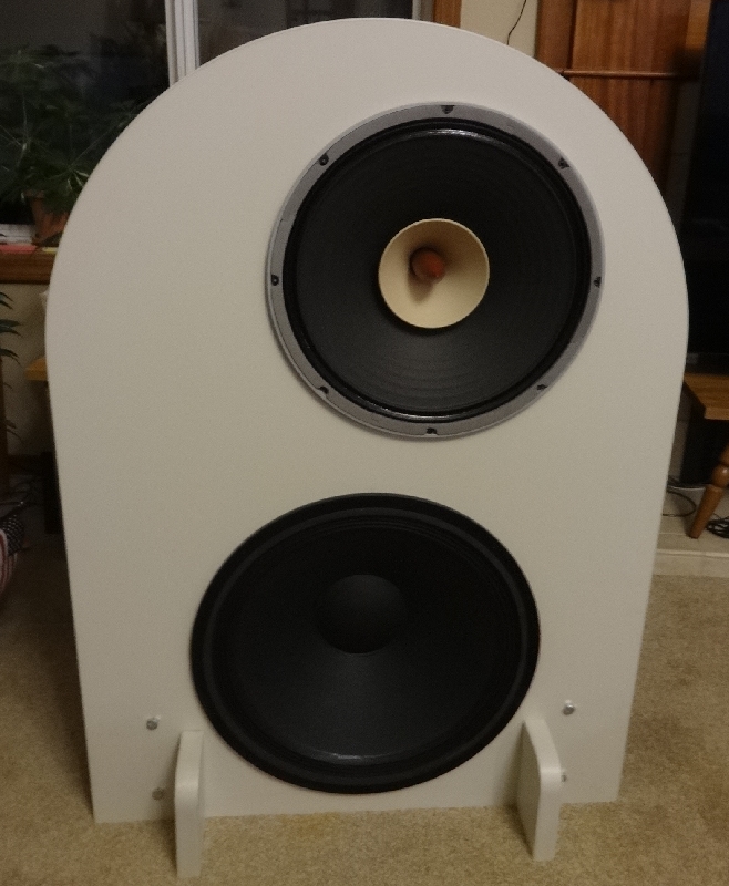

I originally ran them as a single driver where they could go down to about 50-60 hz. Not content with that, I added the 18s. I ultimately crossed them at around 100Hz, to reduce any potential cone motion based IM in the F15s.
If you look on the Lii website, I believe they came up with a 12" version also, that's designed to go deeper, by using a more complaint suspension. Unsure where the reviews stand on that unit, as I've never read one.
Accommodating the "helper" woofer is more of a pain than simply running a driver FR, but the rewards of listening afterward is worth it. Bass pretty darn close to the standup being right there in the room.
Sure wish I could have my 22 year old ears, to hear what these really sound like... Thank God I can still hear and appreciate coherence. That's why I hang out in the FR forum. Supertweeter? Might as well put a resistor there for my ears.
Dadbeh - Loving those OB's. Are those mounted in glass or plexi? Also, why the added wood if it is not needed for mounting the speakers in? It looks nice, but I suspect that the completely clear might have a higher WAF (Wife Acceptance Factor). What are you using for the woofer? Emminence 15 A's and B's seem to be pretty popular. Did you try the F15's without the woofer and if so, can you share your before and after listening impressions?

its plexi that i had cut with water jet. yes having all the front with plexi would have a higher WAF but the i just wanted that slammin' bass. a design like this with two woofers that are run with external crossover and its own amp is so flexible in the sense that you cant say it is "warm", it is "bright", it is full range etc. you can make it whatever you want. I can make it bass heavy or bass light or i can take the woofers out and make the F-15s full range from my phone because i control the crossover with an app from my phone. I can increase the gain slightly for the F-15 and the speaker becomes "bright". basically the balance that a speaker designer sets up in its design phase for its speaker, i play with it all the time.
now i have the F-15 on caintuck baffles and for bass i use two jbl 15 inch woofer in box. its not really a subwoofer, its two vintage speakers that I have repurposed and crossed over under 100hz.
in my judgement F-15 needs bass augmentation but no tweeter.

I made these from conference room table stock I sourced from a Washington State Government recycling agency. I recognized the "tombstone" shape when I saw them for sale. I used "the edge" to find the offset placement for the F15, as I've read that "centered" isnt the best arrangement.
I've never tried a square baffle!

I know the question wasnt directed to me, however thinking it through, if the F15 (from my experience on an OB) does ~60-70 hz, I'd say yeah, it lacks the lowest bottom.
You'd need something in addition to cover an octave below that; 30 - 35Hz and upward to meet the F15.
And if the baffle is less substantial or smaller than yours, Which is the case for my f-15, then the need for lower frequency augmentation is more and more substantial. your baffle is already pretty wide and tall and extends to the ground which is the best case scenario, if you then measured to going to 60-70 then rest assured a miniature baffle like the one on my picture above will start to fret around 120Hz
F-15 doesn't sound thin or anemic, in fact I couldn't get it to sound bad no matter how bad and inadequate the baffle was. But the need for lower frequency augmentation is just a fact of of single driver design
