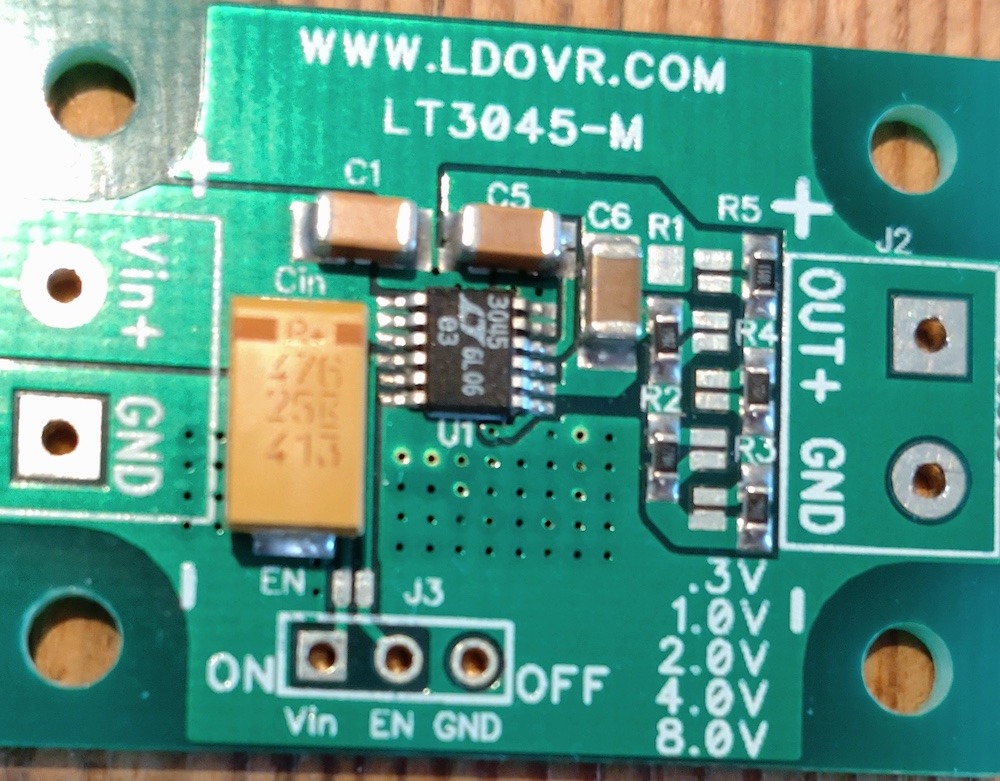

As ldovr wont answer my support request mails - I'll try here...
I have pair of ldovr boards LT3045-M that I would like to strap, one for 5v and one for 3,3v.
There is no instruction available and only the print on the board... what do you make out of it..
Straps positions on board in 2 vertical rows:
____ R5
R1
____ R4
R2
____ R3
then a list of voltages:
0.3
1
2
4
8V
How do you reckon the 2 list relate?
is it (a):
R5 - 0,3
R1 - 1
R4 - 2
R2 - 4
R3 - 8V
or (b)
R1 - 0,3
R2 - 1
R3 - 2
R4 - 4
R5 - 8V
or other arrangement?
My particular board in the picture - is that for 15,3V?
I suppose the R1-R5 are 0 (zero) ohm resistors - is this correct?
For 5 volt, should only resistor R2 and R4 be present and the others removed??
Help!!
OK - found some instructions... but it does not really help as "from TOP" is unclear...
Is R5 = the top in "from TOP" and next is R1? (Why is top written like "TOP"? strange...)
Vout = sum of open pins... OK!
So I would like 1v and 4v too be open so I take away R1 and R2?
This could have been so easy...
